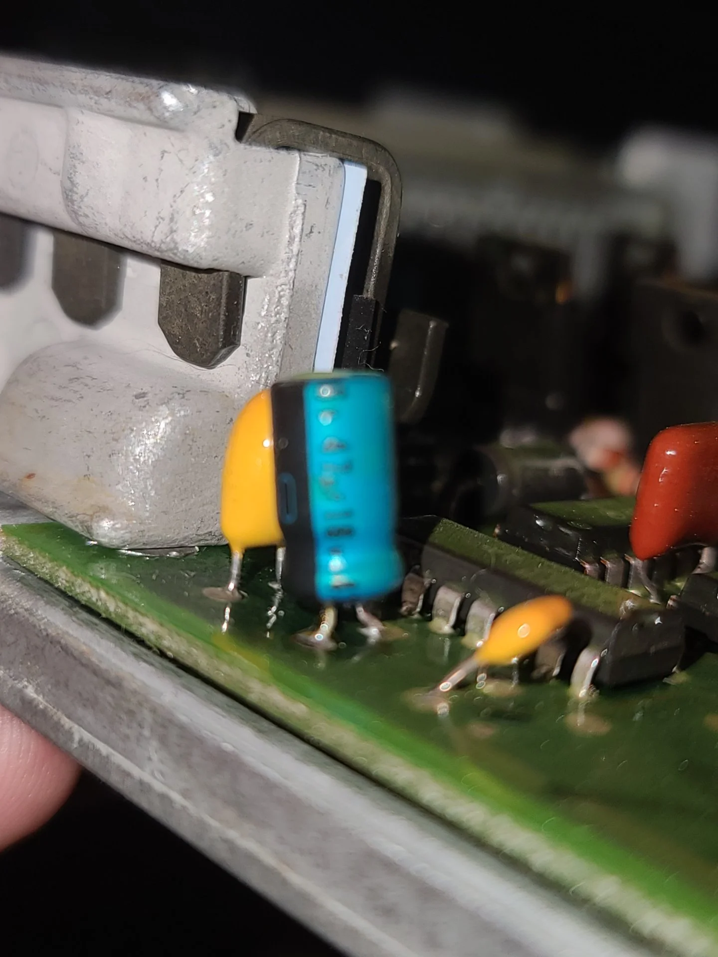

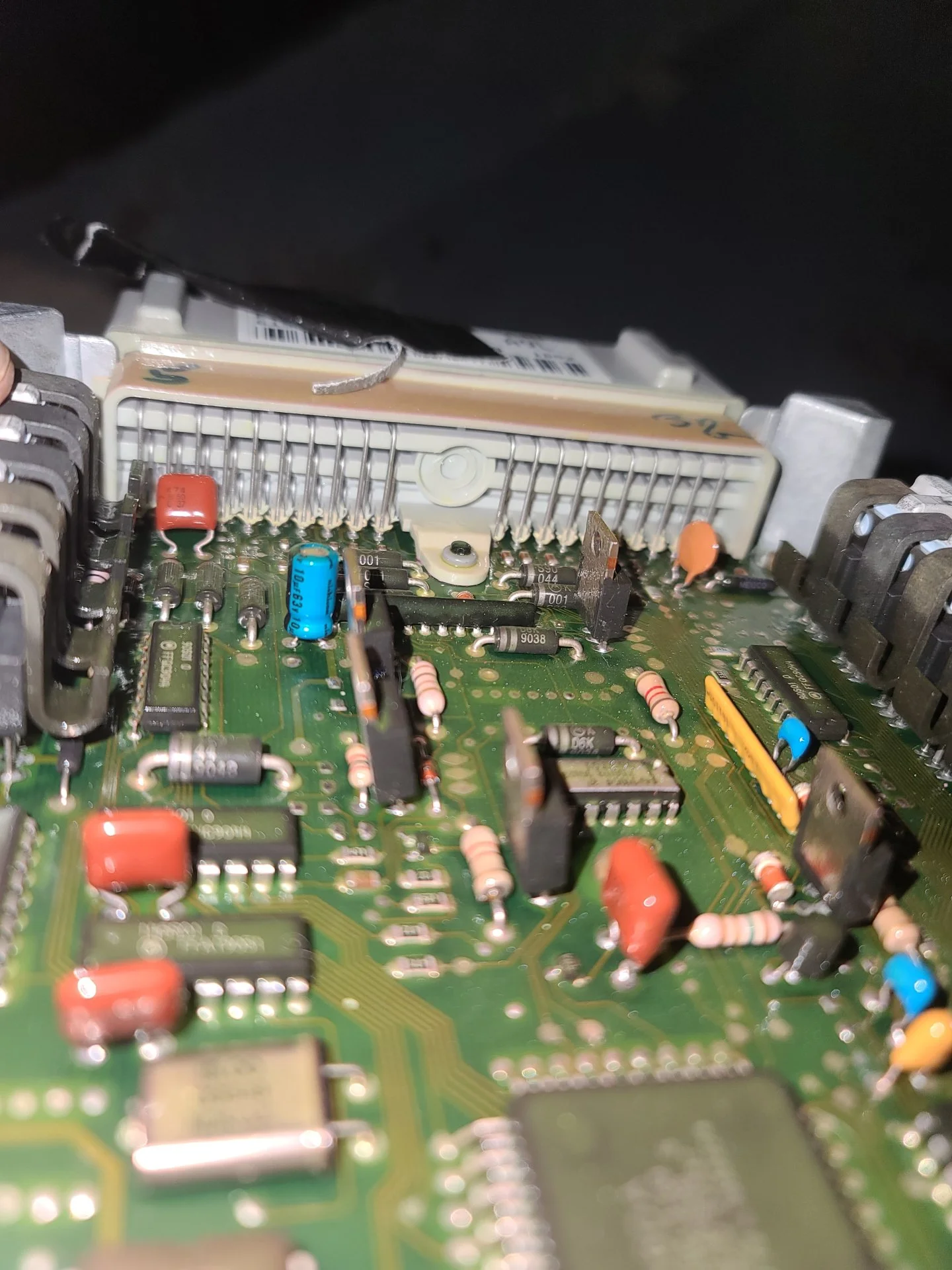

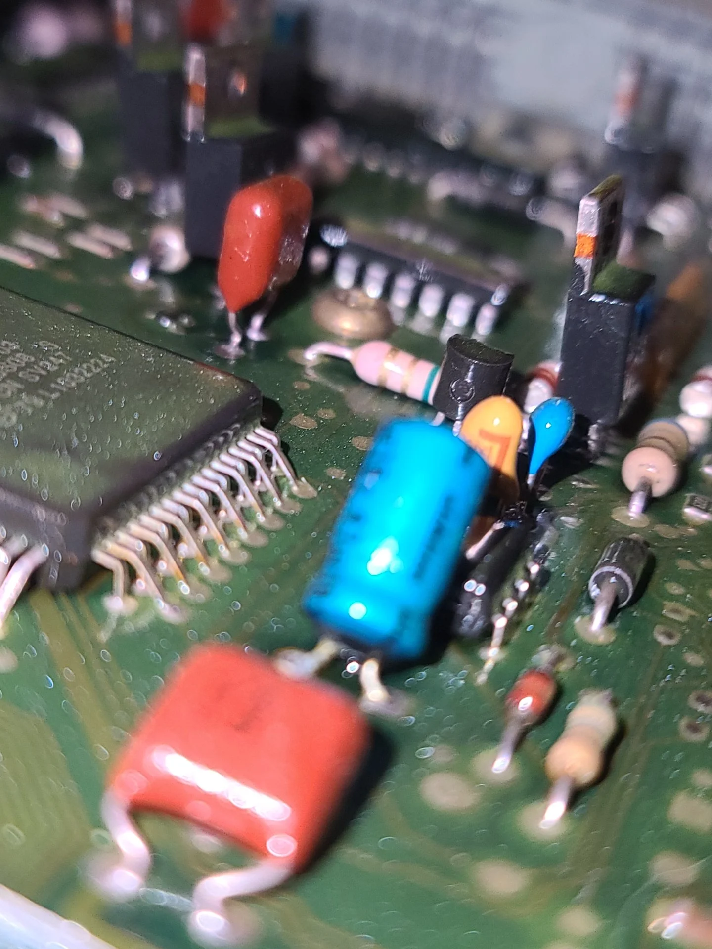

Yeh you could open your computer and check the little blue barrels
Thus has to be the most mint 31 year old ecu I have ever seen . All the caps are mint and clean .
