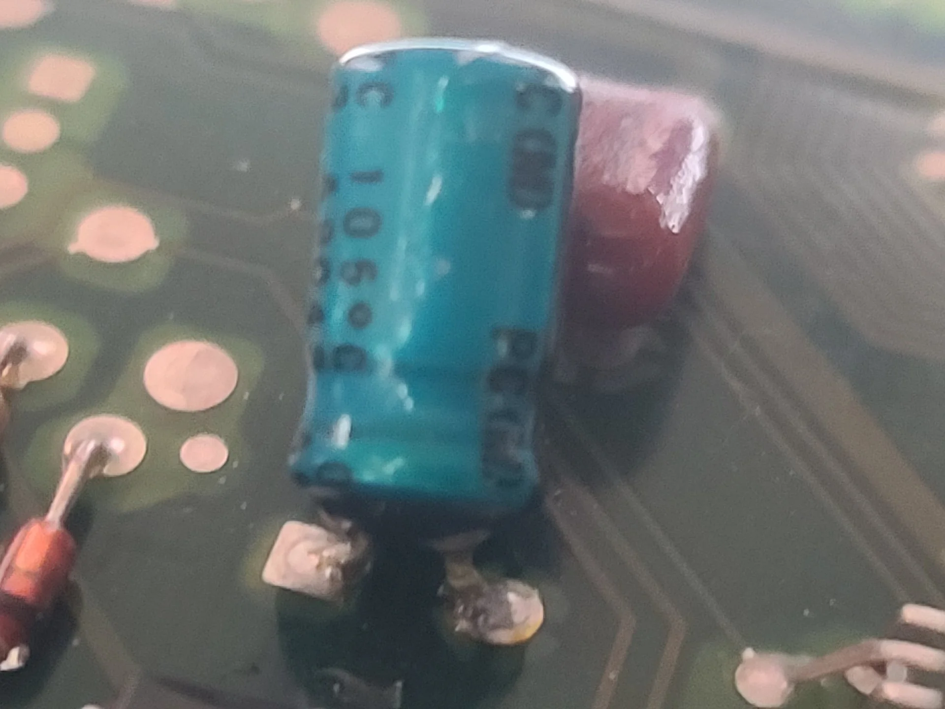

Looks like I might have a bad capacitor leaking a bit see the pic

Yes, that’s a leaking capacitor. The fluid inside is corrosive so it corrodes the legs until one side breaks loose.
It’s a 10 cent easy fix if you can solder.
Otherwise ECU exchange is $140ish.

OK I've also noticed when I turn the key to on position the check engine never lights up and did that for awhile....but it never lost power or anything it runs like a wet dream on 94 octain that's all I ever give her to drink.i run a Bama chip so she's tuned for 94 octain too.

The CEL is controlled by one of the transistors on the board. When the caps are bad, the operation of the transistors can be affects. Could be a sign of a bad ECU.
Or a burned out bulb

Just a quick update my ecu is repaired and on its way back to me from EcuExchange here is what they said..
SPECIFIC AREAS TO CHECK PRIOR TO REINSTALLATION : NONE, YOU ARE SAFE TO PLUG IN AND START AS NORMAL UPON RETURN.
The repair details below are generalized, if your computer has any short circuits or we suspect any wiring should be checked before reinstallation we will put specific details above.
Your computer will return ship ASAP, we do clean and seal the board for moisture intrusion as well as clean the outside.
The power supply in your computer was defective due to age, causing distortion on the system voltages. We replaced the power supply along with the capacitors and voltage regulators. which are common to fail and this will prevent future defects.
We also Replaced a couple other circuits which are known to fail while we were in there to prevent future failures.
If you have any questions, please feel free to ask. We're always happy to help.
