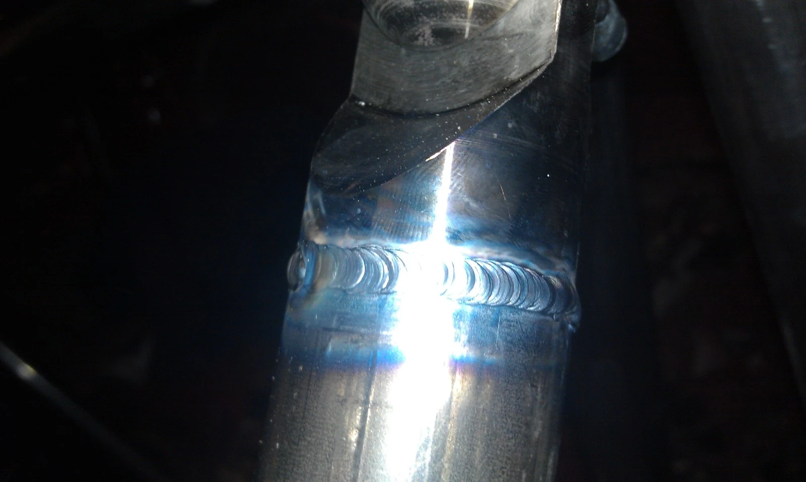

Here is one of the better examples that I have of decent weld quality for some of the stuff I have done.
