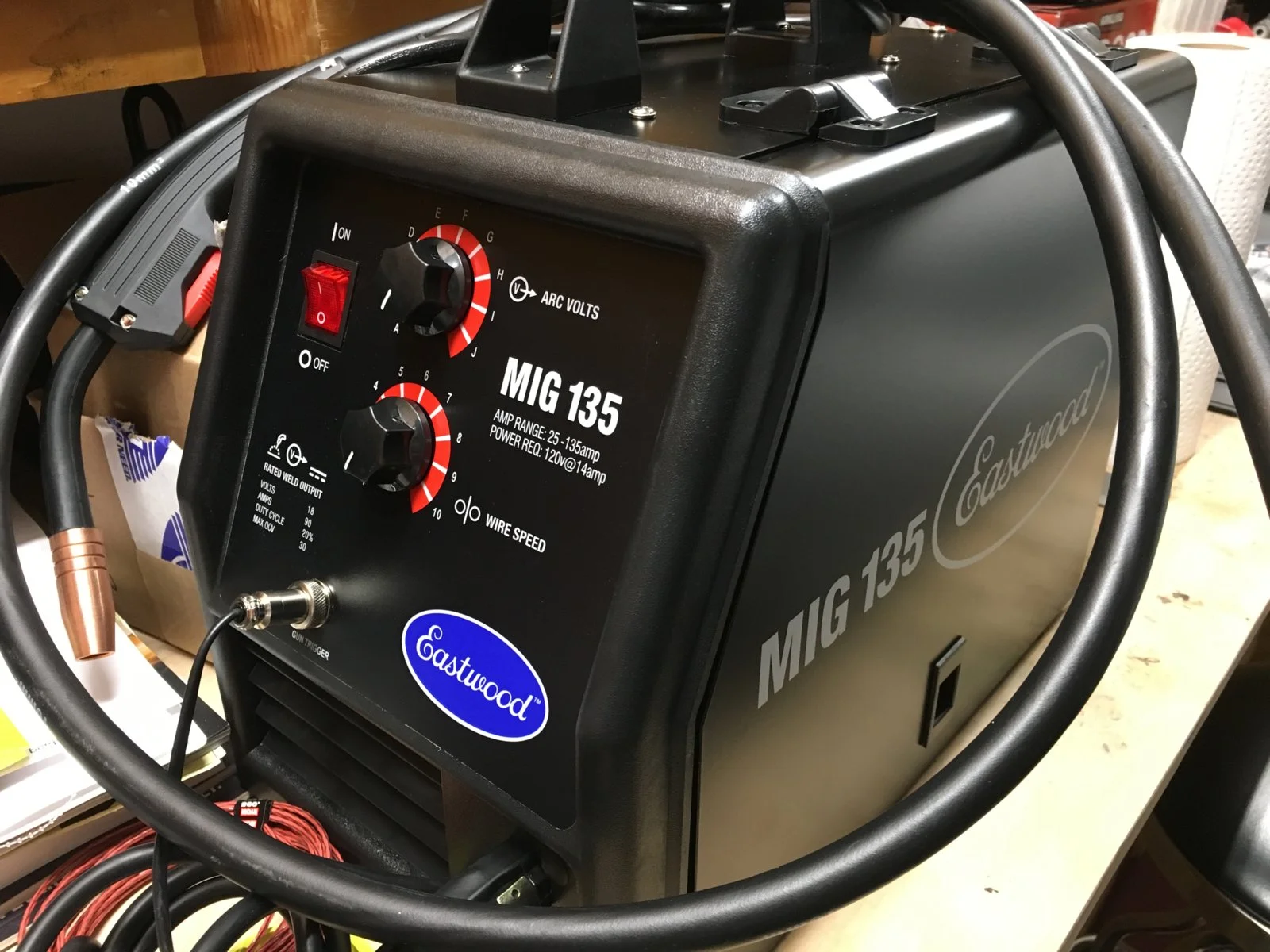

I just spent the day on Friday running a new 20amp circuit in my garage. I was tired of dragging the retractable cord all over, and now I have outlets where I need them for my welder once I pull the trigger. I really think I’ve come full circle and am going to go with the Eastwood Mig 135. I can get the welder for $350 delivered (using the $20 off code) a Harbor Freight cart, and an ok helmet for around $500. I have a bunch of scrap I’ll practice on, and get the feel for the machine with the flux core before I buy a bottle.

I’ve been looking at welders for a while. I’m getting more and more leary of the Chinese copies (Eastwood mig 135).

Welder is here! I thought it came with flux core wire, but it came with a roll of solid mig. My plan was to practice with flux core, but since it came with MIG wire, I may just get a bottle of gas and go from there. There’s an Airgas store about 5 minutes from me, so why not!

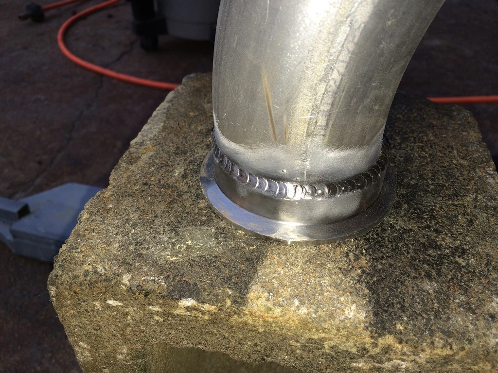

TIG welding is an art. It takes several hours to become barely capable, and several hours more to become proficient. Even longer to make the kind if beautiful consistent welds you see pics of. Mig welding requires a little practice to get things right, and a steady hand. I'd dare say that I could show you how to weld decent in an hour of practice going from 1/4" plate to .20 ga steel with a mig and still have a beautiful weld.
This is a triggered " pulse" weld using a mig. You can see the tiny little pinhole in the middle of each bead. I pulled the trigger Everytime you see the dime.
Reactions: RaggedGT
Thanks, Mike. Is that from the Cyclone? I'm only on page 44, so if you re-renamed since that point, I haven't reached it.

It is.
It's the bend that used to be attached to the center exit rear exhaust. ( you can see it laying on the ground)
