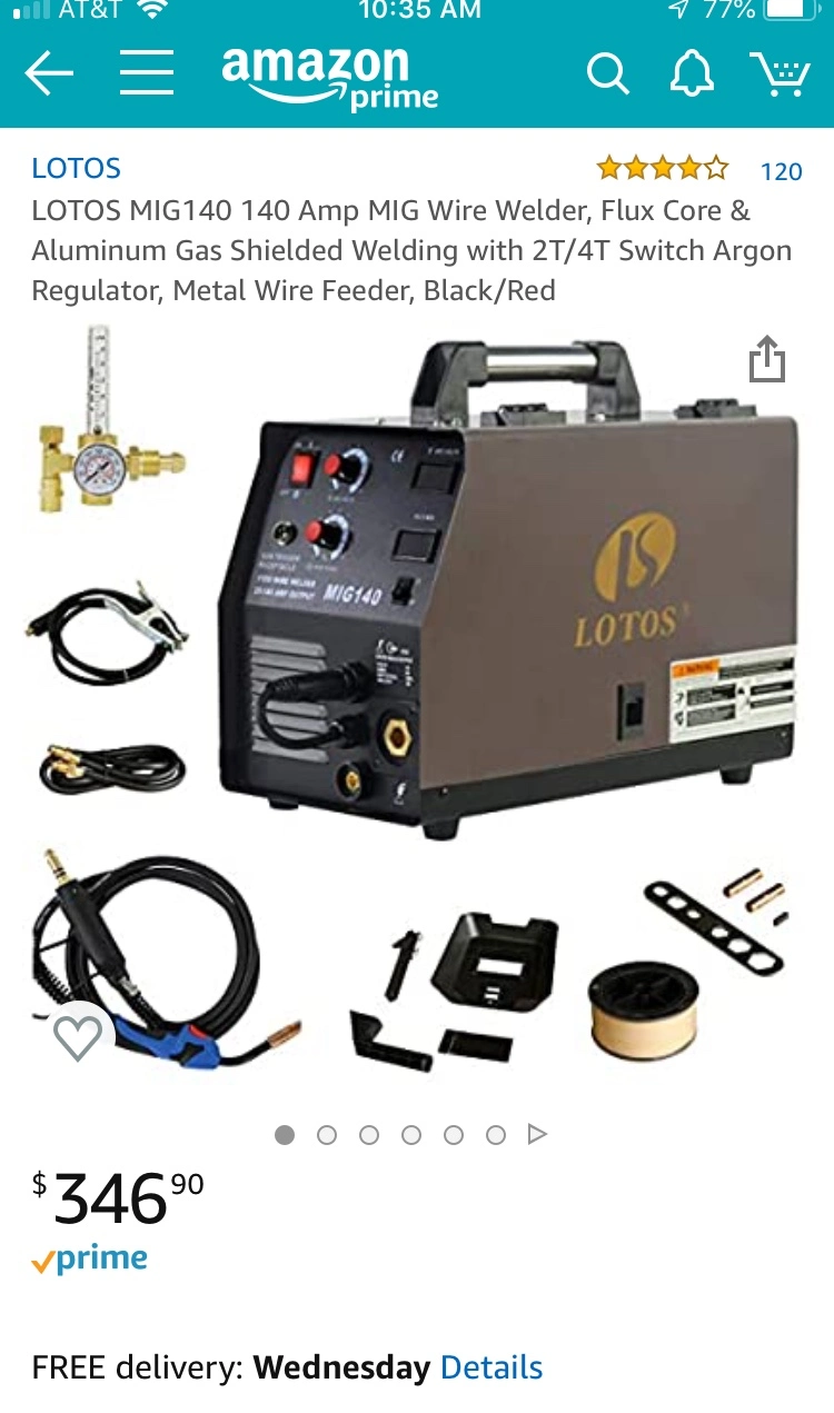

) so dual voltage might not be necessary.I have the Lotos...works like its sposed to no problems after several years.Thoughts on this welder anyone? Amazon product ASIN B071RN46PHView: https://www.amazon.com/dp/B071RN46PH/?coliid=I2KEQJMODNN4SK&colid=3HXKO2B414SJJ&psc=0&ref_=lv_ov_lig_dp_it
The other option is the weldpro or lotos.
Amazon product ASIN B072S5J17XView: https://www.amazon.com/Inverter-Multi-Process-Welder-Dual-Voltage/dp/B072S5J17X/ref=sr_1_2_sspa?keywords=weldpro&qid=1558401918&s=industrial&sr=1-2-spons&psc=1
Amazon product ASIN B00QMXEIMKView: https://www.amazon.com/MIG175-Aluminum-Welding-Regulator-Standard/dp/B00QMXEIMK/ref=sr_1_3?keywords=lotos+welder&qid=1558401697&s=industrial&sr=1-3#customerReviews
I'm planning on running a 220V circuit (breaker panel has 5 slots left) so dual voltage might not be necessary.
to the flux core, unless you are welding outside where a breeze effects the gas.It's worked for me. I have the next one up from there. The freaking thing had major shipping damage when it arrived ( looked like it had fallen from 6 feet.) The whole case was deformed when the heavy ass power supply had tried to go through the bottom of the case floor. I called Lotos, and told them that I was gonna try and fix it, but to be advised that had happened. I took the thing apart, beat the hell out of it to get it back straight again. Put it back together, and turned it on. It has been working since.So your saying something like this would probably get the job done for me.
