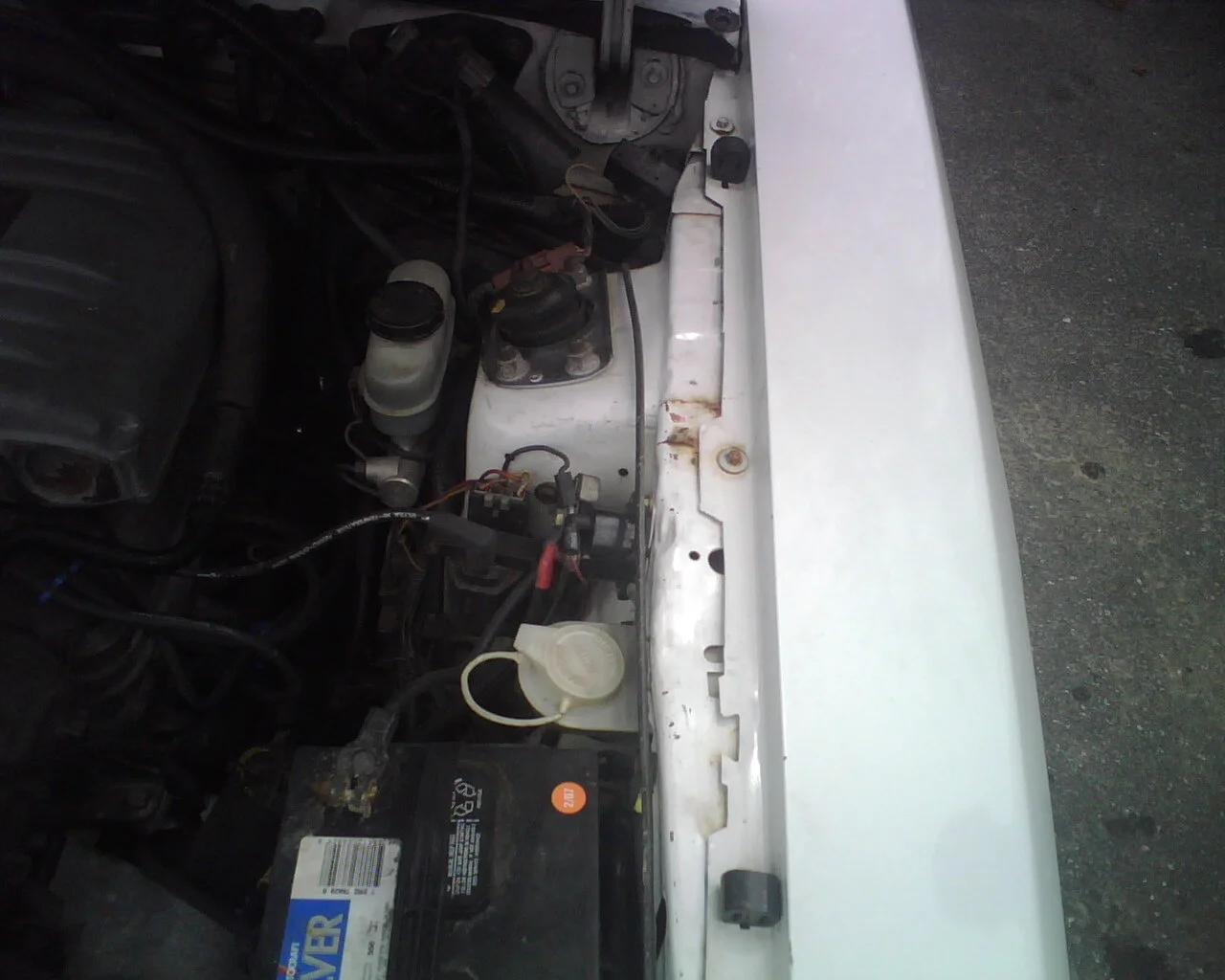

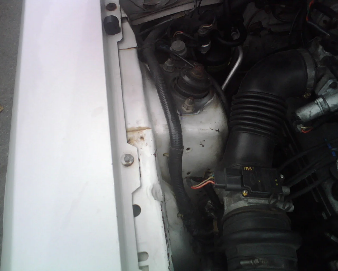

Its alright needs to be restored new paint etc. The interior has tweed seat the dash and console need restored. The car needs some tlc its more of a 50/50 it looks good until you get close. Some trim on the outside etc. It has a clean car fax but, it has splits on both sides of the fender aprons. I took pics of it and think that it had a front end collision.

Cant you run a Carfax thingy on it and see?
Carfax won't always show everything, especially if the PO never reported an accident and fixed the damage themselves. The Carfax on both my '89 and '84 showed no history of accidents, but both of them have beat-up and tweaked radiator supports; the '84 looks like someone ran it into a ditch at some point, and the '89 looks like it actually had a full collision of some kind that was repaired with a new bumper and/or fender(s), but the front-end frame is still slightly tweaked enough that the gap between the fenders and the hood on the left and right sides aren't straight or even no matter which way you adjust the hood (looks like it's tweaked slightly toward the passenger's side).

look at the framerail near the airbox, if it looks tweaked, then the cars probly been hit.
how much is the car? look pretty nice from those pics. and its hard to find a nice notchback these days.
the notch is 5900 obo. The car in those pics seems to have a split in the fender aprons which I'm pretty sure are one piece from the factory. The pictures are deceiving its not as clean as it looks it needs work? It needs new carpet,paint,bodywork, quarter windows, heater core, etc.
