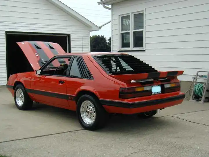

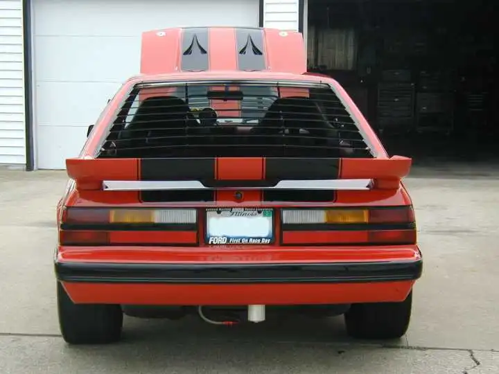

Hi Fishhawk....Nice to meet ya in Mendota at the cruise! For 275-50-15 drag radials, you'll have to take the quads off. With the Uppers and lowers that you have, that shouldn't be a problem. You can use a 15x8 drag lite with 5.5" of backspacing, but may have to massage the inner fender well just a little. We're talking maybe a quarter inch here. If the car is lowered, maybe a little more. Here's a couple of pics.
LOL ...... Now I remember you're car. You're car definitly sits a lot higher then mine. I'm wondering if I used a 1/4" spacer that I would minimize the amount of inner fender pounding I would have to do, yet still allow for outter fender clearance. (Maybe a little fender rolling)
