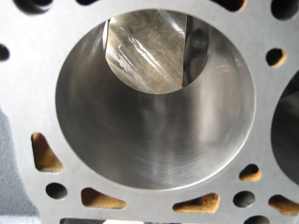

Tighter than a virgins ass, lol.
indeed, I'm starting to think that this was either a brand new block or a brand new shortblock from Ford

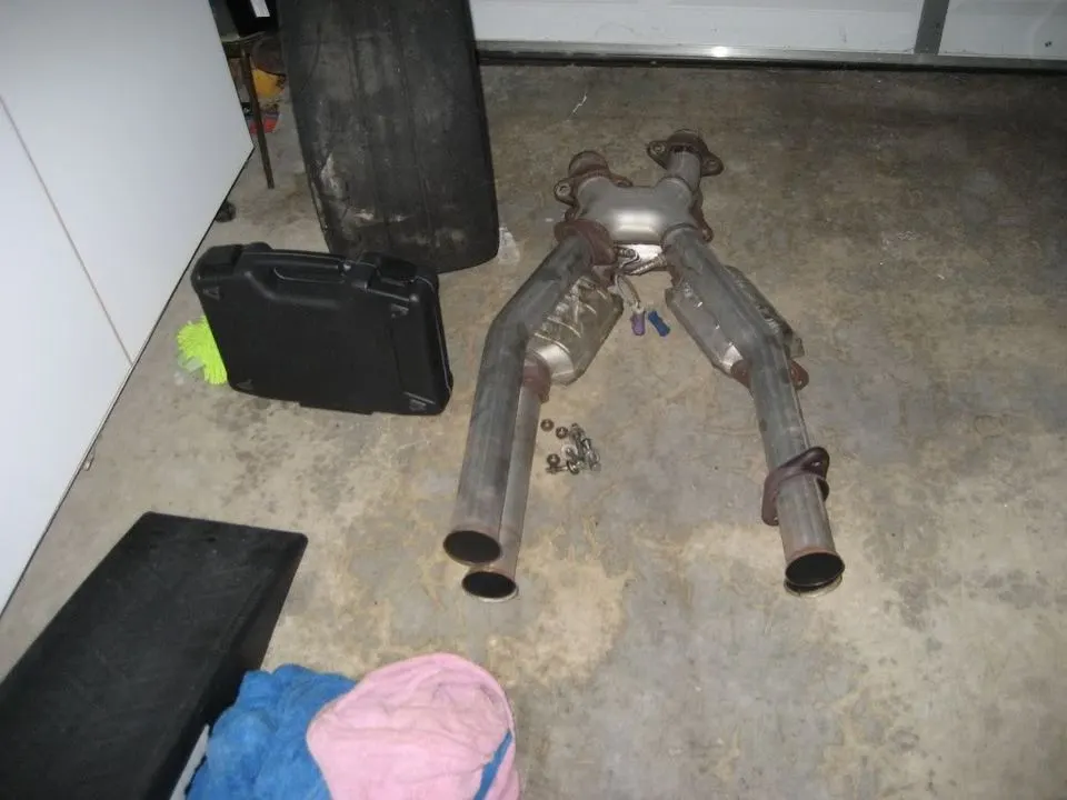

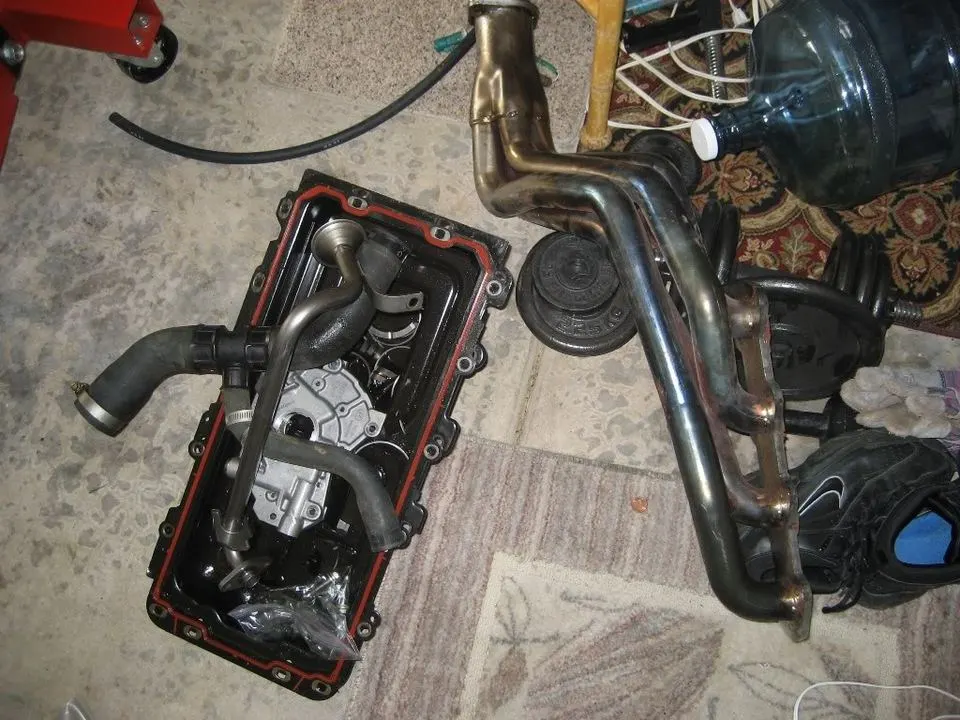

I spent some quality time under the GT today, tackling the X-pipe that was rusted and draining the transmission. Thank god for full-length subframes
Damn X-pipe
My FRPP head-changing kit came in. I'm using this stuff to put the current heads and cams on the built shortblock until I can finish rebuilding my spare set of heads.
ARP Main Studs arrived as well
Tomorrow, I tackle the driveshaft

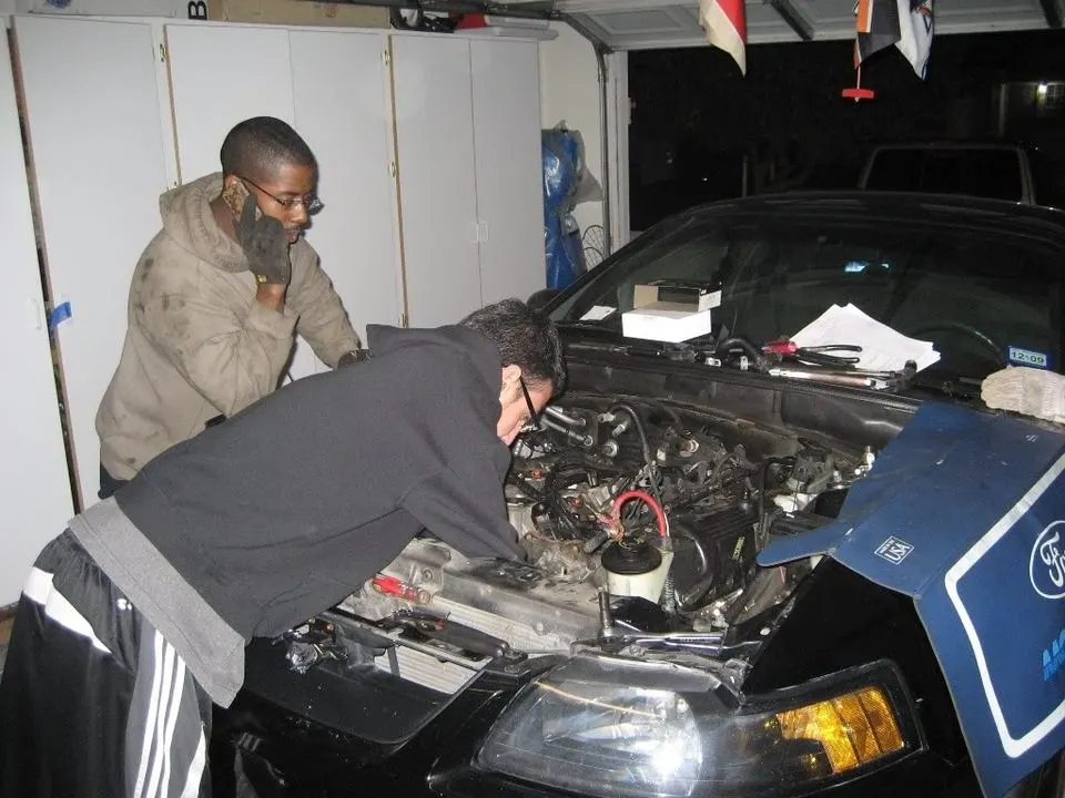

Feb. 11th update

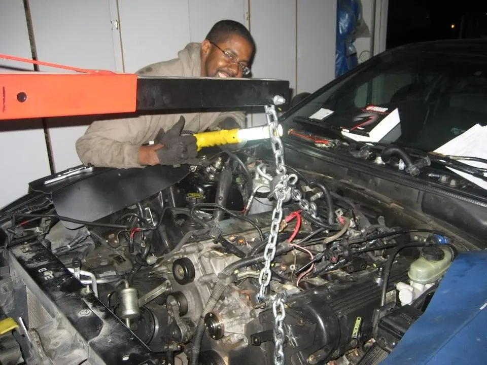

everything on the engine, trans and exhaust is completely disconnected. I only have to remove the radiator and the a/c lines and she will be ready to be pulled. That date is Feb 21st and 22nd. I'm gonna borrow my friend's cherry picker and have a few friends over to give the stock motor the heave-ho!

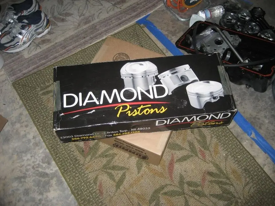

February 13th update

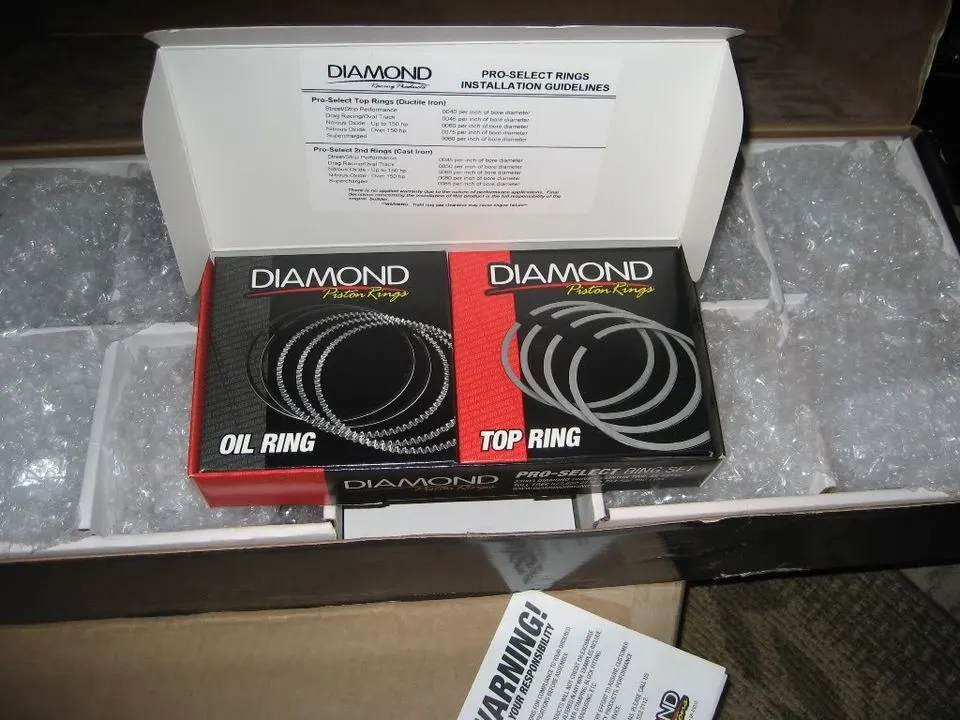

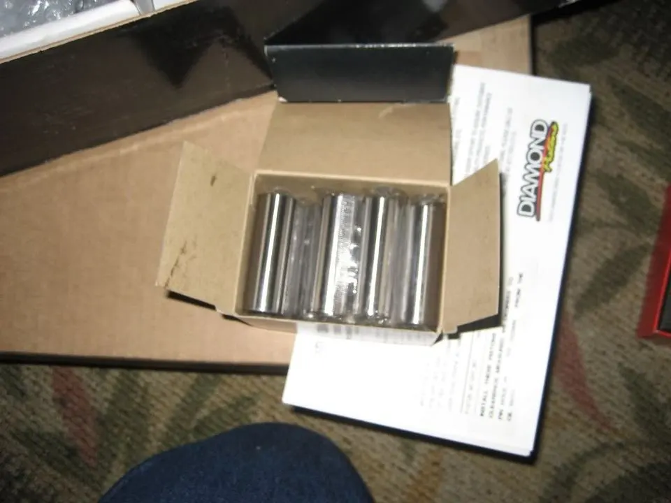

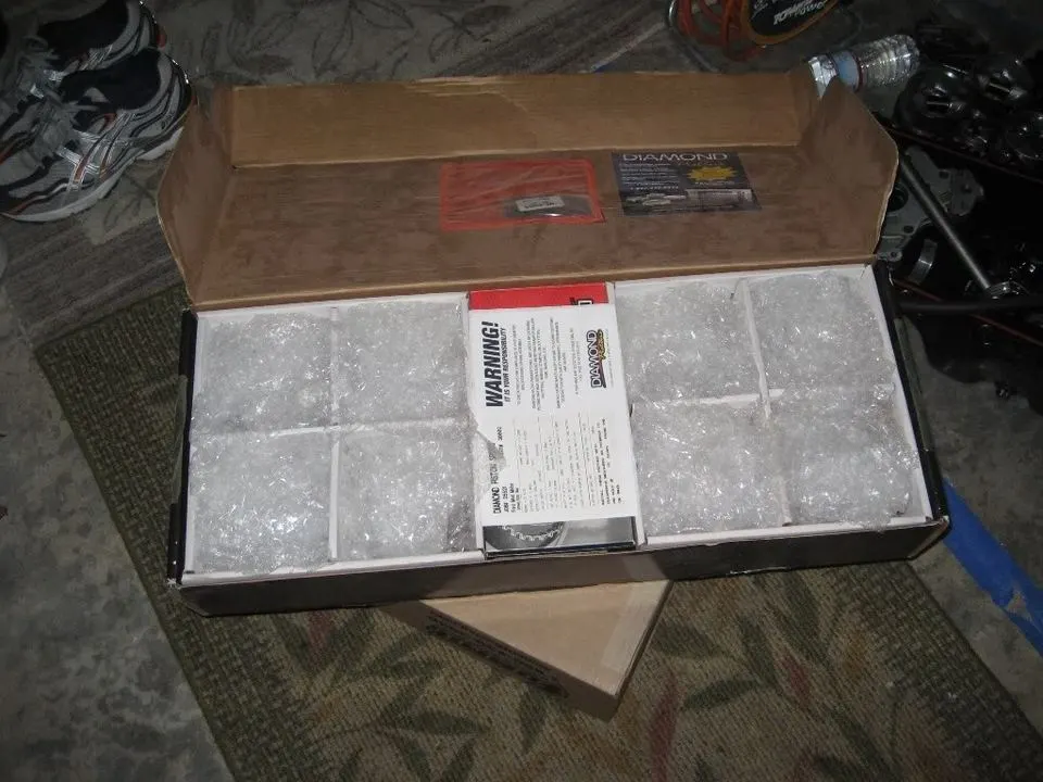

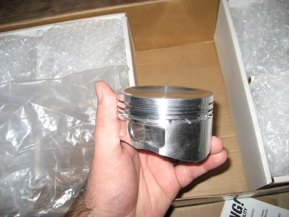

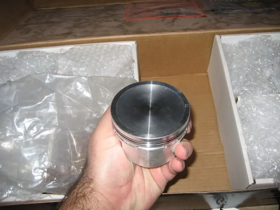

Diamond pistons arrived They'll go to the machine shop on monday so they can finish the block

Told you those pistons were a good deal, sweetness

nothing like brand new, forged piston bling, eh?

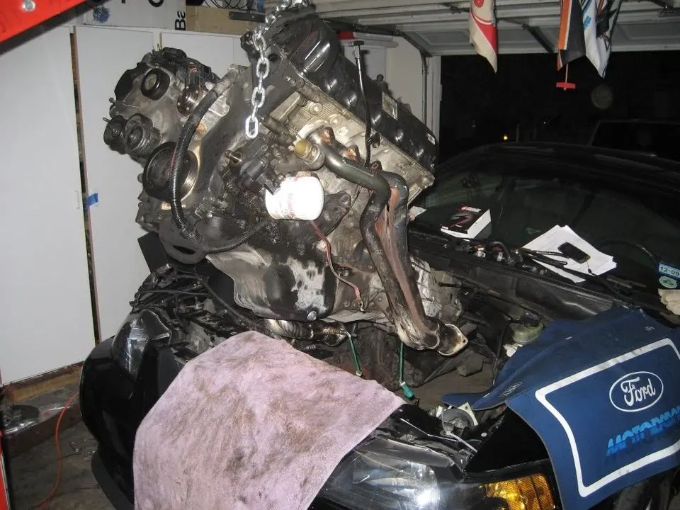

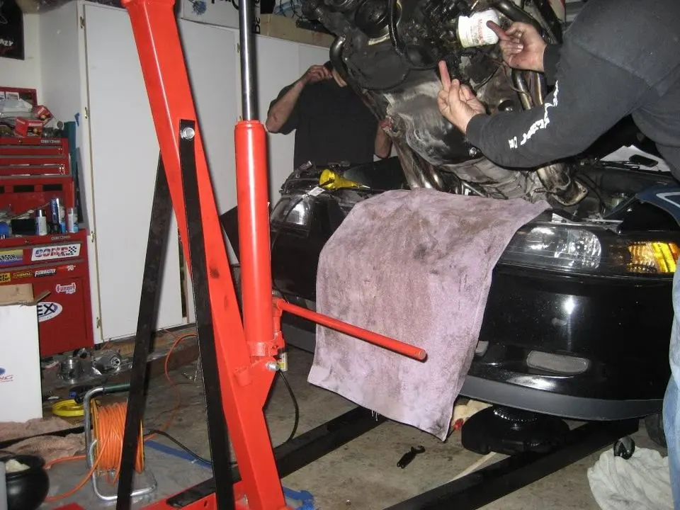

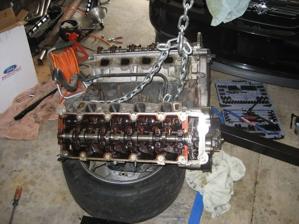

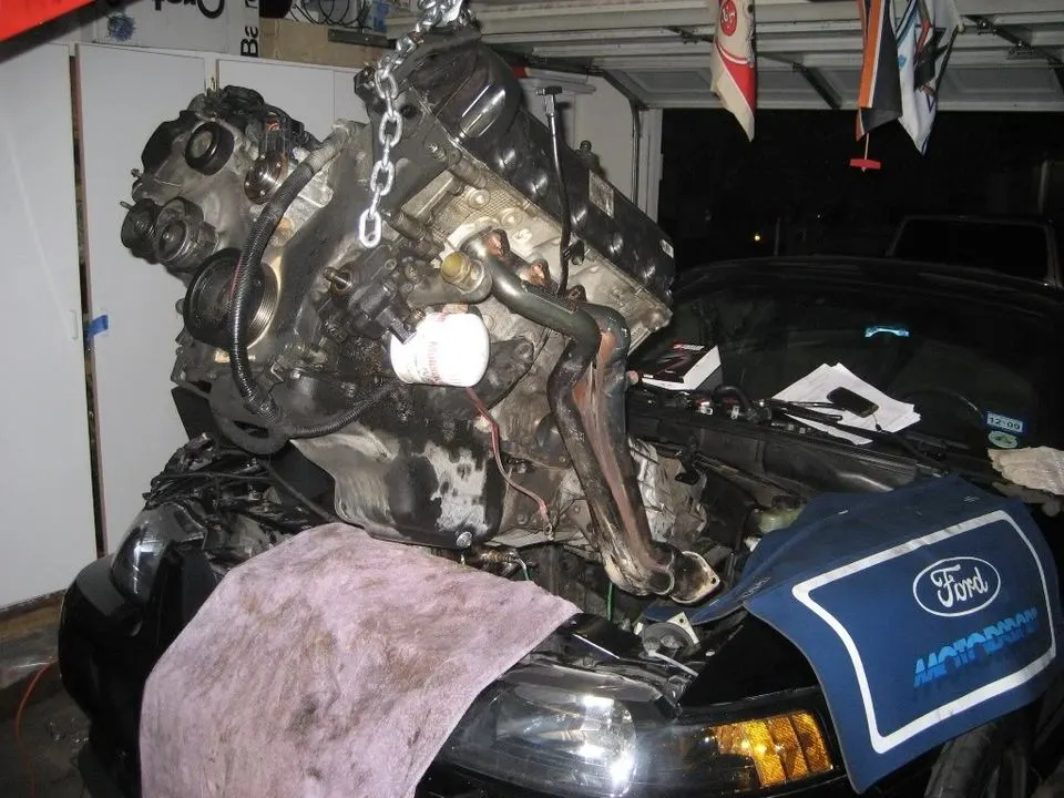

Sayonora stock motor

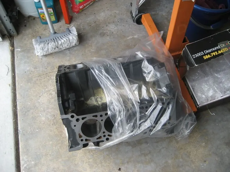

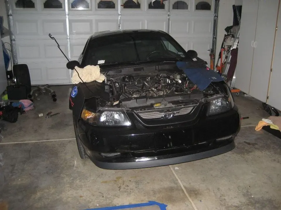

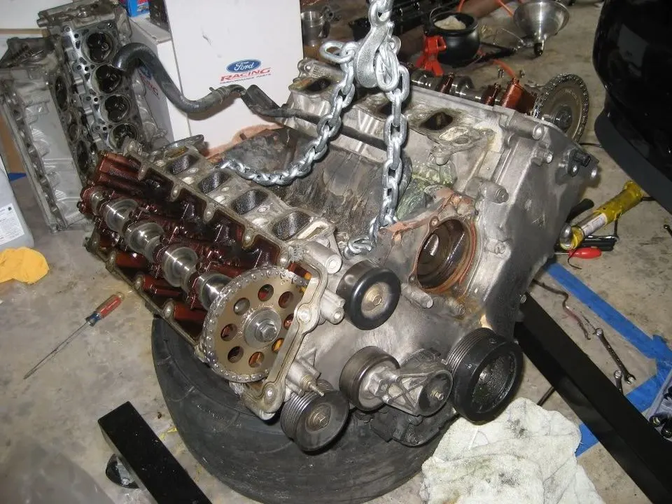

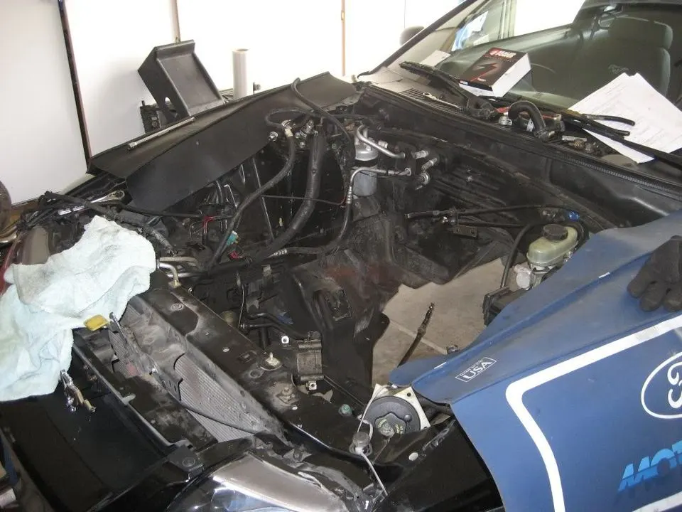

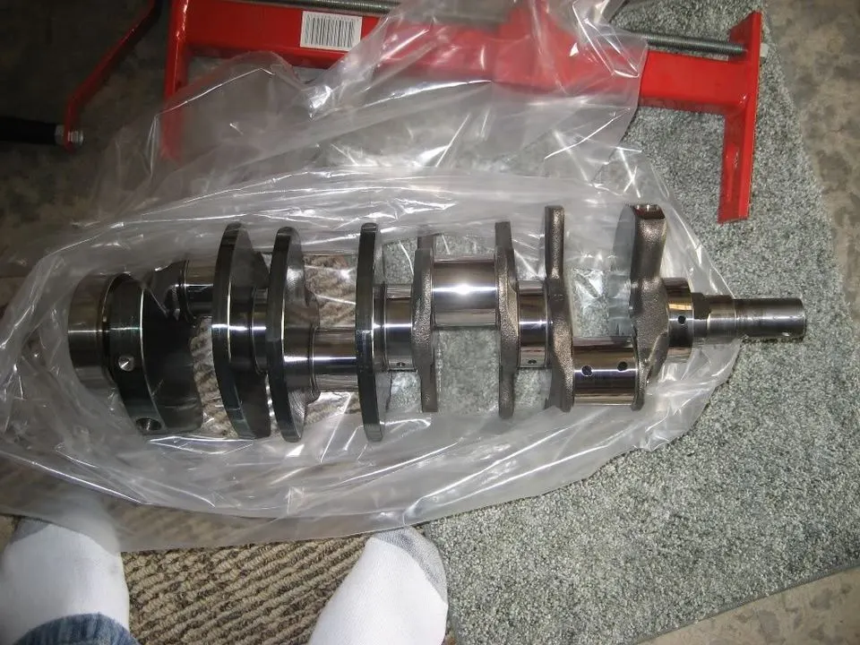

Pics from today. I pulled the motor mounts, the LT's, valvecovers, the oil filter housing and the clutch today. I need a set of multi-point sockets and a crank pulley puller to progress any further.
a heartless Mustang
stock motor and parts
machined Romeo block.
polished Cobra crank
