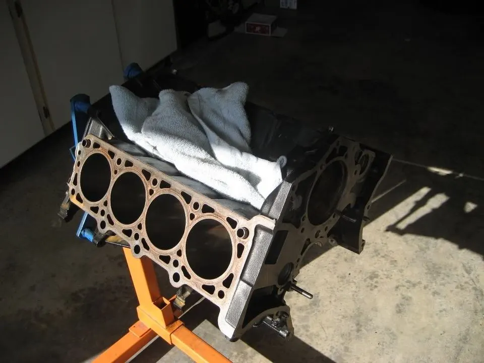

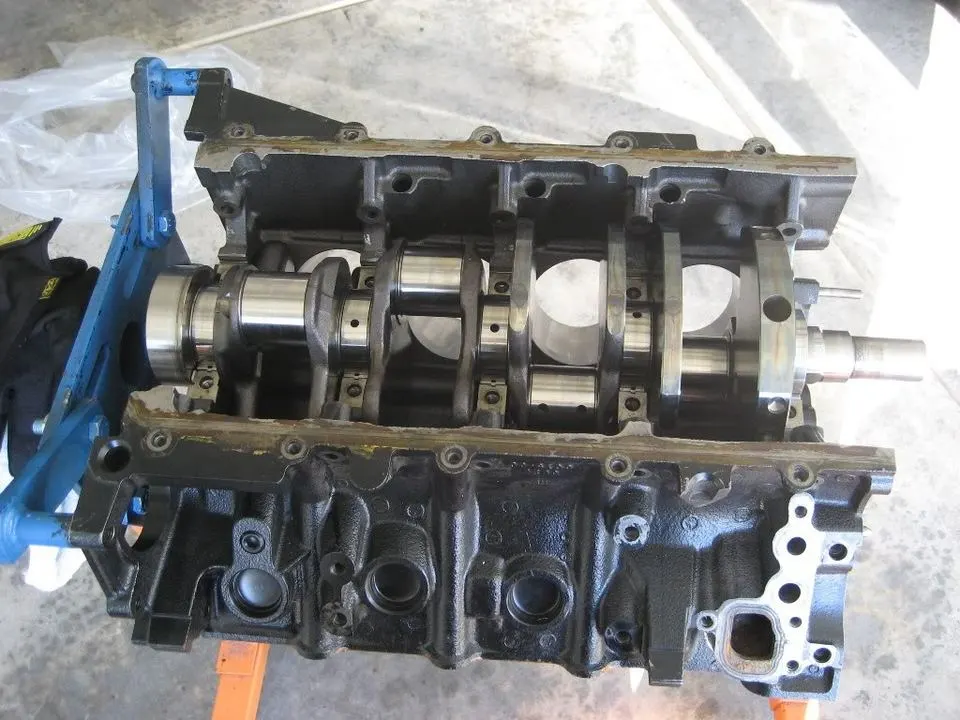

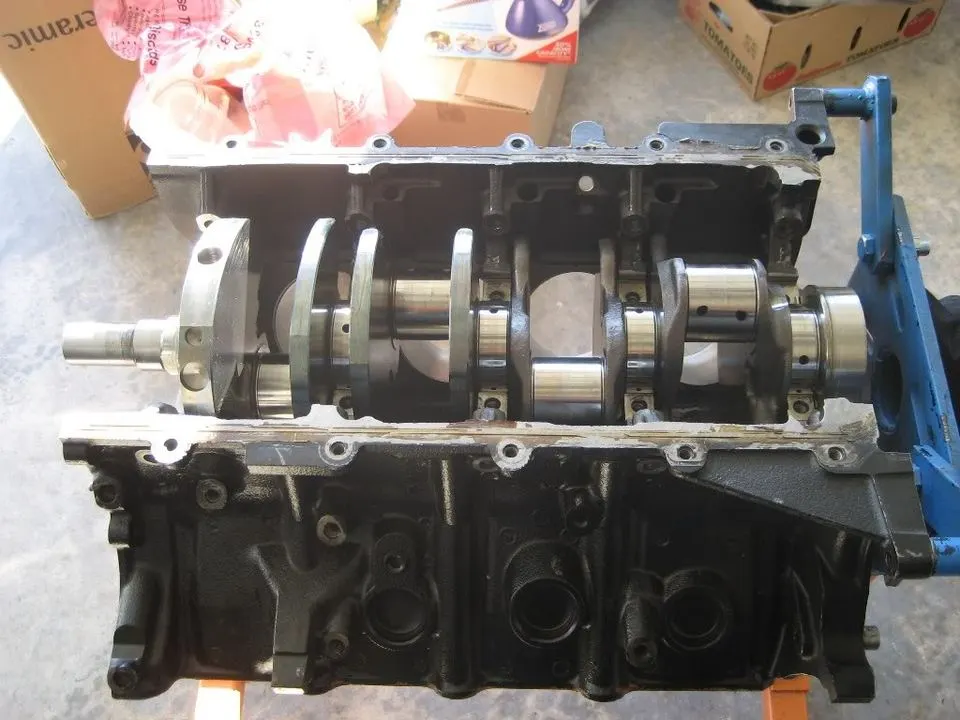

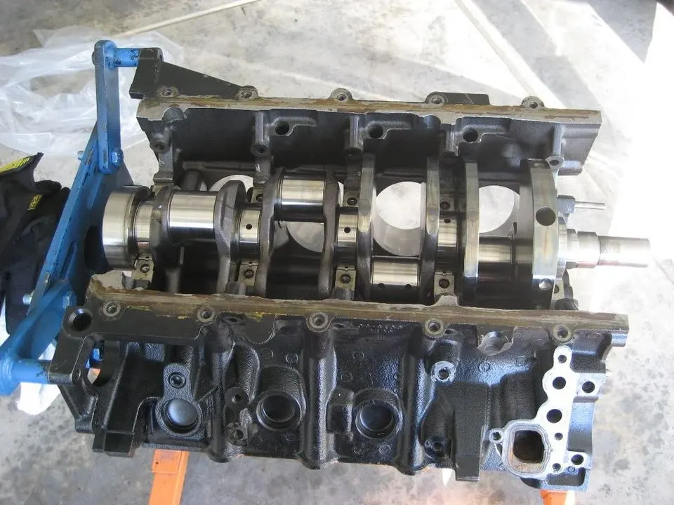

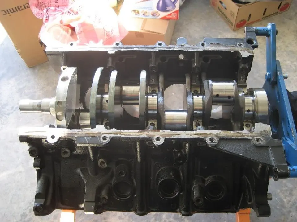

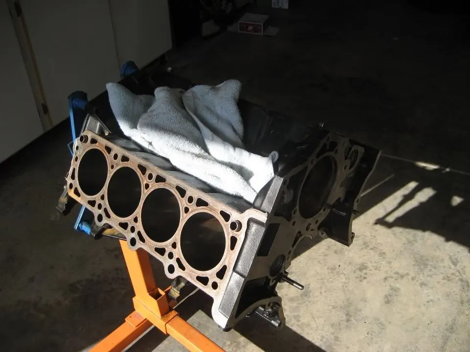

Picked up a sand-filled soft head hammer from OSH today and hammered the main caps off. The stock crank was pulled and I placed the Cobra crank in to check the clearance (all is good).
bare Romeo block
Cobra crank in the Romeo block
I'm stripping the heads down this week to start the porting and clean-up.

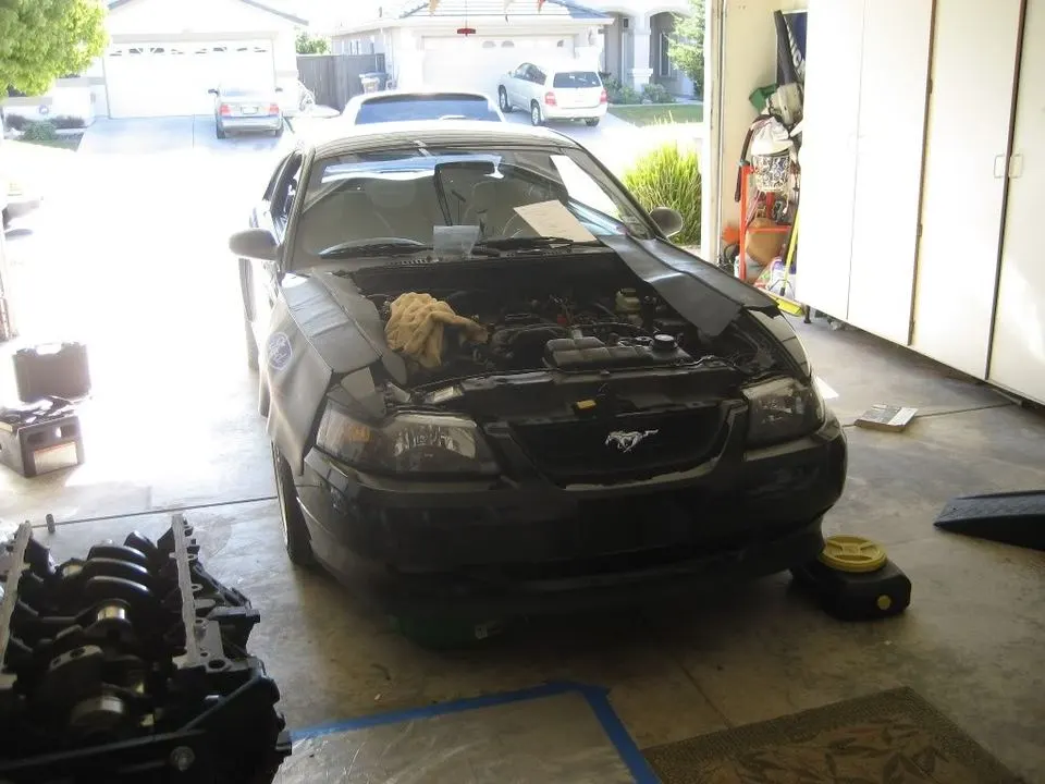

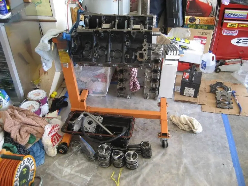

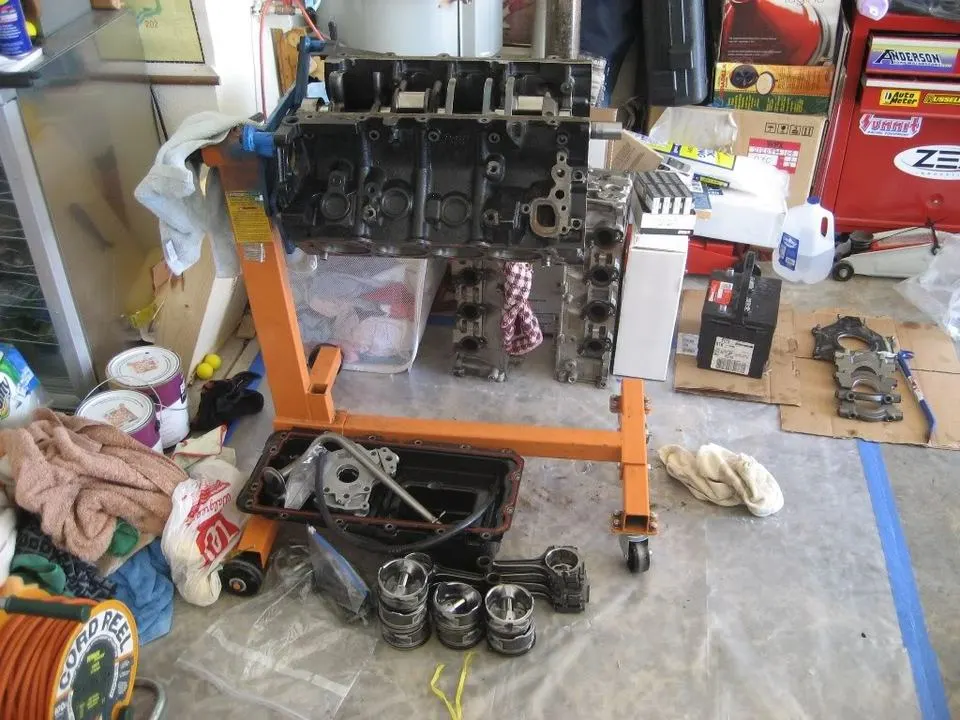

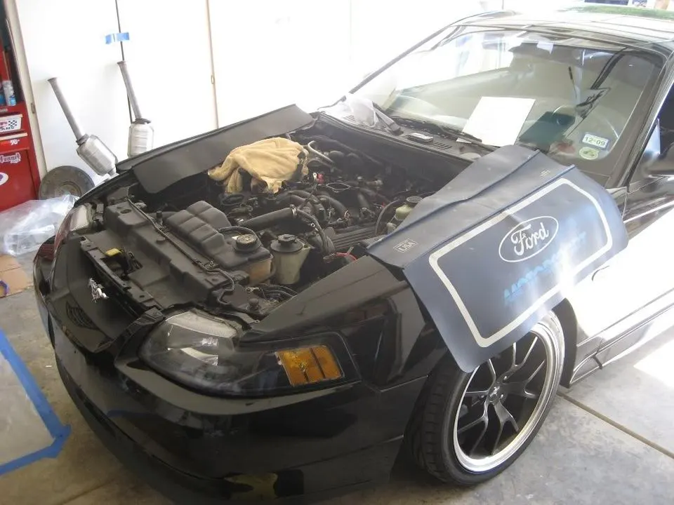

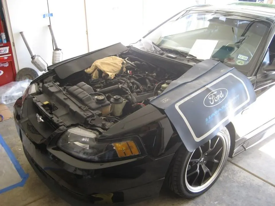

Oh yeah, this weekend, I'm tearing into the Mustang's stock motor. I'm gonna drain her fluids, start removing the top-end stuff and other items in prep for engine removal and break down.
Feburary 1st update:

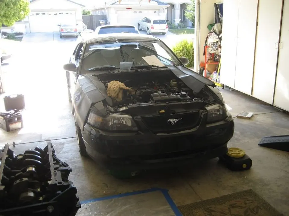

I worked on the ride for a few hours before calling it quits to get into my Steelers gear View attachment 273338

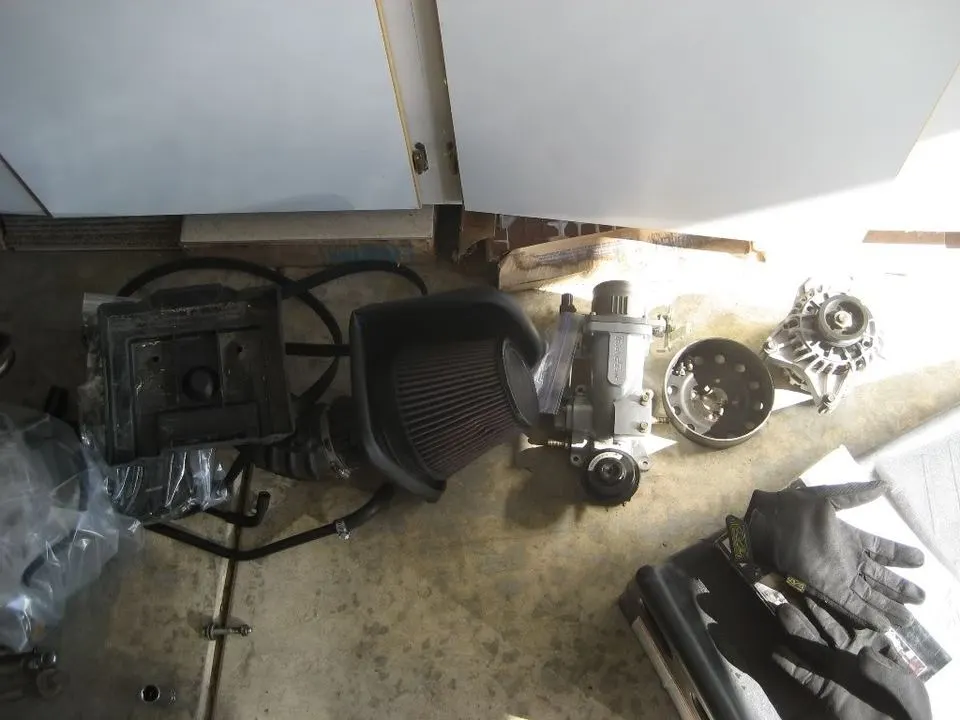

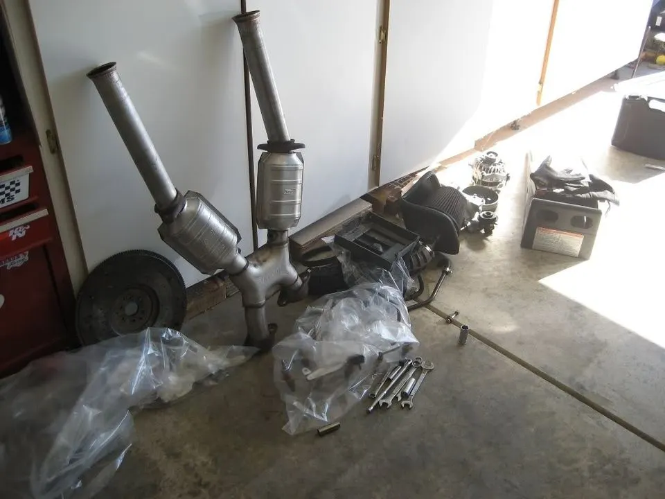

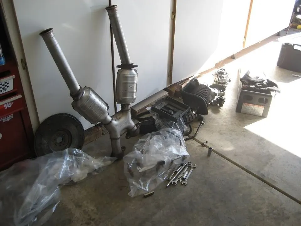

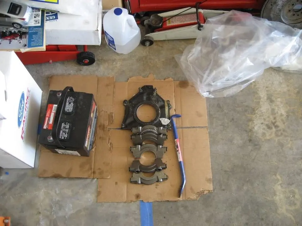

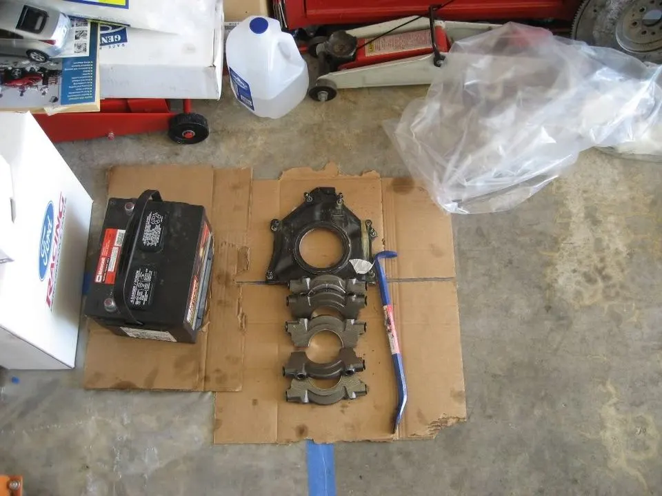

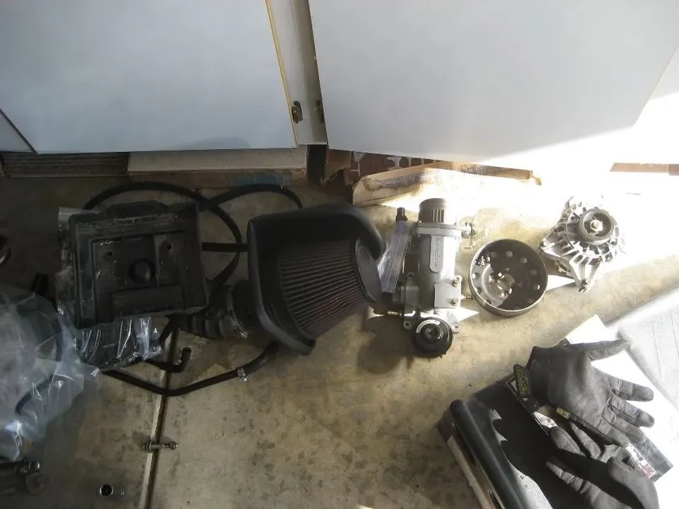

All fluids are drained except the transmission fluid (doh!). Pulled the hood, battery, plenum/TB combo, injectors and rails. The O/R X-pipe is mostly disconnected except a bolt which refuses to come loose. I have that one soaking in PB Blaster right now. I have some more stuff to remove before I can pull the motor/trans/headers combo. I'm looking to pull that the 21st/22nd.
Engine is stalled til my rods get here, which should be this week. I'm ordering the pistons and rings friday. The bump in compression is a definite now, to 10:1. The rebuild of the spare set of heads is delayed until this summer when my bank account recovers, likewise with the upgrade with the cams.
Now, onwards to the pics:
The ride under the scapel
the heart transplant on-going
parts coming off the car
