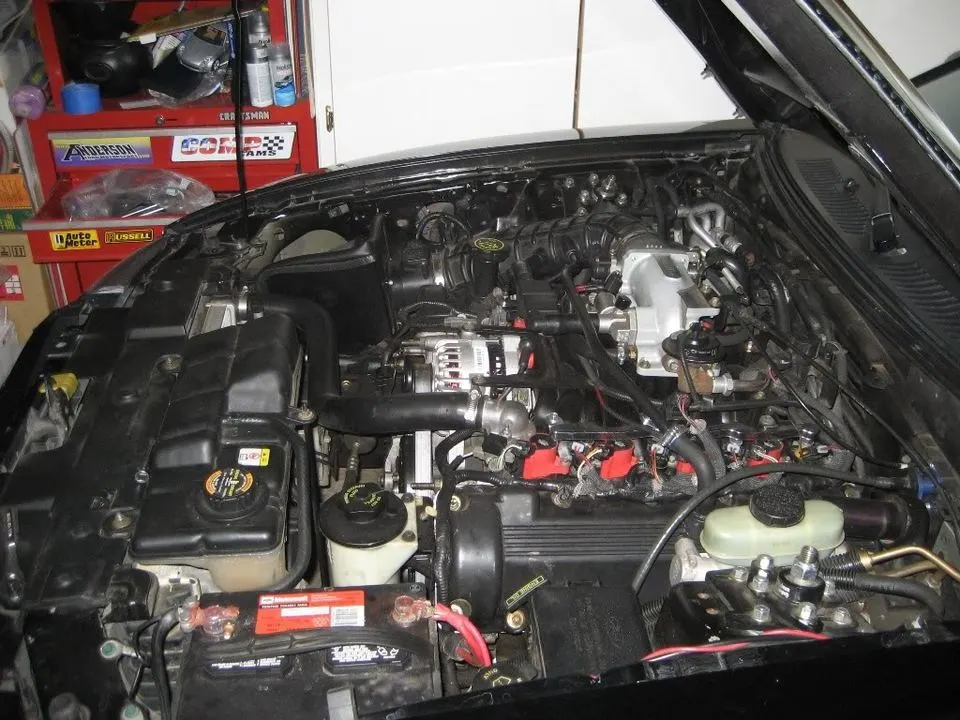

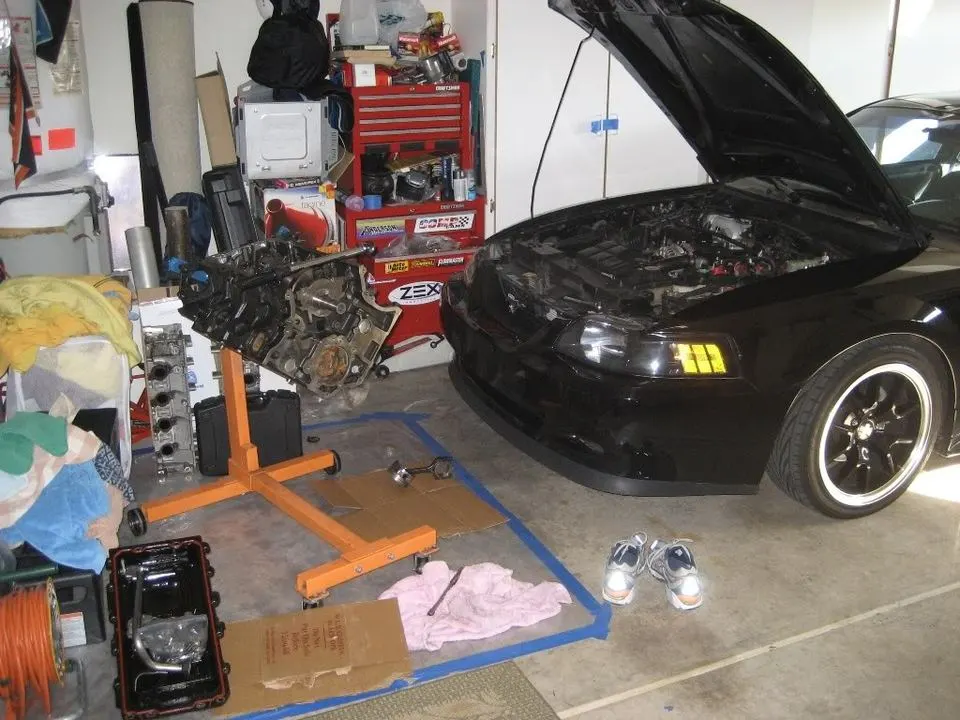

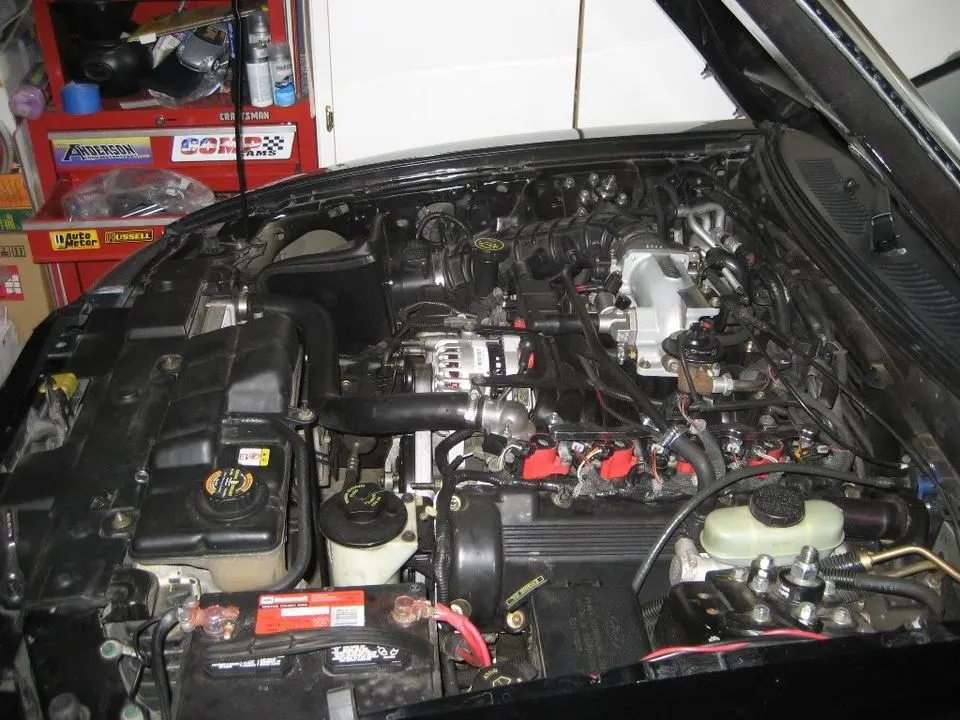

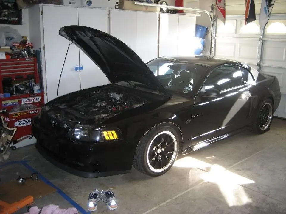

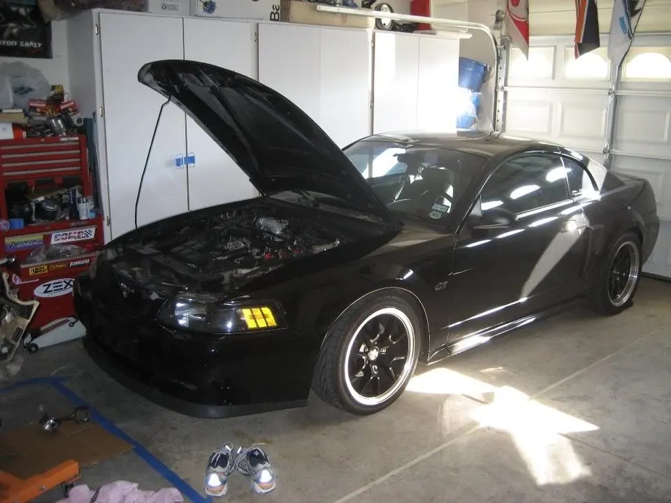

I've been nursing a bad rod bearing since mid-November and today it gave it's final notice. I pulled off the freeway coming home from class and noticed the rattling was ALOT worse than before. She stalled out a couple of times trying to get her home, but I eventually made it.
I was able to limp it to the garage without making the block air-cooled

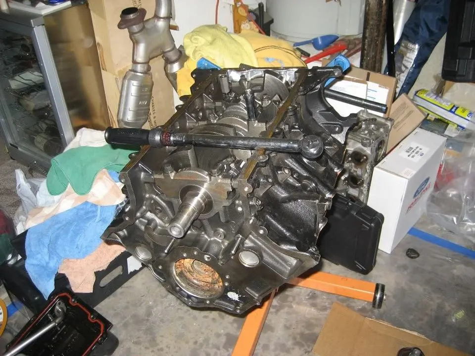

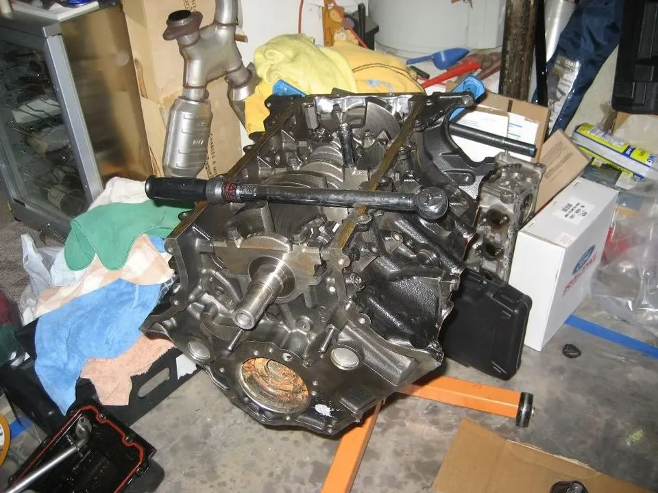

Last pic of the stock motor. I'll start tearing her down this weekend, getting it ready to be pulled. Some of the parts on the top end side will make it to the new motor

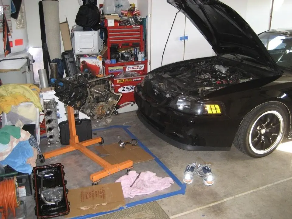

My "workshop" lol. Story behind the block: fresh, stock rebuild that has a bad wristpin. Mileage with the wristpin is unknown, so off to the machine the block will go to be inspected.
Close up of the block. I removed the oil pan, pump and pick-up today along with #8 piston. The rest of the internals and the crank will be pulled tomorrow. Behind you can see the Romeo PI heads I got for free. They'll receive a port and polish job. The Ford Racing box is my high flow oil pump. The collection of boxes behind it is all the gaskets and bearings for the new motor.
I'm borrowing my pop's Ranger to get to school and work while the wifey is away doing the Army thing. She'll be back in May, but I hope to have this done by end of March.

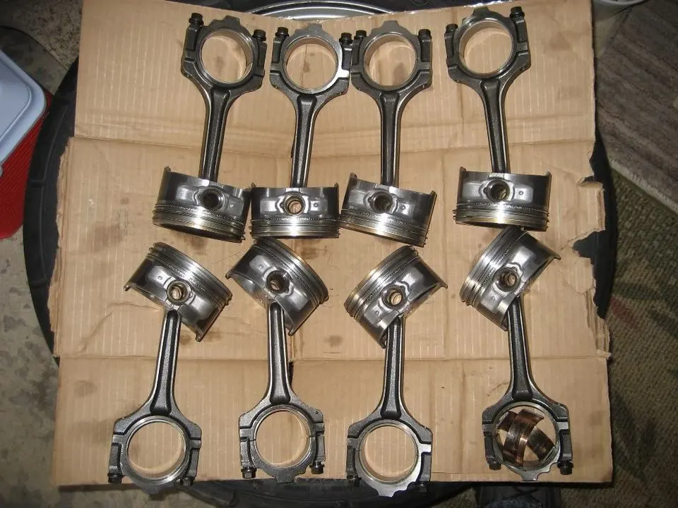

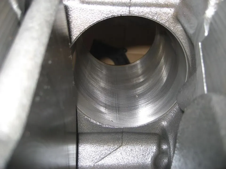

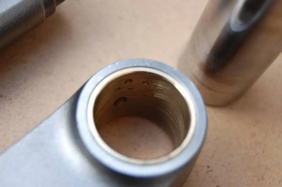

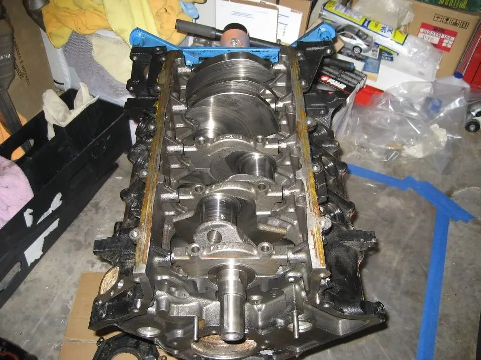

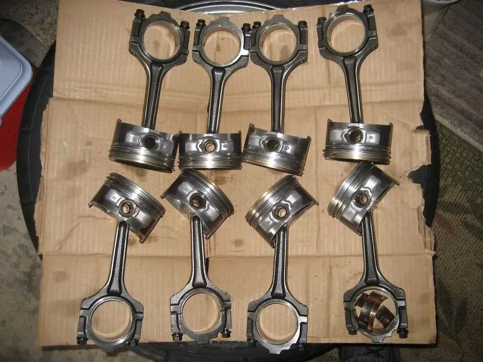

got all 8 pistons and rods out of the shortblock. Originally, the seller said it had a bad wrist-pin but all I could find was a bad rod bearing. Seller said it had about 100 miles before being pulled and I would have to agree with him because everything is in awesome condition. I'll take some pics tomorrow and post them up :nice:
Update for today:

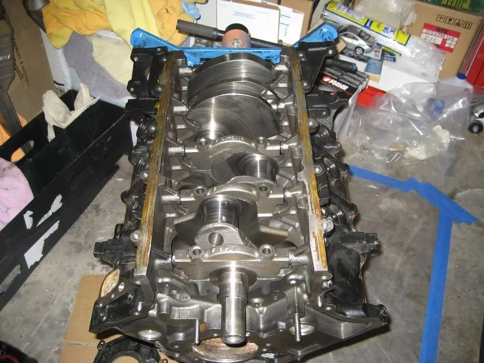

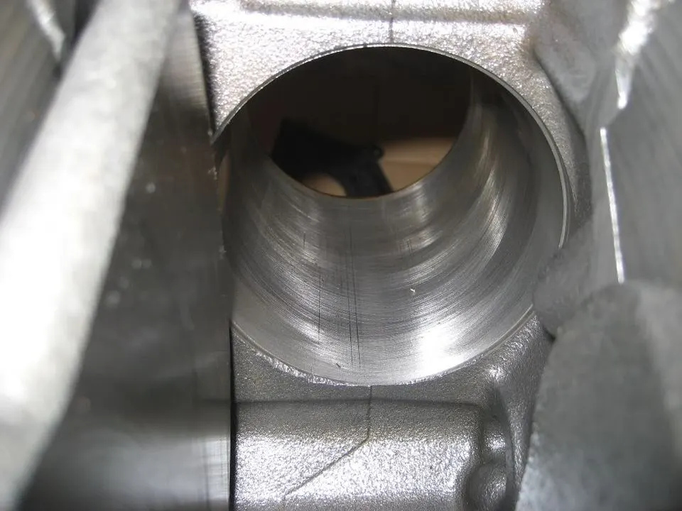

shortblock is pretty much broken down. I still have the stock GT crank in it for the sake of storage. All the internals are in great shape and will be up for sale here soon. The wrist pin problem was never found, but I did find a burnt rod bearing on the #1 piston/rod.

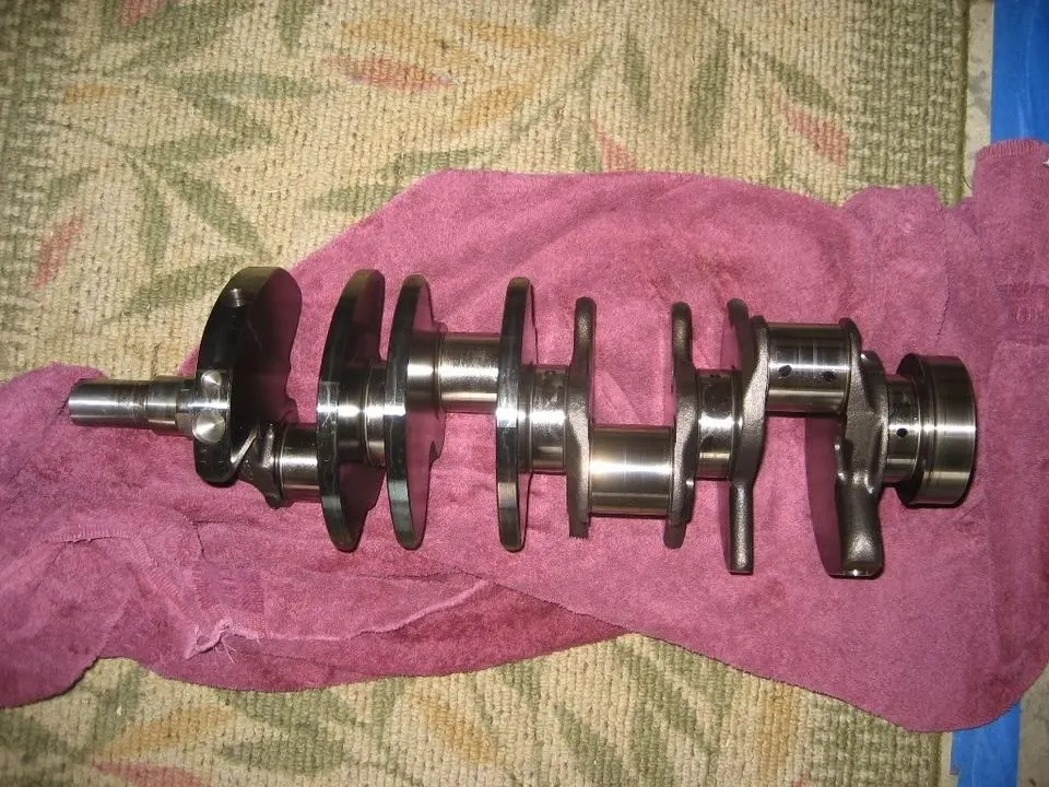

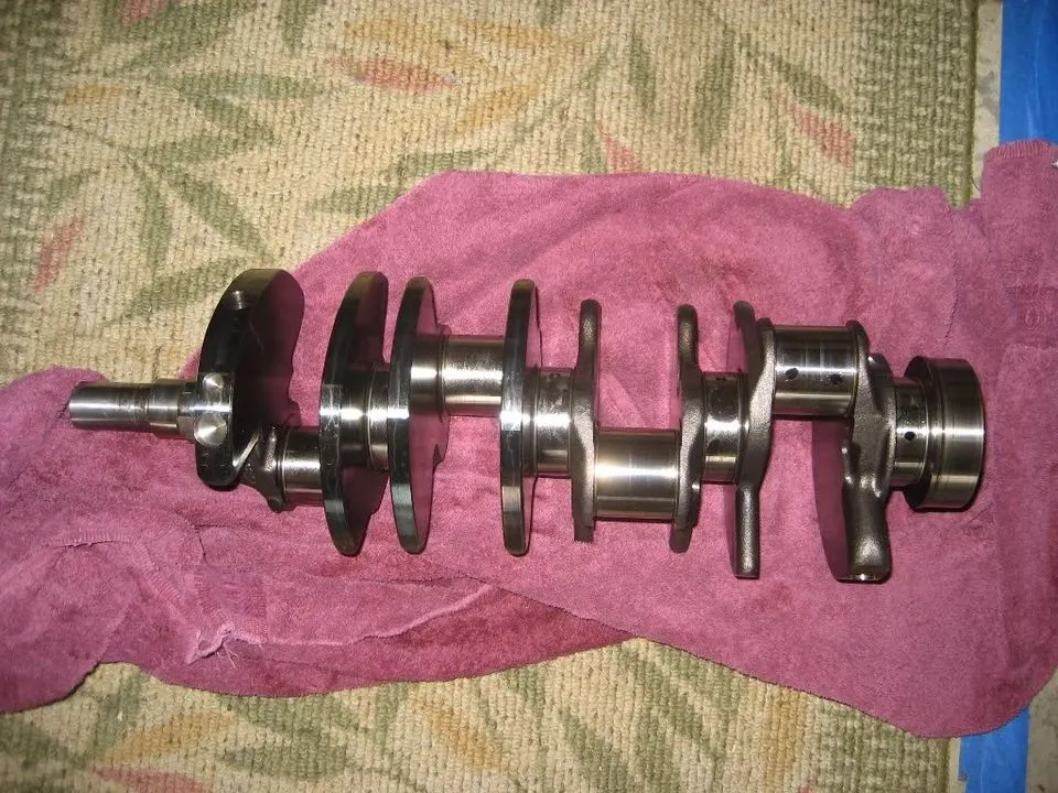

picked up the Cobra crank today :rock:
