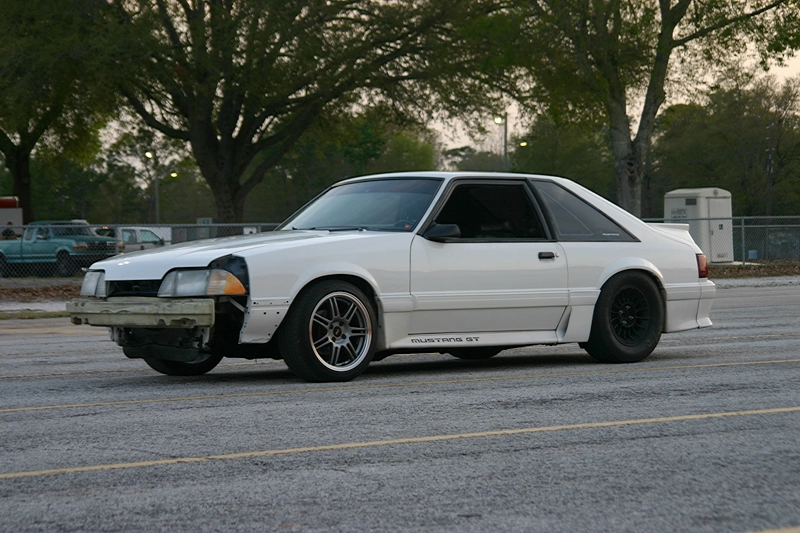

Hey guys, so I got out of the lower rider scene for a day, raised the car up, threw the slicks on, and went to the track.

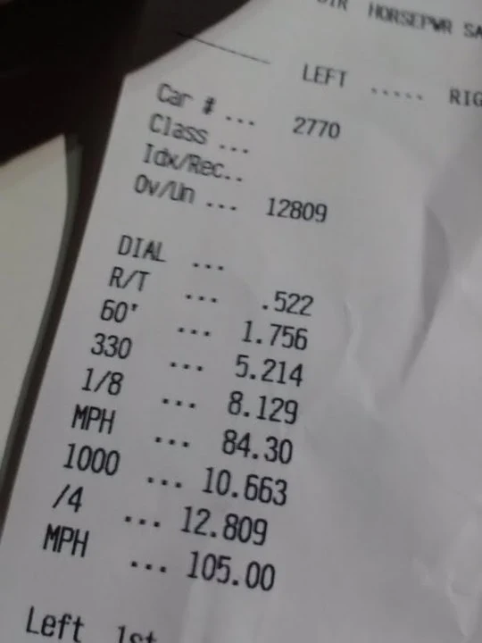

I was pretty happy with my results, first time hitting 12's, I knew the car had it in it, I took my timing gun with me and kept adjusting it until I got it right. I think it still has more in it, I think with a better launch, and better shifting points I could drop the ET a little more how it sits.

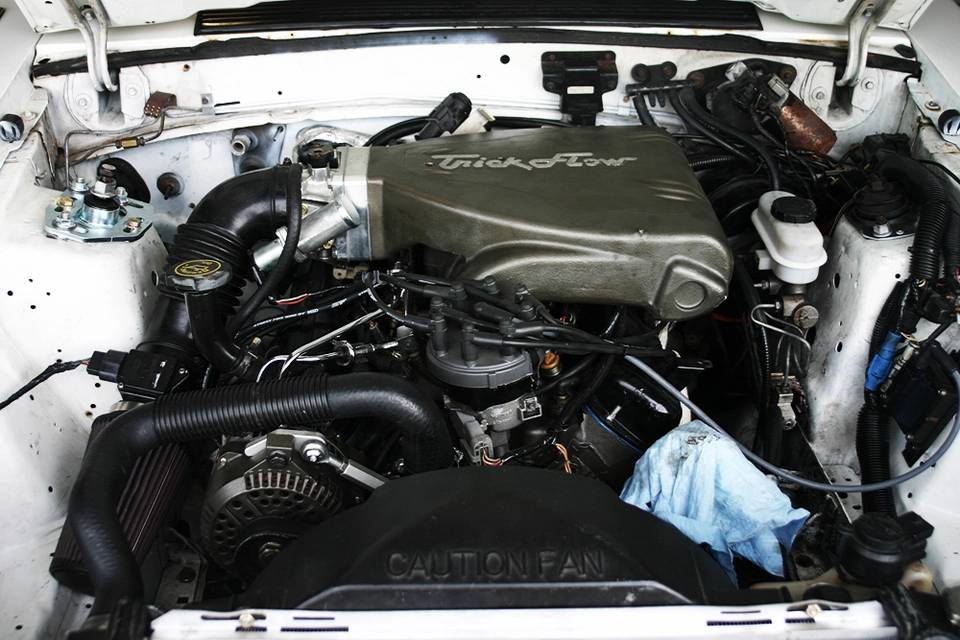

Heres my mods list:
TFS Street Heat Intake
TFS Stage 1 Cam
GT40p heads (trickflow springs)
MAC LT Headers
O/R Xpipe
Underdrive pullies
75mm Accufab t/b
95 GT MAF
3.73 gears
Coilovers all around
Adjustable solid bushing upper and lower control arms
MT ET Streets 26x10.5x15
I'll post a couple more pics later today from the track.
nice!! with your mods and your 60 was pretty good @ 1.756
Thanks man, I guess 1.75 is good for the power and suspension setup I have, my car is not really setup for drag racing. The car doesnt make enough power to pull through a dead hook, if I dropped the clutch the car would dead hook lift up, then flop back down killing my 60', I was pulling 1.85's first couple times. The 1.75 is riding the clutch out hard at about 4-5k rpm.

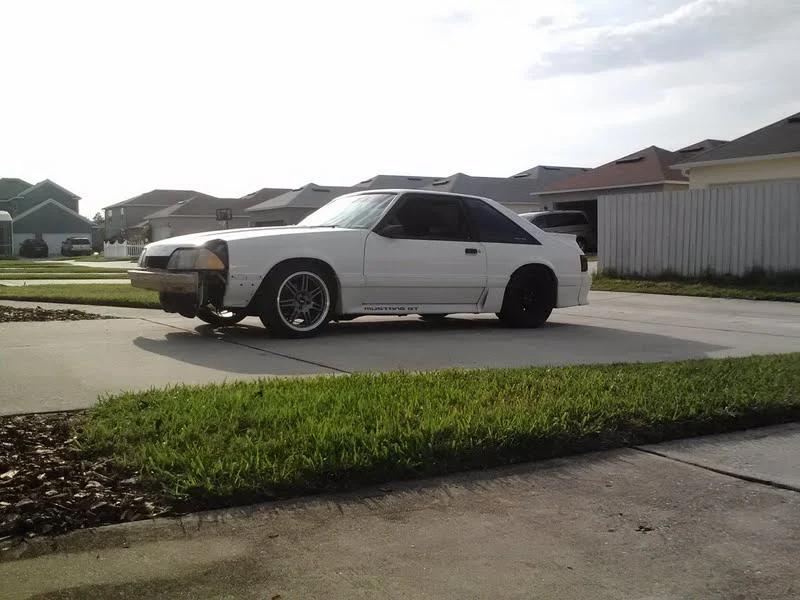

Here's a pic before the track, I went there straight ratchet style.
A 12.80 is good. How high were you launching, what rear gear do you have and do you know how much your car weighs? Hoping to throw a set of slicks on mine this spring. I was hoping to hit 1.7's on the 60 ft, now i have some hope. Good job!

I was launching around 4500-5000, once the second yellow light came on i held the throttle like 3/4 or a little more, then on green i just floored it and rode the clutch off pretty hard. You gotta mess around with it and see how the car responds, I am sure different suspension setups, etc will run different. But for the most part, drop it and go.
Gears are 3.73's, no idea what the car weighs, I have mostly full interior, just not radio or speakers, I forgot to take the spare tire out too and I went on like a little under 1/4 tank of gas. But I have battery in the back, and the front clip is missing as of now until it gets painted. As for the motor, it's stripped pretty much to the basics, no smog, no egr, no a/c. There were a couple mods I forgot that I added, just accufab 75mm t/b and a 95 GT MAF, nothing crazy, I've actually got the stock airbox on it now too.

Yea the tires will do it man, I was hitting 13 flat @ 101mph with like a 1.8 60', you definitely have more in her, unless you're makin a lot of power to push you down the line I feel like its pointless to even go to the track in our cars without good tires. You're gonna spin all the way off the line, and be disappointed at the other end.

Any further improvement in ET would be in the 60' and shifting...........with that mph, your not gonna improve the ET much at all from where you are at. Not enough HP to do it.
