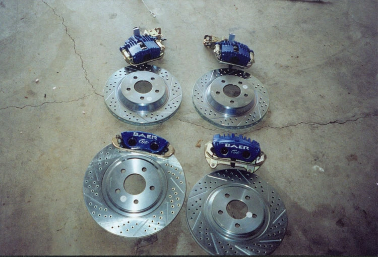

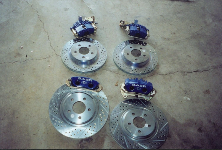

mine was around 2k total...with each caliper being 100 bucks more to powdercoat it blue...so around 1600 without powdercoating...

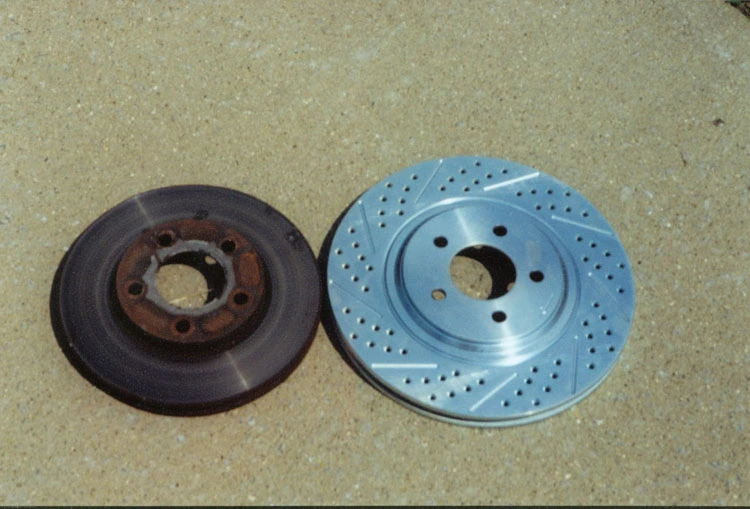

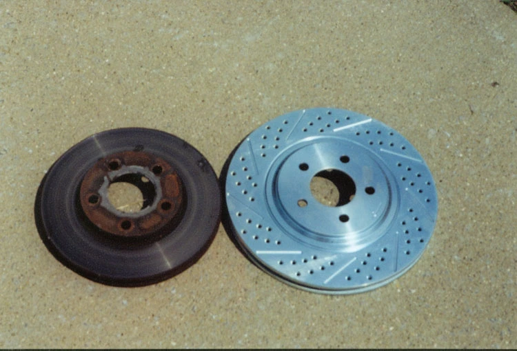

Of course you do get the bling bling crossdrilled rotors, which i happen to like.
