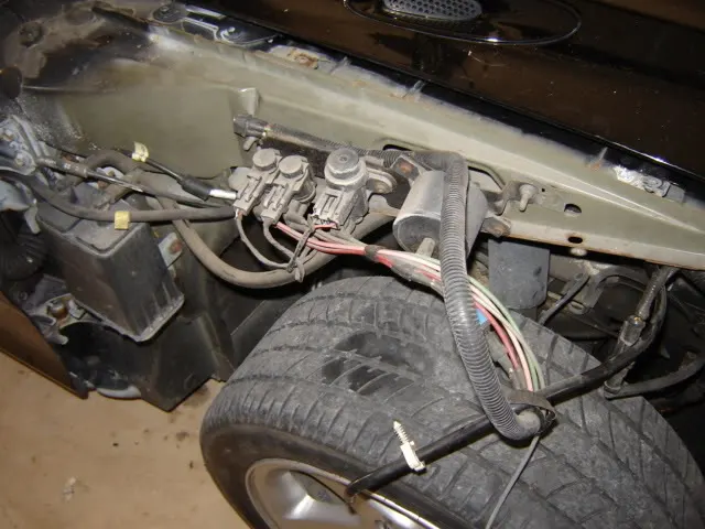

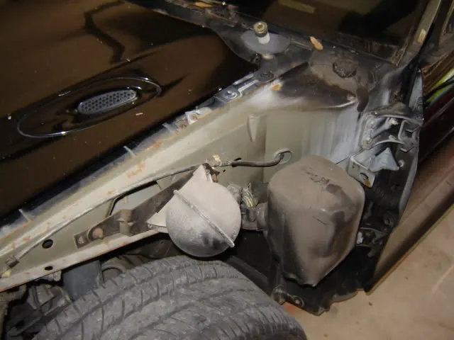

What can I remove inside my fender as far as EGR/Smog? VibrantRedGT! (Pics)

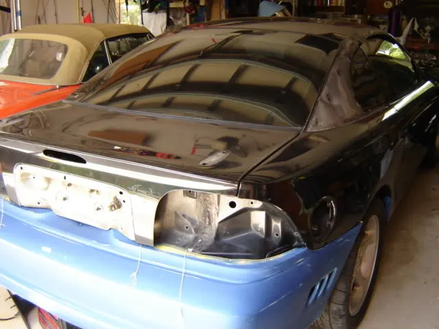

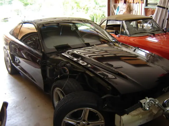

Vibrantredgt posted a thread exactly like this a while back but I can not find it. My car does not have EGR or smog so I am wondering what I can remove in the following pictures. Check out the weight reduction I did so far too! Thanks guys

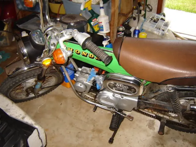

My other current project: Full rebuild to 110cc instead of 90, with a bunch of other rebuild/restoration stuff.
I've removed all of that on my car. Charcoal canister and cruise control included. If you remove the charcoal canister, there will be a vent line from the fuel tank that ends under the fender, and is normally directed to the canister. At first I just left this and the fumes were very strong. I traced this line all the way back to the tank, cut it, added some hose, and vented it behind the car. No more getting gassed out. Do you still have AC?
