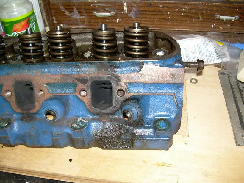

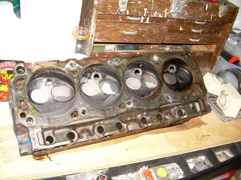

here's my #8 my ring is shot but i have good compression
oil coming out the spark plug hole

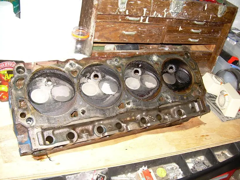

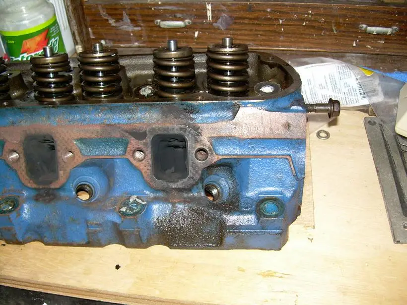

Just a little melted. I had the exact same problem last week only with the forged slugs.
<center>
<a href="http://i102.photobucket.com/albums/m110/mattz281le/Mustang/busted1.jpg" target="_blank">
<img src="http://i102.photobucket.com/albums/m110/mattz281le/Mustang/th_busted1.jpg"></a>
</center>
