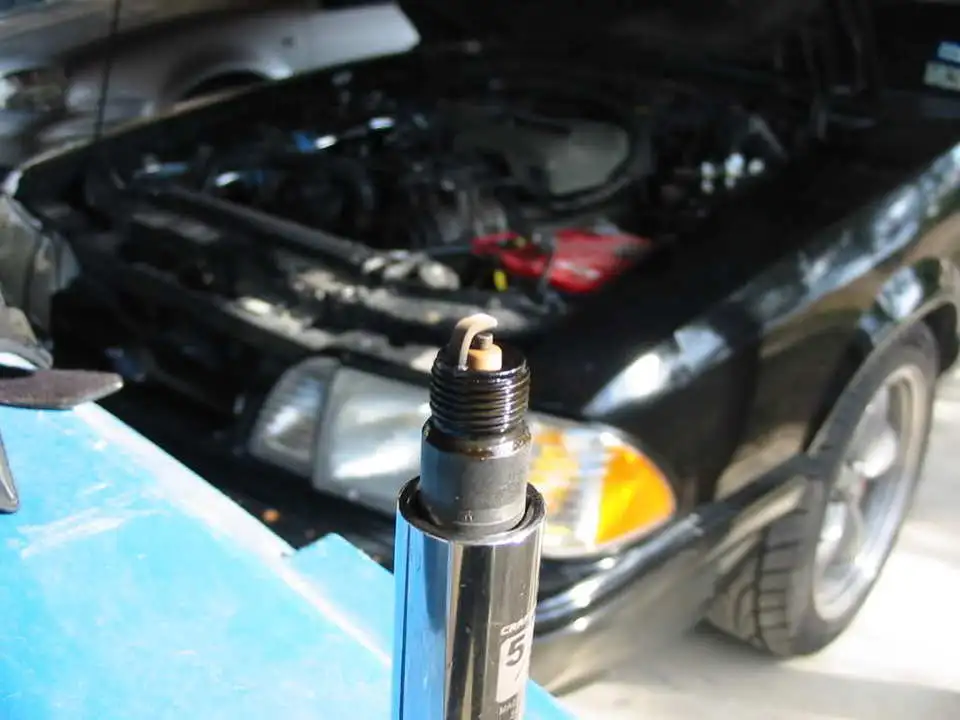

Pulled most of the plugs. The passenger side head plugs looked new, the driver's side plugs not so much. #5 looks lean (no surprise there), #6 is already starting to get cruddy looking, when I swapped these plugs in about 3K miles ago, #6 was so messed up, the gap was almost completely closed off with deposits of some sort. I had the wife start it and I saw no smoke at all. I must have something going on with the driver's side head then, cause the threads on the plugs on that side had oil on them, where as the passenger side plugs thread's were dry.
Here is number 6, you kinda can't make it out, but this one already had some buildup around the base of the plug.

Are the heads stock as in stock valve seals? I'd still say this would be my first attempt at fixing the oil consumption problem due to it not costing much and is relatively easy to do vs. just tearing down the motor ya know?
