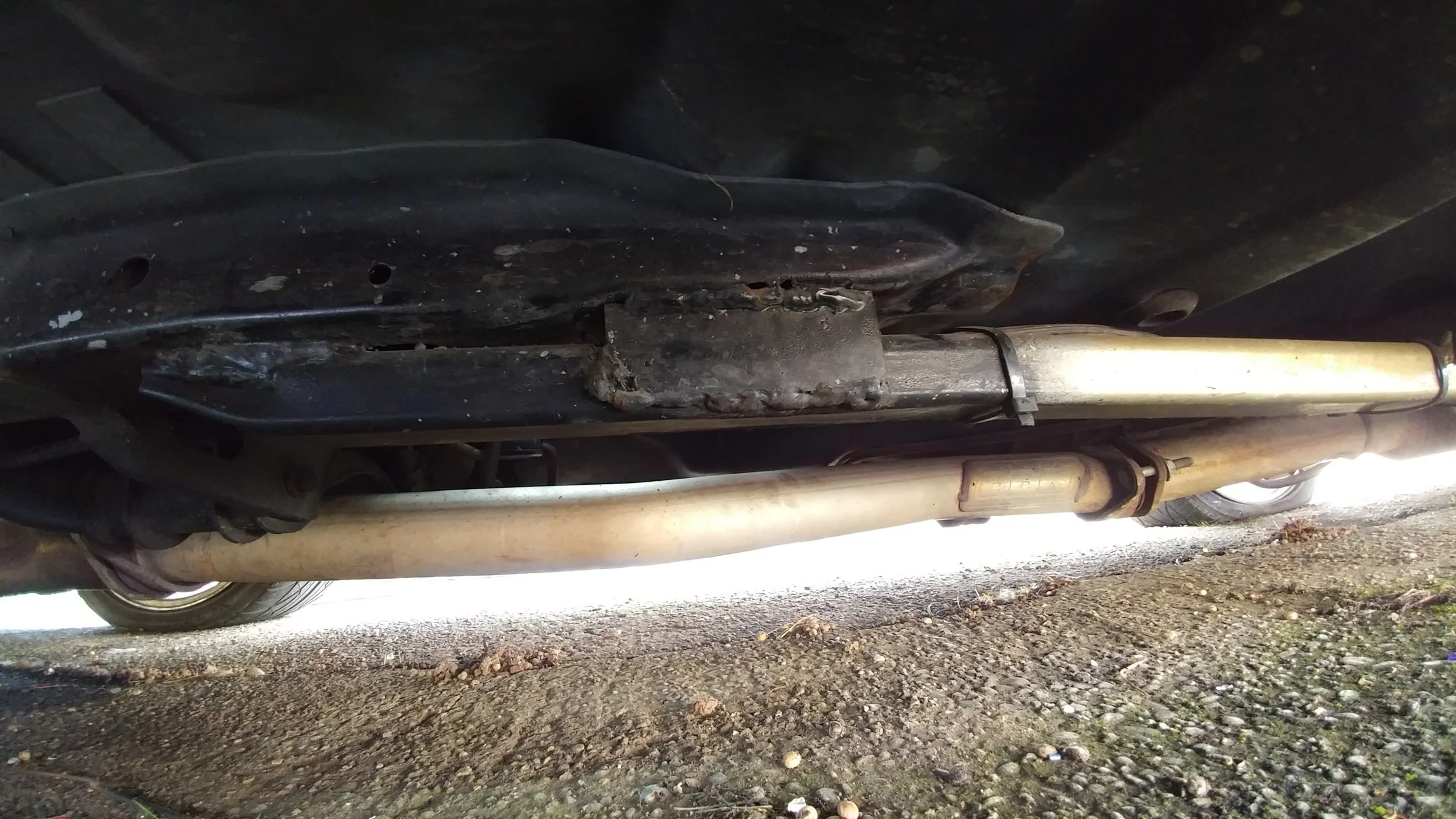

So I just noticed this, and it makes me kinda worried it's trash. I might take it to a shop that has a frame rack and can check it.
Note: This is how my dumba** bought the car.
The front SFC on the driver side. Note, they had to add those plates to weld it.

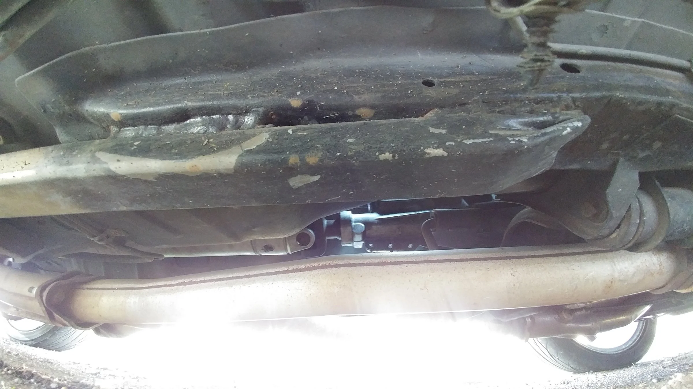

Then the passenger side. No plates.
In person, you can visibly see that the driver side subframe bends upwards, and the passenger side is more flat.
Was likely installed with the car on a lift which causes the frame to flex and the subs didn't line up. Cut it off, place the car on its wheels and try to install again.
