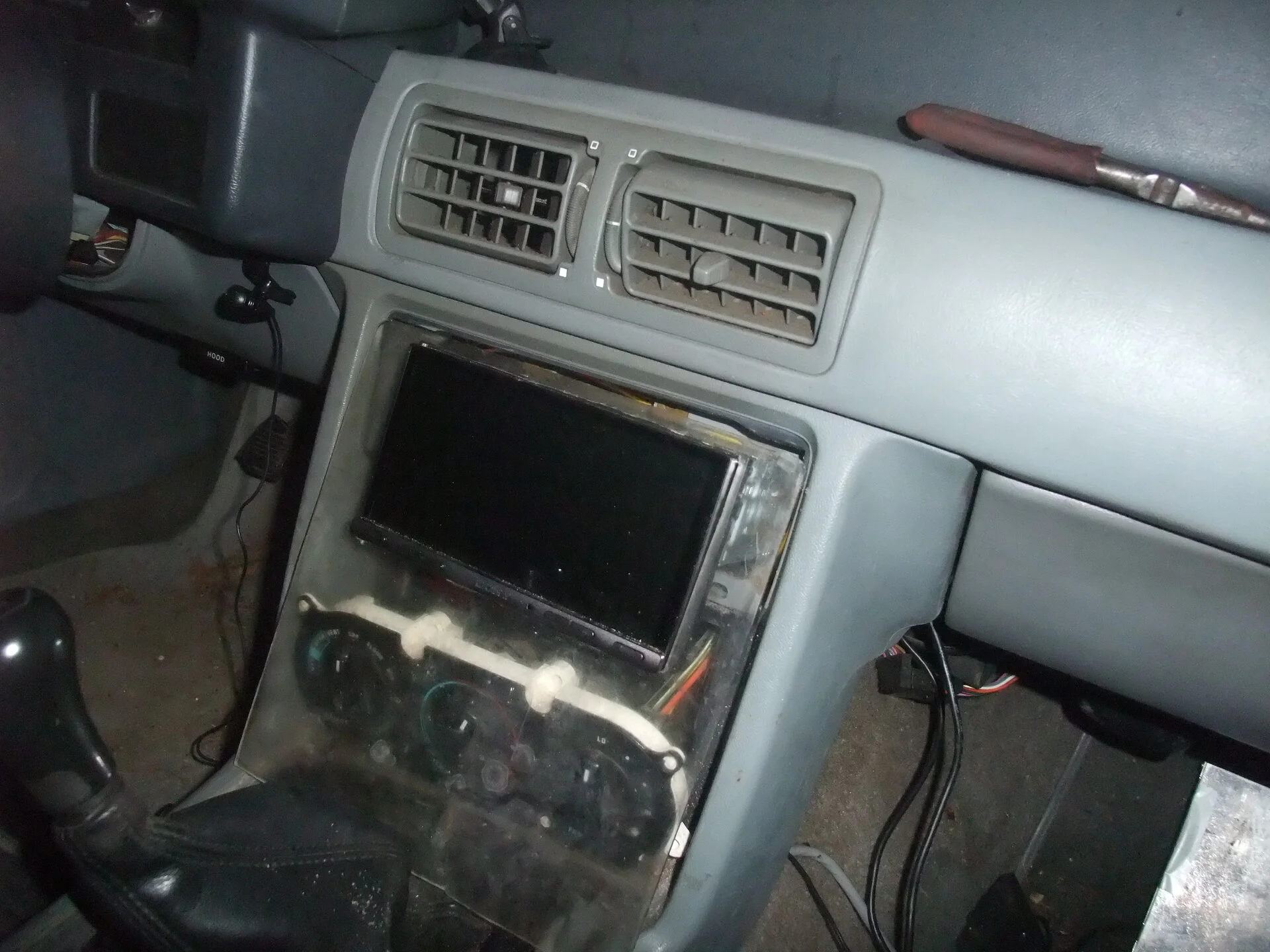

I found a Sony XAV AX5000 model on ebay open box but brand new for $310 and a link to a bezel is here
View: https://youtu.be/1MPJ1YiaHPM
, I can fab my own copy of this, but the vid shows how to mod the AC controls so they fit down low. This model does not have built in nav or a USB on the front, but its unique shape keeps from needing to hack up the dash to make it fit. The usb is on a cable and it has 2. Nav can be done w Android auto and google maps.

Yes I looked widely over the net.....the Sony radio is a unique shape on the back side that I think may work particularly well. There is another brand that is very shallow in the back, After I saw how much of dash must be cut out to fit a conventional full size dbl. din in the upper spot, I quit considering them an option. Putting one in the lower org. radio spot seems all most pointless, and I agree the upper location is only a little bit better.

I'm hoping to figure out a way to mount the radio tilted back some, I think it will make seeing/using it much easier and then kick out the ac controls some under it and then make a custom cover.

I got the radio in with relatively little hassle, the heat/AC controls moved down w/o having to do anything but tug on some wires to get some more length. The unique shape of the back of the Sony made this easy. The plastic face plate is only half made in this pic....need to finish the lower 3 holes and trim the bottom. I'm very pleased w how its turned out. Making the face plate from a piece of clear plastic will paint it flat black when done.
