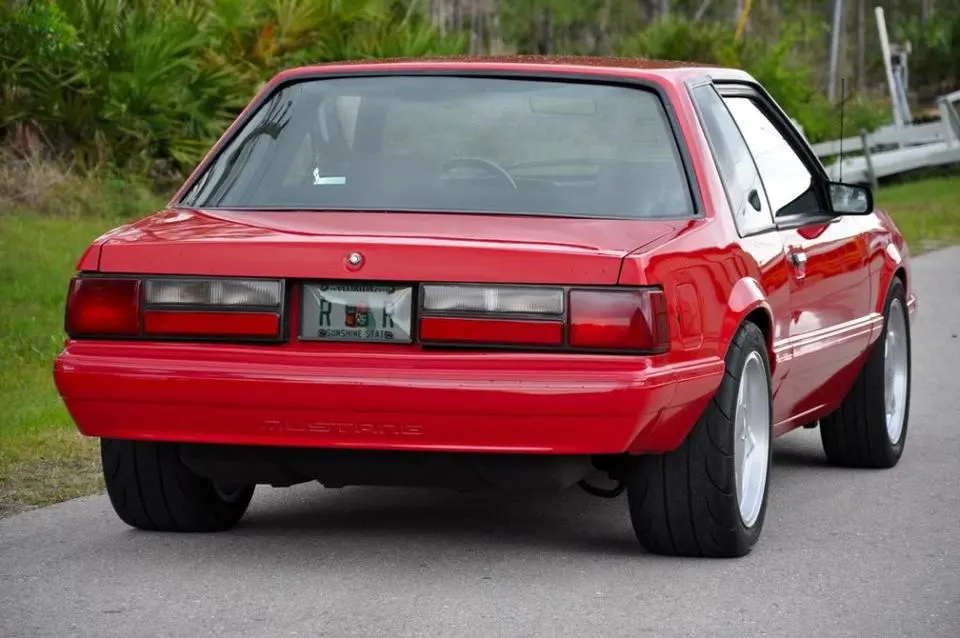

I ran 275/40-17 M/T DRs on 17x10 Pony Rs and they hooked like crazy on the street (with a few suspension mods). I think they looked good too. :)
