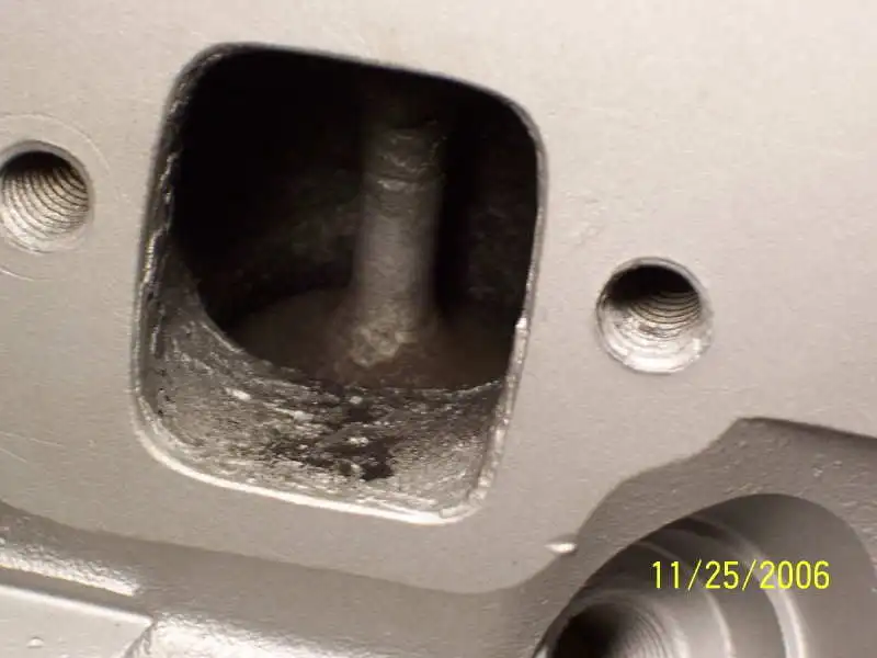

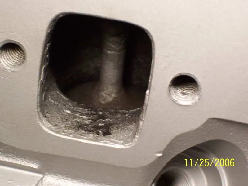

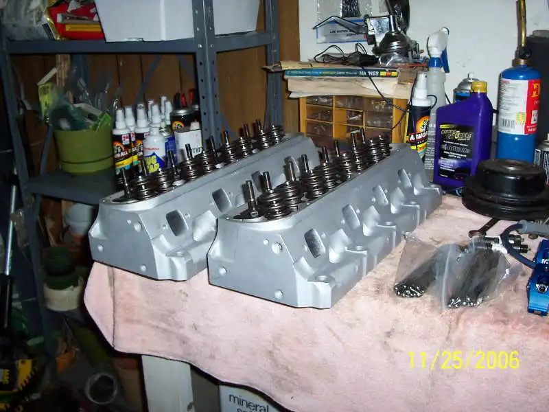

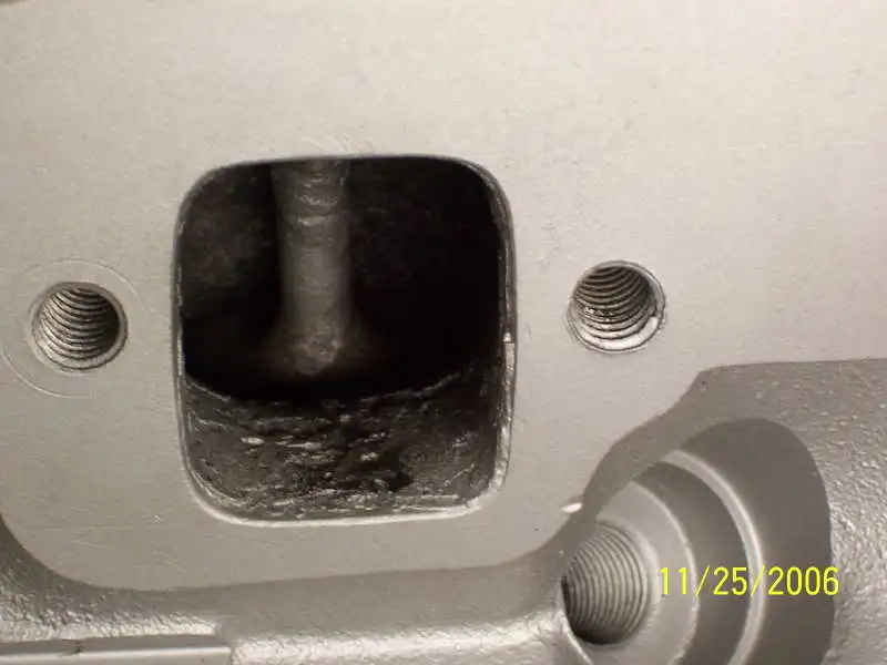

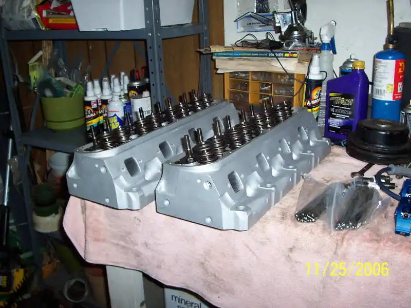

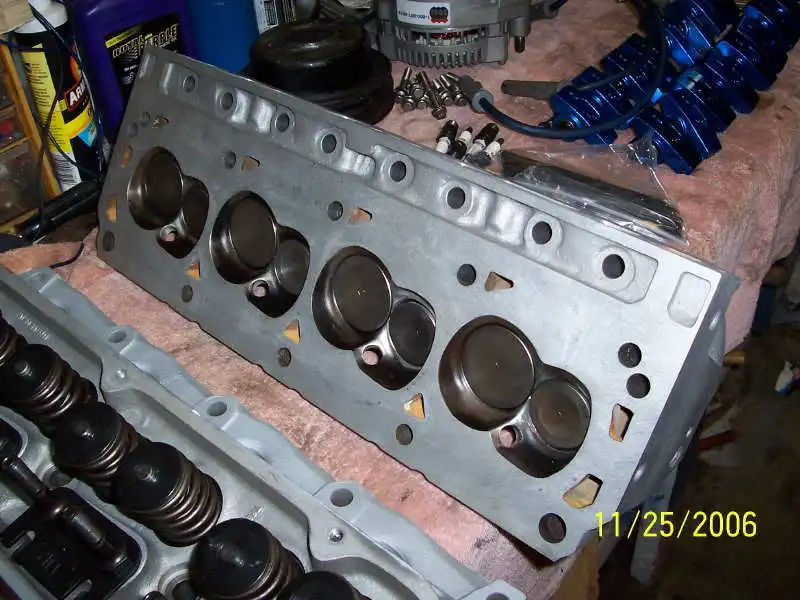

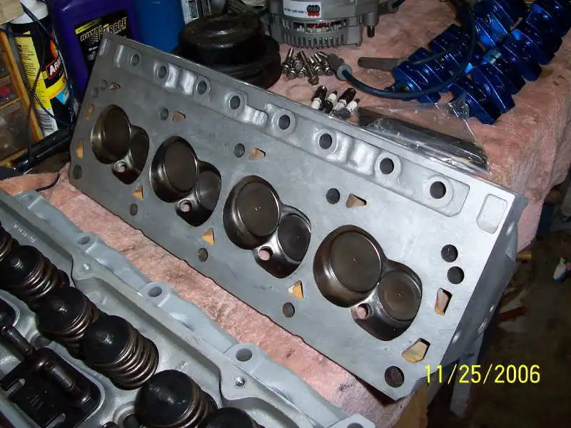

hmm, mine have dual valve springs and 1/2'' bolt holes, the seller said they have 3/8 rocker studs. ill have to go re-check that. but im pretty sure i have to get the reducer bushings/washers from trickflow.

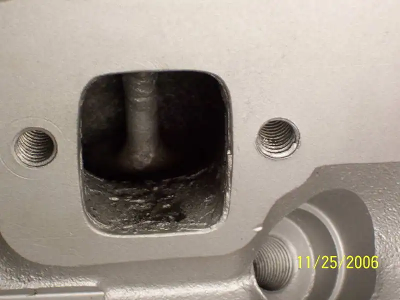

they came in last night, clearly no signs of O-ring grooves.
and does that look like carbon buildup or JB to you guys? its only on one port, but its also on the valve so im assuming carbon buildup?
