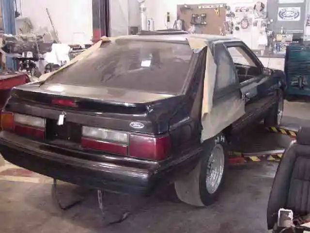

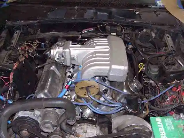

Ah, yes... the pic is attached of the preliminary building of the topend. Not that hard to get the intake on there! Another pic of the ride from behind. Going pretty far out with it, but keeping her looking STOCK for the street! :D
I don't have pics of the TT setup yet. Looking to put down around 550HP conservatively (trans capacity - built T5 - is right around there).
