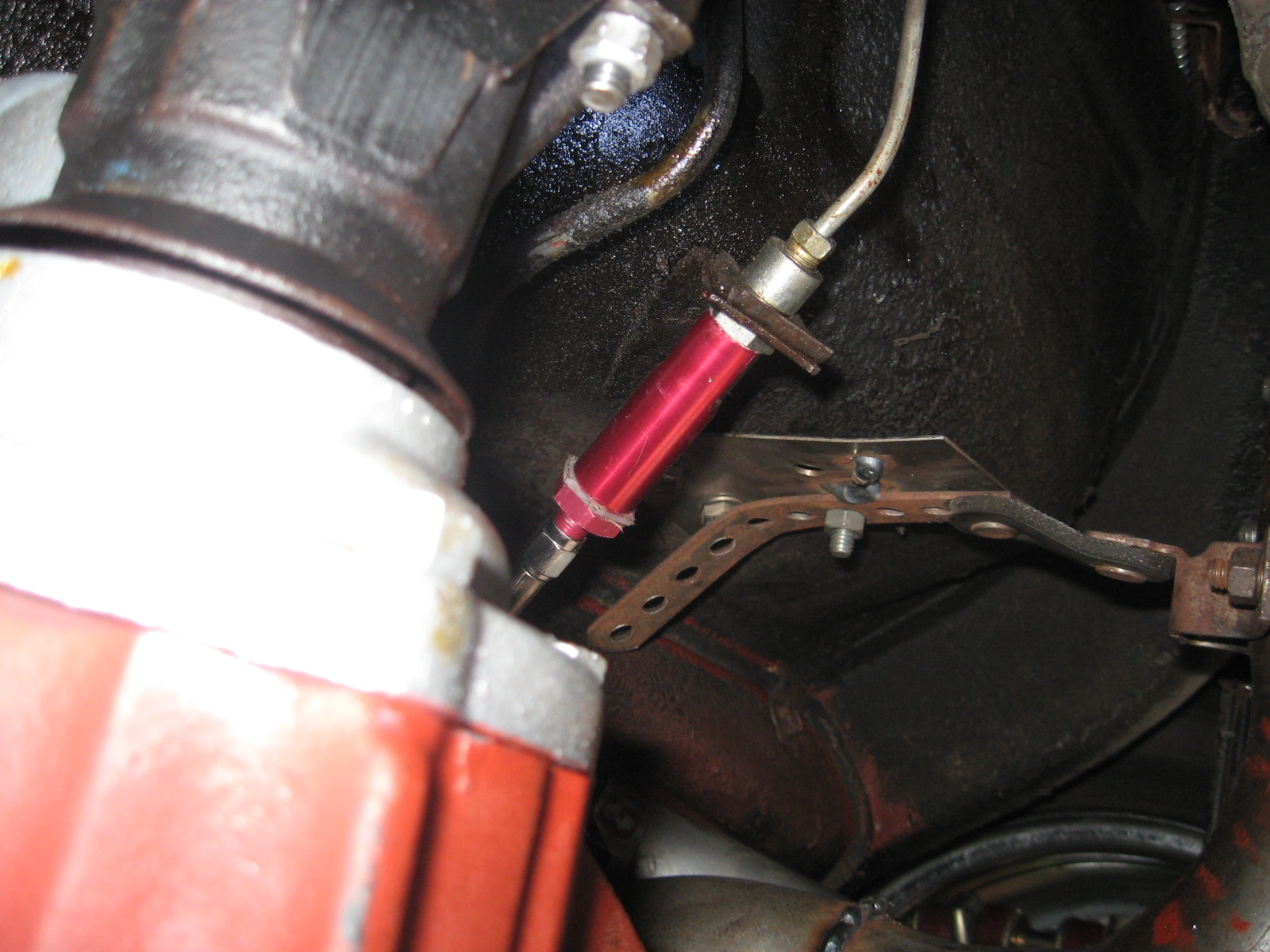

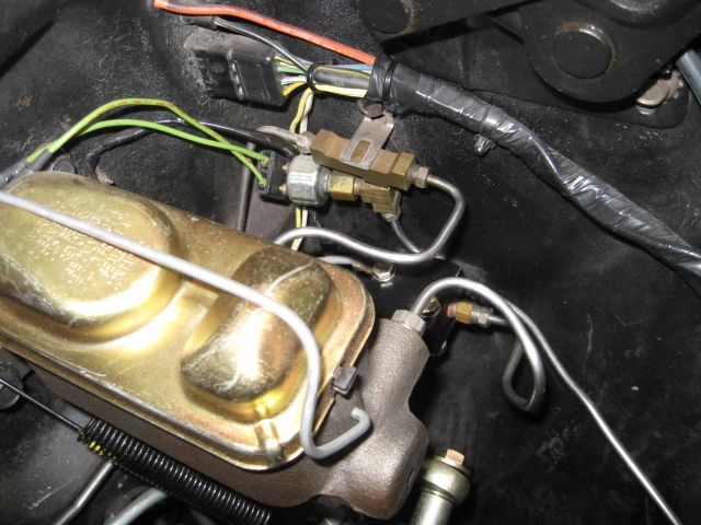

All of this aside, I plumbed an adjustable proportioning valve into my rear drums system way back (10 yrs.) when I did my resto. Knowing the front disks were getting 900-1100 PSI, I setup the drums to get about 600-800 PSI. This insures no rear lockups and has served me well over the years. I'm also running a residual valve installed at the rear axle distribution block. I'm running the larger 10 x 2.5" drums. The proportioning valve is that black box just under the M/C.

I've seen the distro blocks that have a residual pressure valve bolted to them. Some Mustangs/Cougars had the residual pressure valve located at the rear of the car where the hard line goes to soft line by the rear axle.

Yeah, that last comment although true, may or may not apply. For what this is worth, I'm running a 1" MC with a 10 lb residual screwed into the rear distribution block. After which, the rear brake line screws into it.
After inserting this, I simply re-bleed the rear brakes. First the right rear, then the left rear.
