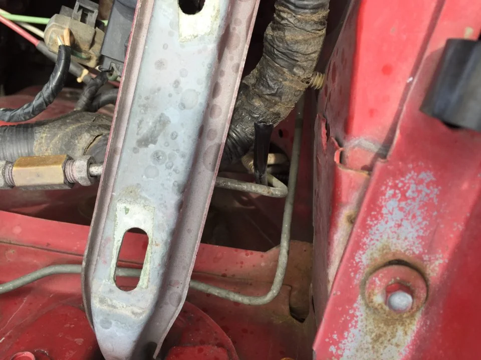

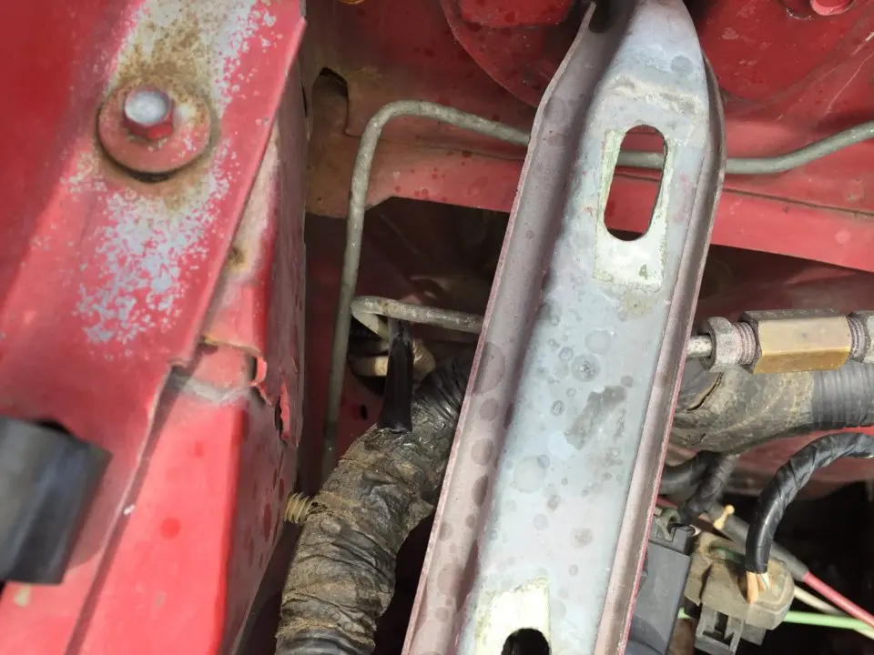

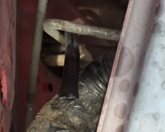

My TFI burnt up today and while troubleshooting I found this cut vacuum line looking thing. It looked clean around the top and there was spots around that area as if liquid had been shot through it recently... I'm curious about what it is because recently I've been smelling a lot of fuel and I'm wondering if this has something to do with it.

Was yours tucked away into a factory engine harness? I don't recall vent or vac lines being wrapped that way.
Anyone recall seeing hoses wrapped?
I don't think that line is coming from the harness. I believe it is cut and the cut end is sitting on top of the harness. The line runs back through the hole in the inner fender, along with the brake lines. Unless I am totally looking at this pic wrong.

Yes its not apart of the harness. It goes into the same area the break line goes into. Where does this vent line go to when not cut? It seems like fuel has squirted through it at some point and I have a feeling its the reason I've been smelling gas.
So I did some quick researching now that I have an idea of what it is and I'm guessing this is the line that would go to the charcoal can?
Good guess... Put another piece of hose on it so that you can blow air through it. Station someone at the rear of the car and take the gas cap off. Blow through the hose and have your helper listen at the gas filler for moving air...

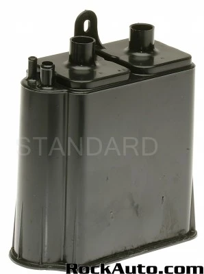

The carbon canister is normally mounted on the passenger side frame rail near the smog pump pulley.
Carbon Canister:
