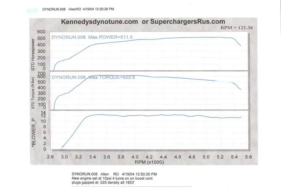

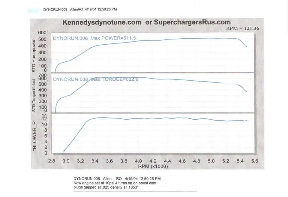

Info on the coupe is in my sig, these dyno numbers are with my old set up of Cobra intake and GT40 iron heads. Haven't dynoed with the new set up which is Hogan upper and Trick Flow lowers. Hoping for better #'s. Also on this dyno sheet was with the timing locked out at 20 degrees, I have since installed an XPI timing lock box ,now the initial timing is set @14 degrees and when the box senses boost it locks @18 degrees, big improvement, and I think that will help produce some bigger #'s.

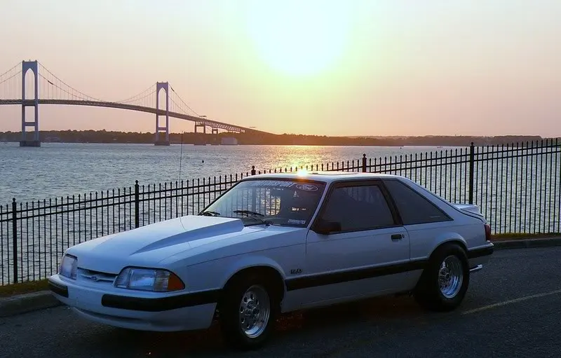

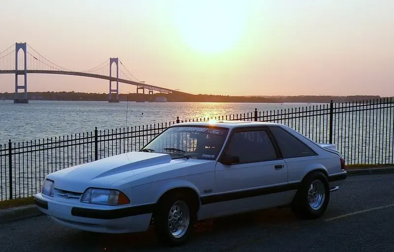

Stock bottom end
E Cam
AFR 185's with the 1.53 OD spring upgrade
Professional Products Upper and Lower
24 lb/hr injectors
73 mm mass air
70 mm TB
1 5/8 BBK coated longtubes with 2 1/2" exhaust
MSD Digital 6 and billet distributor
320 wheel hp
Best ET/Speed of 12.71 @ 109 at Gateway in St. Louis

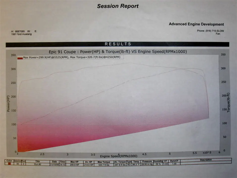

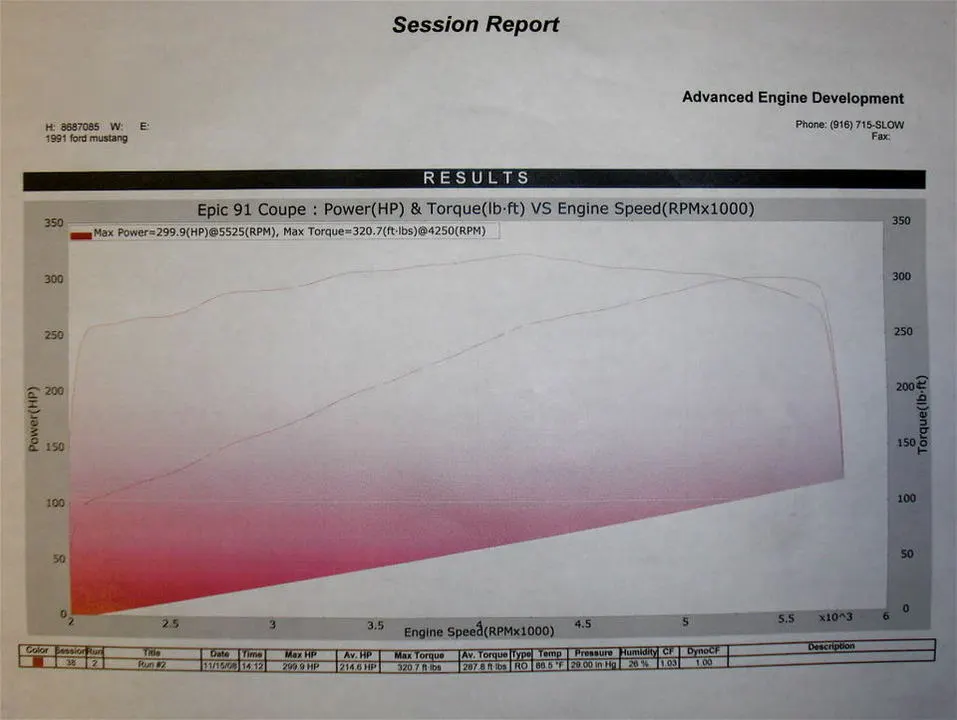

=Stock bottom end
=Edelbrock Performer 2.02/1.60 heads (slightly ported)
=1.6 rockers on the intake & 1.72 rockers on the exhaust
=E cam
=Edelbrock RPM II (slightly ported)
=BBK 70mm TB
=BBK fuel regulator
=Mac cold air
=underdrive pullies
=AC delete
=1 5/8" LT's (Mac I think??)
=o/r X pipe
It put down 299.9rwhp & 320rwtq on a dynojet untuned. It still has stock injectors, stock fuel pump, & a 93 Cobra Maf, so it did lean out a bit on the top end. I will be adding 24# injectors, C&L maf, & a 255lph pump soon. Due to the huge manifold, it isnt much on the low end, but pulls like a raped ape from 4000-6000, even with crappy 3.08 gears. Once I build a bottom end, I will install a better cam, but with the 2.02 valves, PTV clearance is slim, so anymore of a cam would cause problems...
