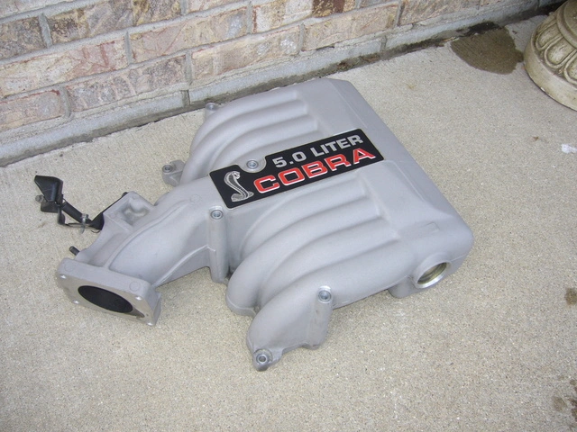

My 89 big block is fast enough that I don't like driving it on the street, so my 95 gt doesn't have to be crazy but still improved on the original specs. I like the appearance of the stock or ford manifolds, I would go to a 93 Cobra Manifold If I knew of a way to make it fit, need some sort of elbow adapter.
Like this?

good advice, the elbow looks like this...and they offer a polished one also...
94-'95 Mustang Professional Products Satin Intake Elbow Adapter
