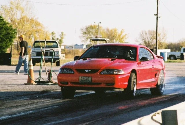

I've got 3 pairs of the 17x9. Street tires on 4 and Drag tires on 2. I've thought about ordering another set to have them narrowed. But man does that sound like an expensive route. Any wheels out there that would look okay? I can get other wheels powdercoated black to match.
Thoughts? :shrug:
