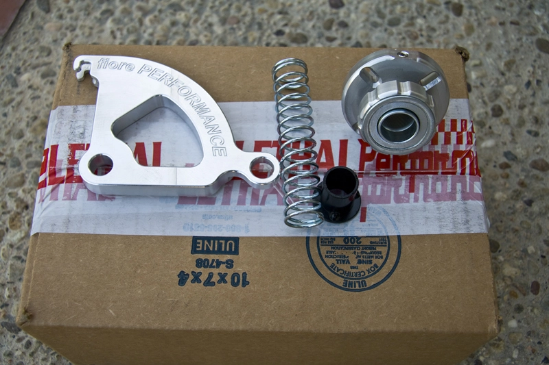

I'm gonna go with the fiore stuff. now how much is an oem cable from ford? do I have to do anything to the oem cable to make it work with the aftermarket firewall adjuster?
and where is this return spring that is mentioned? I installed my buddied MM quadrant and don't remember any spring

Fiore Quadrant & Adjuster+LDC Clutch Freeplay Mod FTMFW!!!

I would also like to know what this return spring is/does? IM getting about 1-1.5" of free play in my clutch pedal:-(, so im thinking that this is the cause as to why my pedal vibrates on deccel sometime between 1-2K RPMs. My setup is Blue Anodized FRPP firewall adjuster/ MM quadrant. The FRPP adjuster is nice! Id say same as fiore, cause it also has the locking 1/4 turn mechanism! PLus i got it for $37 from the local Ford Dealer. Drivetrain parts have less than 5k miles also, for those that might be thinking its my clutch causing the vibration. Parts were all installed by a mustang junky:nice: with the stock quadrant but I disliked the high engadgment on clutch so just recently upgraded to the above aftermarket goods
