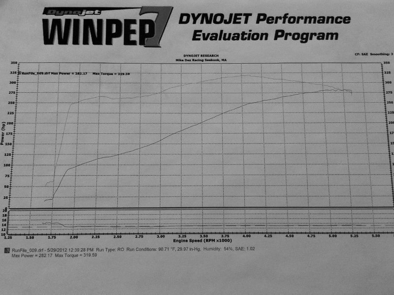

here is the dyno sheet ...
shop said it was breaking up at high rpm
possible detonation in one of the rear cylinders
decarbonized the system and it helped they said, recommended a griffin radiator to help as well
