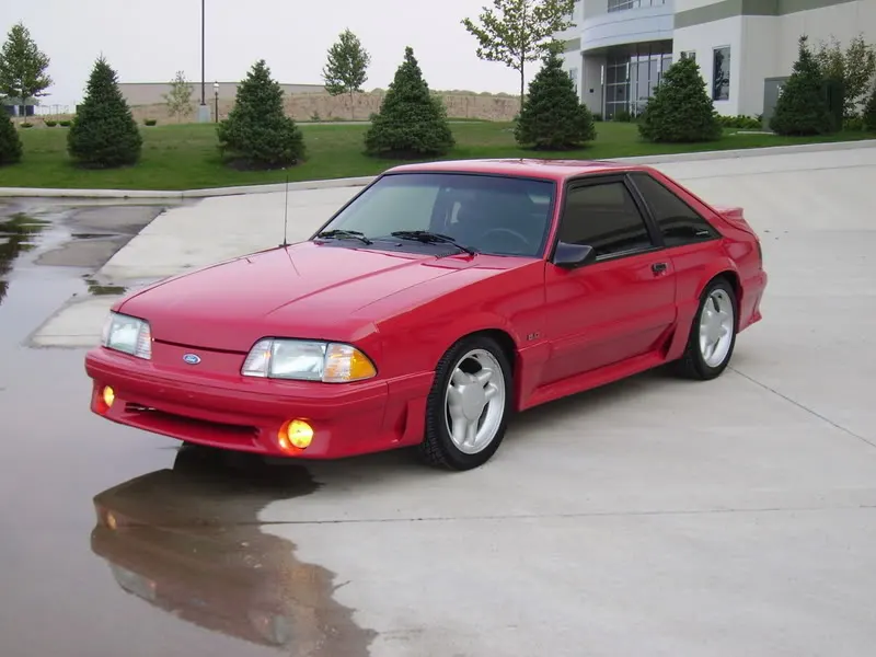

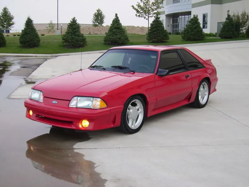

245/45R17. They fill things out very nicely and have no rubbing issues.

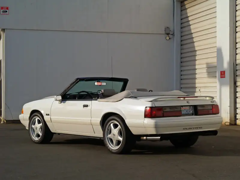

I have 245/45/17's all four corners, there is some rub on the front at full turn, but not enough to worry about. They fill the fender well perfect. I may change to 255's on the rear when I buy new tires. Forgot the say that I ahve 93 cobra wheels also.
Same here on the 235s/275s. Had 245s on the front but they rubbed at full turn like Anaconda was describing (although mine was enough to worry about)
**Should probably mention I did have to take the lip down on the inside of the fender so it wouldn't gouge the 275s but thats it, still running my quad shocks even tho I probably don't need to but they don't hit so why mess with them.
