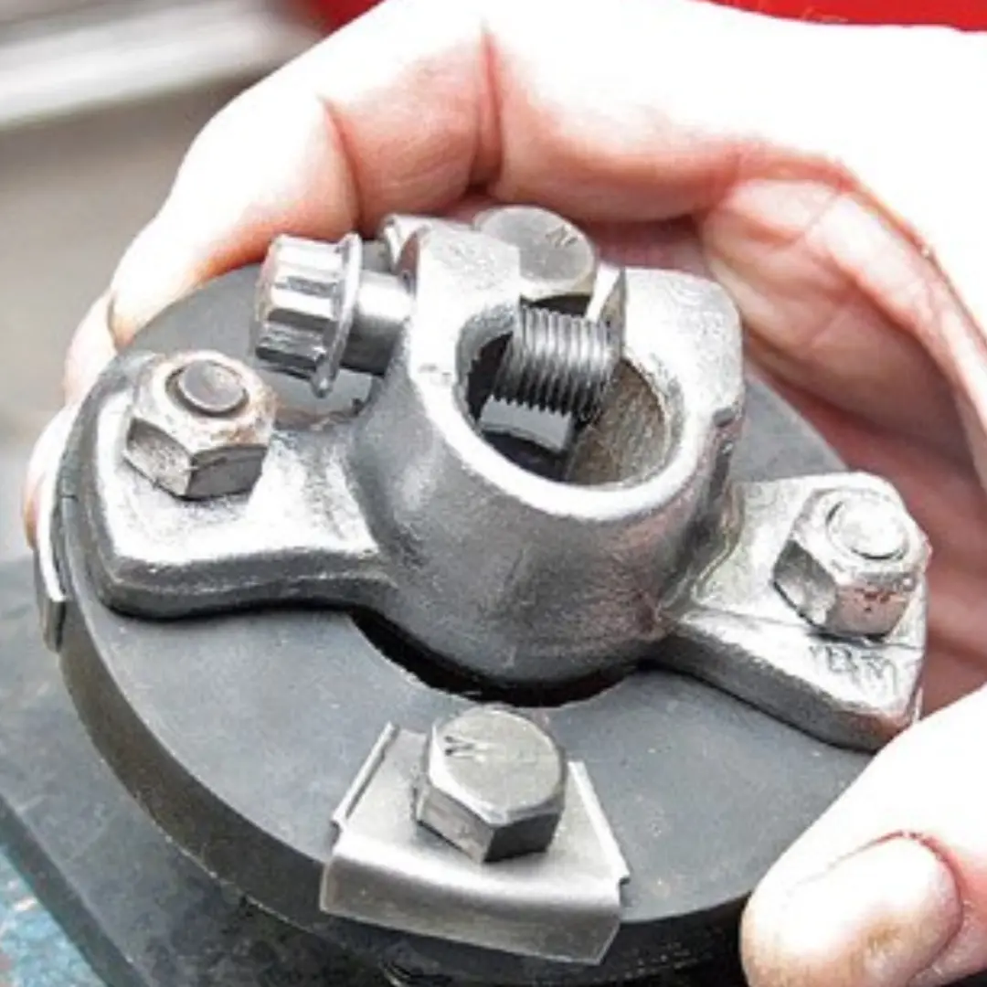

I'm replacing the rack and pinion and need the size of socket to remove the nut holding it to the steering shaft by the rag joint.

Are you talking about the 12 point bolt that's in this picture? If so, it holds that U shaped clamp on the splined shaft of the rack. I don't know the size but as mentioned 12mm is close. It can be tough to break loose where the splines are. Spray some PB Blaster in the joint where the splines are. After sitting long enough to penetrate into the fitting you can tap it upward with a hammer and heavy chisel or whatever you have. The rack will have to be moved forward as it comes out because it only goes upward a little bit. Hope I'm describing what you need.
Only way to get at it is underneath. Jack up front end and move the steering wheel until it’s in a spot to get good access at it. Once you have it lined up it’s not too bad to get off
