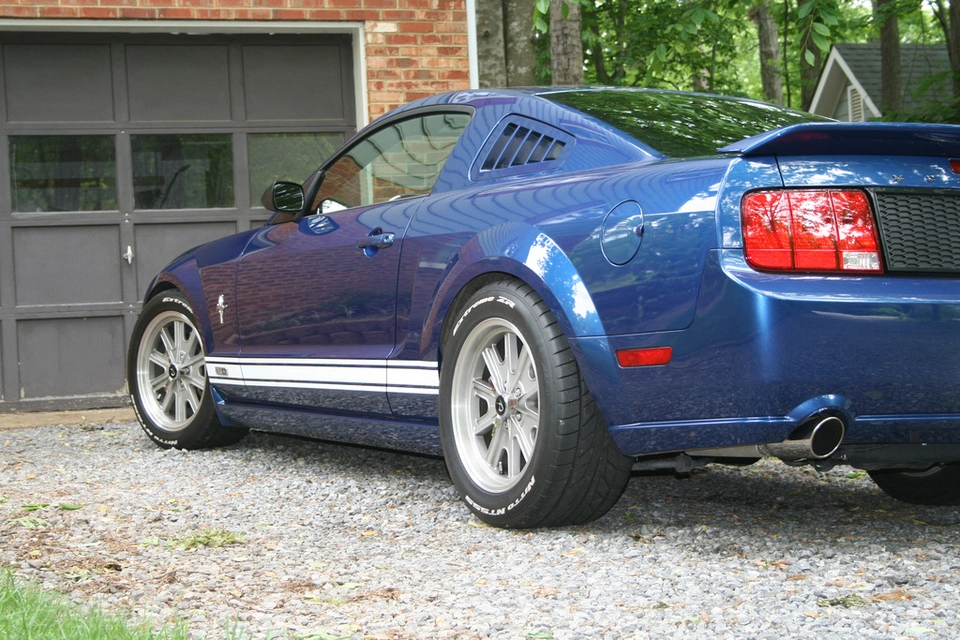

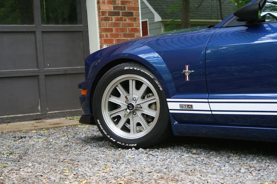

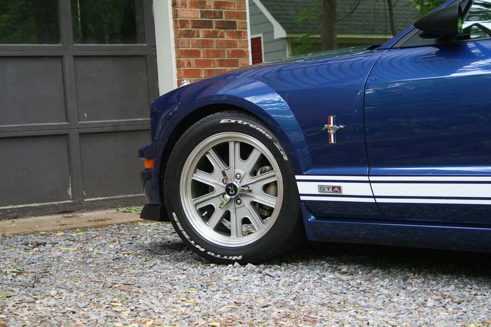

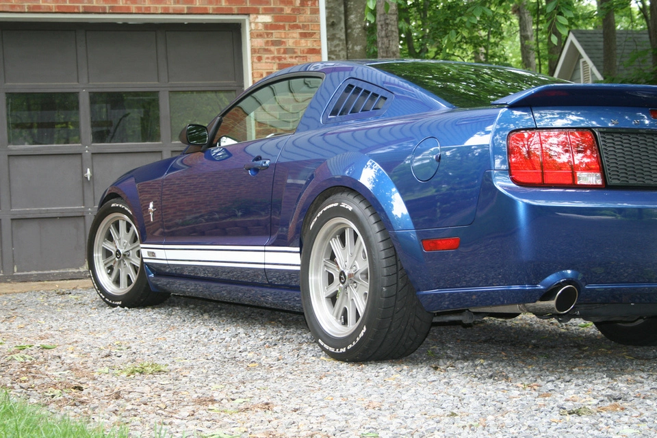

Not the Goodyear, but here is the 255/45-18 Nitto 555NT on 8.5" wheel.
