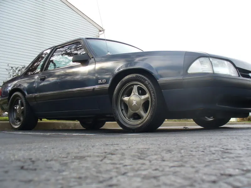

I run 225/50-16 up front and 255/50-16 in the rear with no rubbing issues. The car has been lowered about 1 1/2 all around.
pics:
