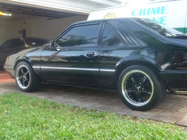

I have h&r sport springs with bilstein shocks. 17x9's up front gave me some rubbing issues so I have 17x8 front and 17x9 rears. I was happy with the ride quality.

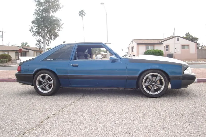

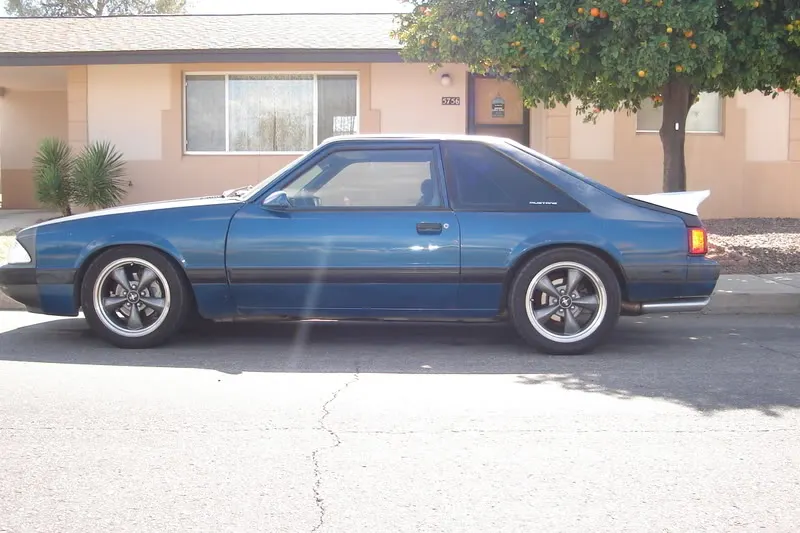

I have very slight rub up front if I hit a bump mid turn. I have no isolators on the car. It has 98 spindles so the wheel is pushed out .25 farther as well. It only rubs the bolt head that holds the inner fender so Im not worried.
It's kind of hard for me to tell if 17x10.5s would fit out back because I have SN95 length axles in the back. 25th has 18x10s in the rear and they fit good though. I have had 17x9s up front before and they would rub at full turn, so if you can get ahold of a 17x8 in the style that you want you should try and pick that up.
Actually the quality wasn't as good as I had expected. I got the product from Steeda and for the price that you pay for it you expect it to be flawless. I got the hood and rear bumper from Design Concept and since they are cheap, I expected the hood and bumper to need some work, but that wasn't the case.
I think that the finish is good on the wing, but it is the fit that isn't that great. After I put it on the right side stuck up about a half inch off of the hatch and the screw that goes down through the wing and hatch didn't line up. Also on the front side of the wing it sits up off of the hatch about an eigth of an inch. It is not super noticeable, but it bothers me enough to want to do something about it. I think that it was worth the money mainly because barely anyone has one and they look great, very subtle. Thank you for the compliments.
