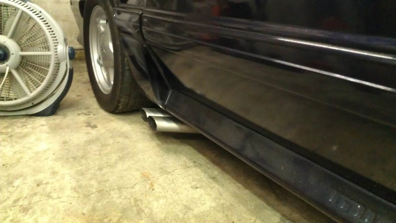

I have Eibach Pro springs and am using a ZR 245/45/17 tire on my mustang. I have the Flowmaster American Thunder system with the 2 1/2 polished stainless tips and have no rubbing issues.
When I use my 255/50/16 drag radials I did have a problem with a slight rub on one tail pipe and I dimpled the pipe slightly and it did not rub any more.

245's and 255's are nothing, run pretty much anything you want IMHO. Just be prepared to re-route the fuel lines where the passenger side tailpipe upright comes close to them.

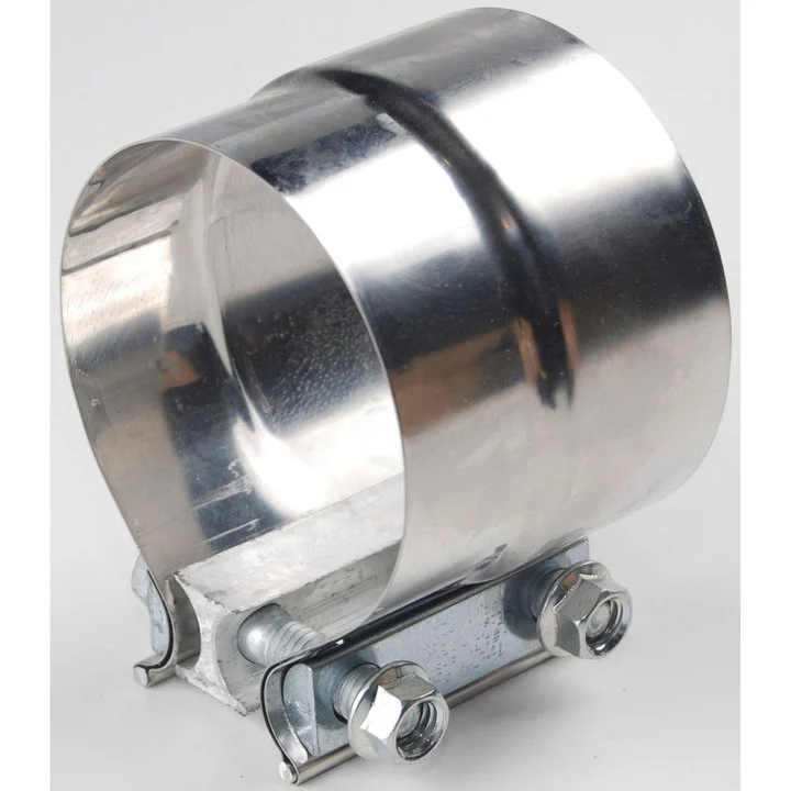

My only issue with the pipes above is they say they need to be welded??? I'm not into letting other people work on my car and i dont have a welder... has anyone successfully used band clamps on the above pipes?
I have 255/50/16 on the rear, lowered, with 2.5" tail pipes and the only time the tires rub the pipes are when I'm doing donuts. I can live with that.
I would imagine welding would be ideal, but band clamps would work just as well. Based on the pics of the pipes, there seems to be plenty of area to work with them at the connection.
i was thinking i could take my cut off wheel and run about a 1.5" long slit length wise to give the pipe an area to "close up" slightly when using a band clamp on it so it would be clamped very securely to the mating pipe?
Perhaps....I guess you'll have to see how close they are when bought. You can also buy stepped band clamps to miss matched pipes that will do the job.
I used these band clamps when I installed tailpipes on my LX a few months ago. I bought these tailpipes http://www.americanmuscle.com/mustang-tailpipes-8697-v8.html. I only have 245's on the back, but obviously didn't have any problems with clearance.
Took me one adjustment but they fit great and I don't have any leaks. I was able to piece together my whole system (h-pipe, flow tubes, mufflers, and tailpipes) and get it all installed without leaks. Based on MFE's suggestion I used some muffler/tailpipe sealant at the joints just to ensure a leakfree system. I like the fact that I can take the whole system apart without cutting it, as you would have to with a welded system. Also, since I pieced everything together, I got to choose what components I wanted since I couldn't find a catback system with everything I wanted.
