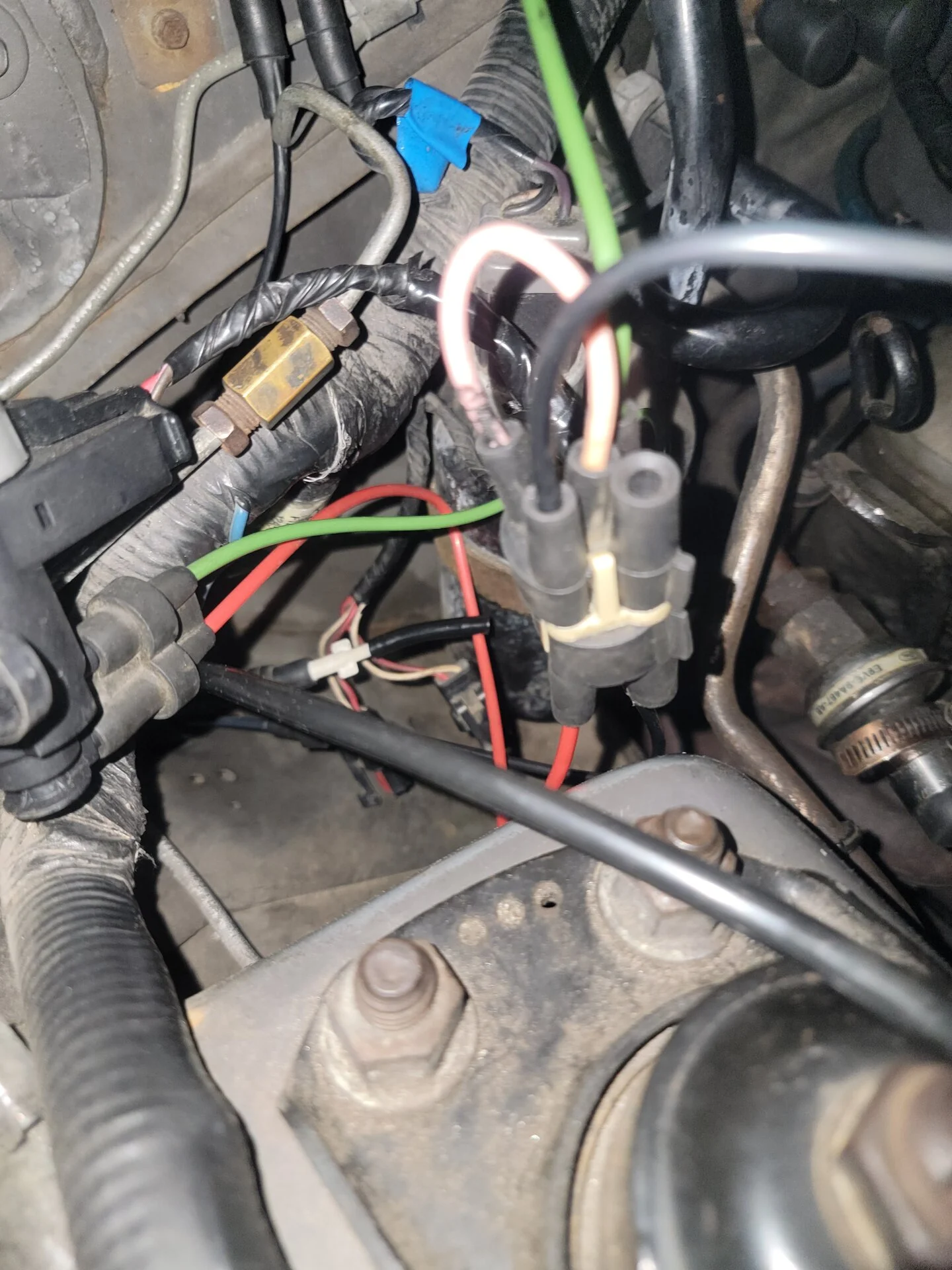

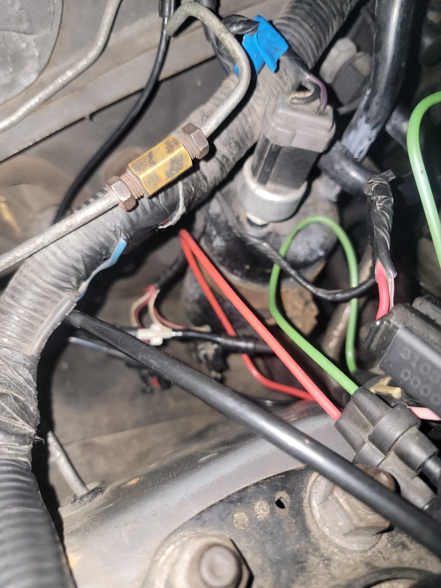

I'm new to mustang's I'm 40 I always wanted one all my friends had them growing up now I got one 20 years to late lol but I love it nothing beats the sound of a foxbody mustang and any mustang I'm trying to learn and ask questions I confuse my self with what I ask everyone like this vacuum EGR leak I have I can't figure it out fix this problem and u can Pat yourself on back lol
I’m glad to try to help, especially if I am not typing nonsense. And obviously, so are many others here.
Do you have another thread started on the EGR vacuum leak?
yes I get alot of laughs at me cause I just don't understand what part is what I'm at my car have a look I'm sure I blocked off stuff I shouldn't have,so no smog pump new EGR and this vacuum mess you will see
A lot of that stuff was pulled off for track use when I rescued my car. It runs better with it back in place.
It it your car we were seeing this unfortunate problem recently on in another thread?
It it your car we were seeing this unfortunate problem recently in another thread?
ya I had alot of message and diagrams sent to me and something's I understood and others I don't this being my first mustang and me watching to many YouTube videos
