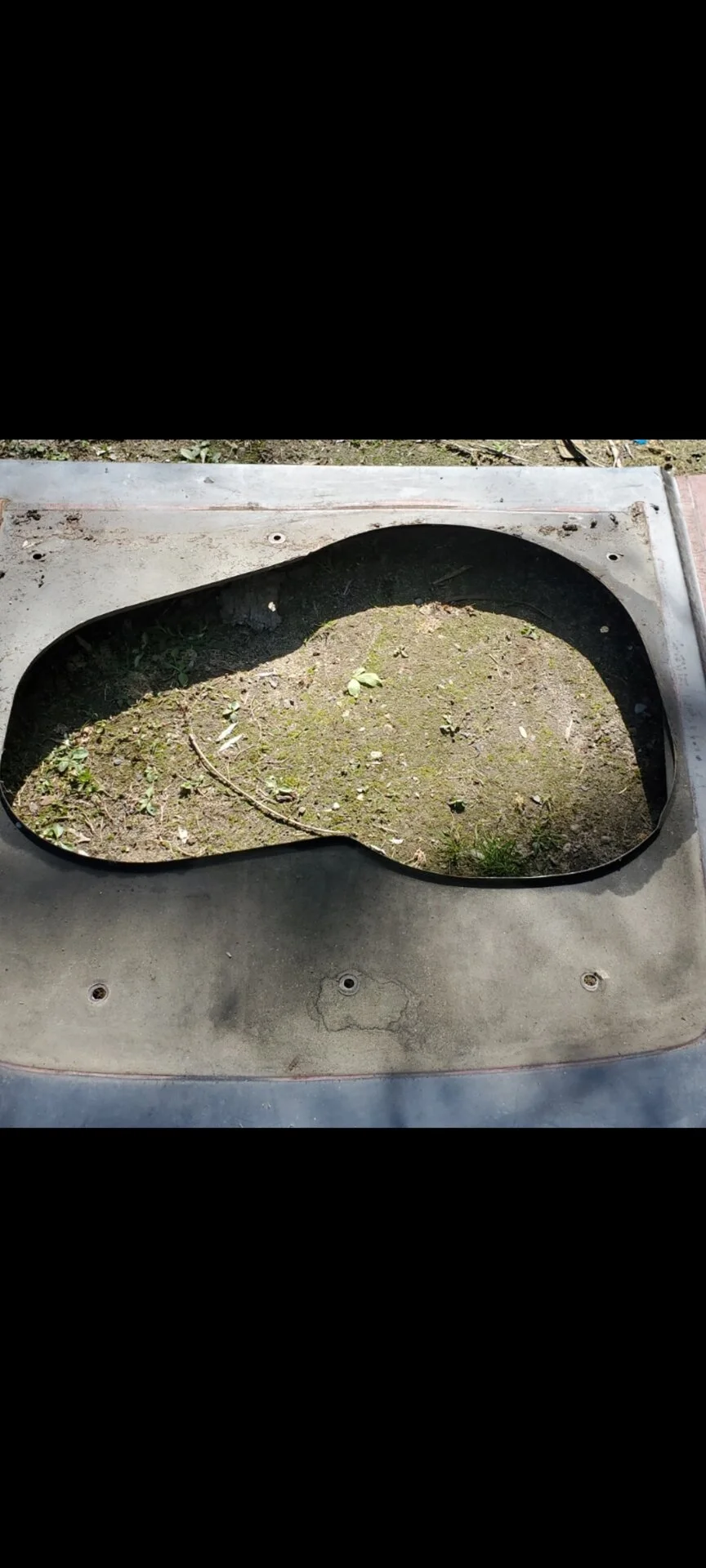

was I asking in here about my 83 gt hood scoop that was put on backwards to act as a ram air for the carb and I wanna use it for heat to escapes and I plan on putting on my 91 gt I made a template to figure out where I need to drill and cut not sure if anyone has done this would love to see pictures sorry if it's the wrong topic

I added a factory scoop to my 79. I measured and marked with masking tape where the air cleaner stud was straight across to the fenders. I removed the air cleaner housing and stud, and found where that line centered on the hood. I had a thick poster board pattern of the scoop with a circle of the outer edge of the housing needed to be for clearance. Then I drilled the holes for the studs and cut a big circle out of the hood with a jig saw. The circle was over four layers of masking tape and the saw foot was taped for scratch avoidance.
As early Fox hoods were easier to find than now, so I just almost chickened out, and kept my shorts clean.
It looked stock unless it was next to a GT and you looked very closely. For a backwards install, I’d follow the same process. The clearance hole could be smaller for vent holes.

I'll post mine in a few I just have the pic of the hood it came off of
