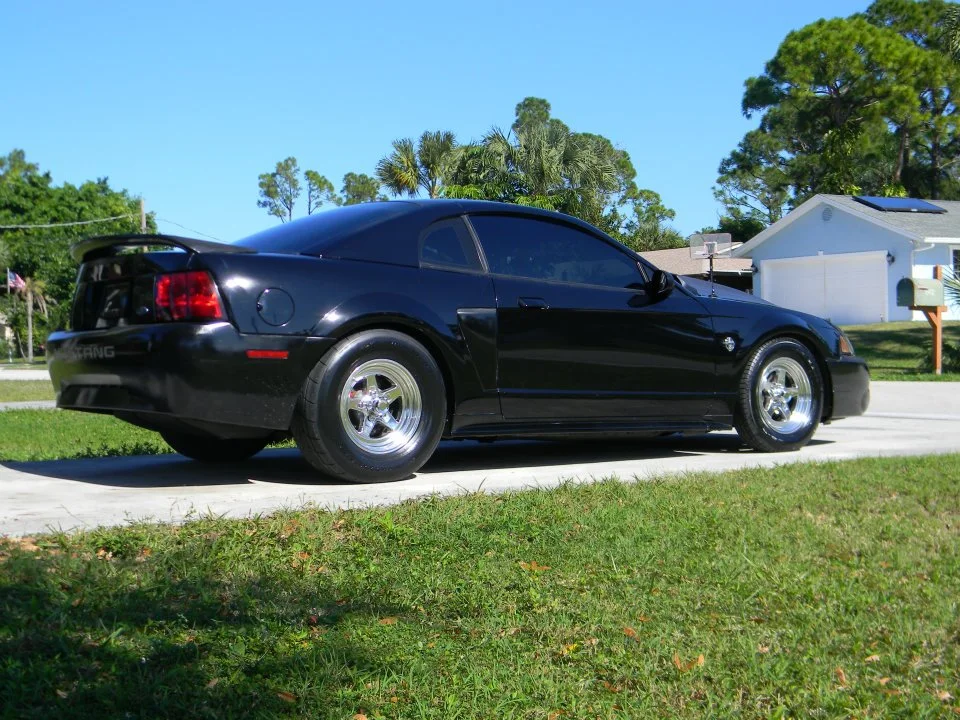

I have 17x9 cobra r's on now with 245' in front and 285's on the back but I want the drag setup now. I just got a 5inch cowl and want to throw 15x8's or 10's on the back and skinnies on the front. I'm liking the race stars right now. They have a 17x4.5 for the fronts which I think would look pretty tough with some fat tires on 15's for the back.

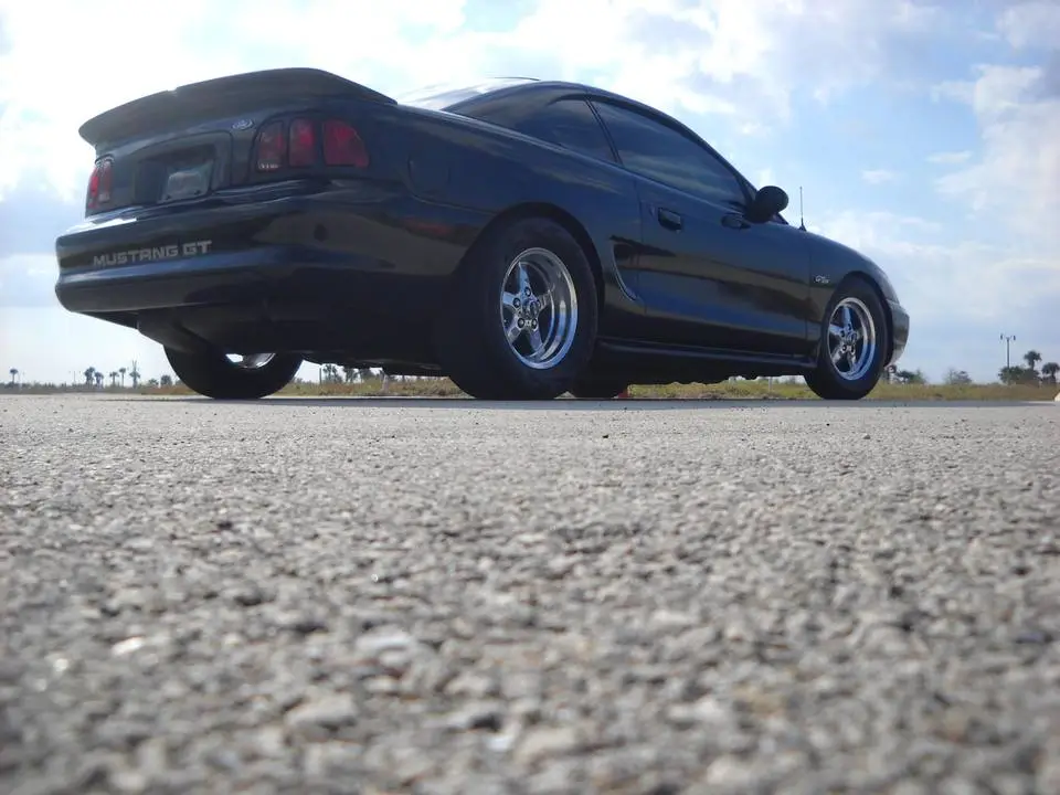

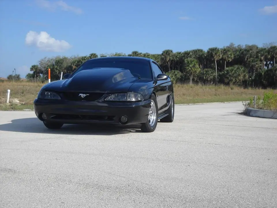

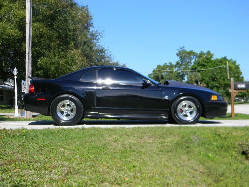

Im running a 275/60/15 on the back to gear my car down a little bit, and my car is slammed! cant tell you how low but probably lower then yours.
And to answer your question i have a 15x8 with 5.5 inch backspacing on the rear, but i believe a 94-98 can clear a 15x8 with a 4.5 inch backspacing, if i were to do it again id go 15x10 with 6.5 inch backspacing

Looks real good! Perfect for want I'd want. Would like the 15x10's too but don't want to be spending so much for the bigger tires. I go through them pretty fast. Any brake clearance issues? Did you have to put spacers for your fronts? And what size tires are you running on them?
If your planning on going with a 275/60x15, that tire can fit a 15x10 perfect, no need for a bigger tire then that, and as long as you have stock GT brakes you can fit the fronts without spacers. 165/80/15 Nexen sb802 is your best tire for the front for street use. Ride great and wear great.

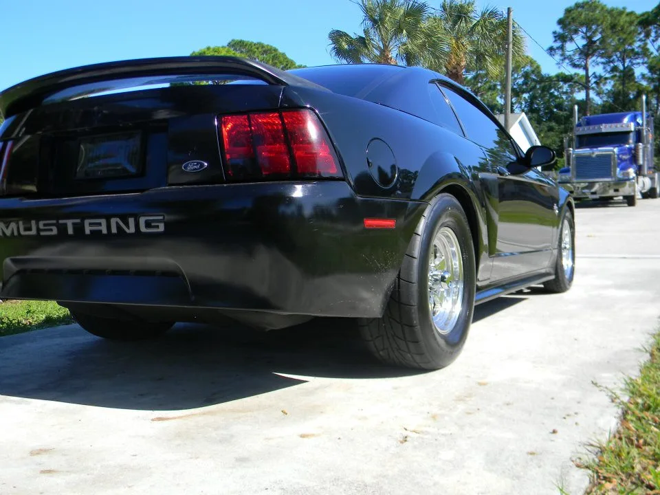

I was wondering if you happened to have a picture from the rear of the car?

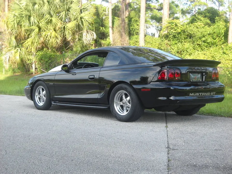

i dont have a great pic of the rear, here what i have
when ii first put the wheels on
