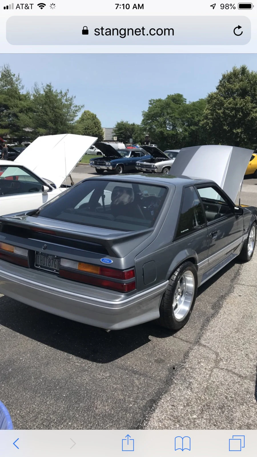

255/40/17 front
315/30/17 rear
SC Reps. 17x8 front / 17x10 rear
ARP studs with a 1/2” Baer spacer. Bilstein quads. VERY tight tolerances but all fits. Have QA1’s set pretty high so she doesn’t move much. No rub unless a really big dip with wife and daughter in car. Then it’s ever so slight. But I LOVE the way it looks, so I just deal.
