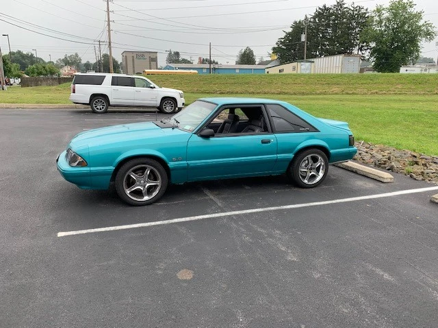

I have the BFGs, don't love them, but really have nothing to compare them with. No straight line traction. @kendawg73 , Nitto makes a 285 in the G2 line which will probably be a better fit than the 275. Anyone else make a 285?
I ran 255/40-18 fronts and 285/35-18 rears. Zero mods to the front and they were fine. Rolled fenders in the rear and no quads (I have MM HD lowers) with no problems. 18x9 wheels all around. Best looking setup I've ever had on the car.

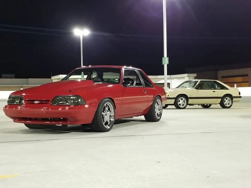

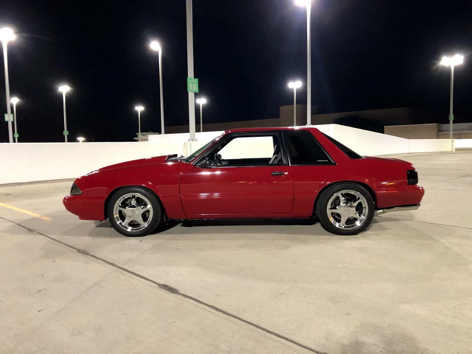

Will the 275/40's on 17x10 rims on the rear fit with just flipped quads or will they rub the fenders if not rolled?
mine fit but i had to remove the quad shocks.
Reactions: DemonGT
I'm running Maximum Motorsports lower control arms, stock upper controls arms and a Maximum Motorsports panhard bar and they told me to just remove the quad shocks so I did. I haven't felt any decrease in handling or traction and have no rear tire rubbing issues with 255/40/17 in the rear.
Reactions: DemonGT
They will fit with the quad shocks flipped. I removed mine per my post.

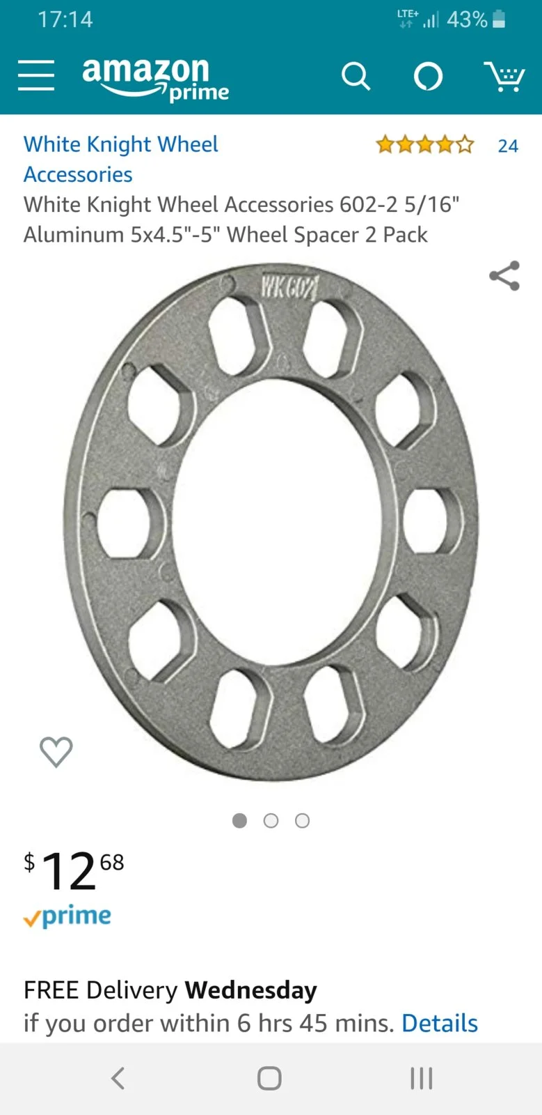

You can also add a small spacer to pull your rear wheels out (aligned with your fronts). This will ensure no rubbing.
