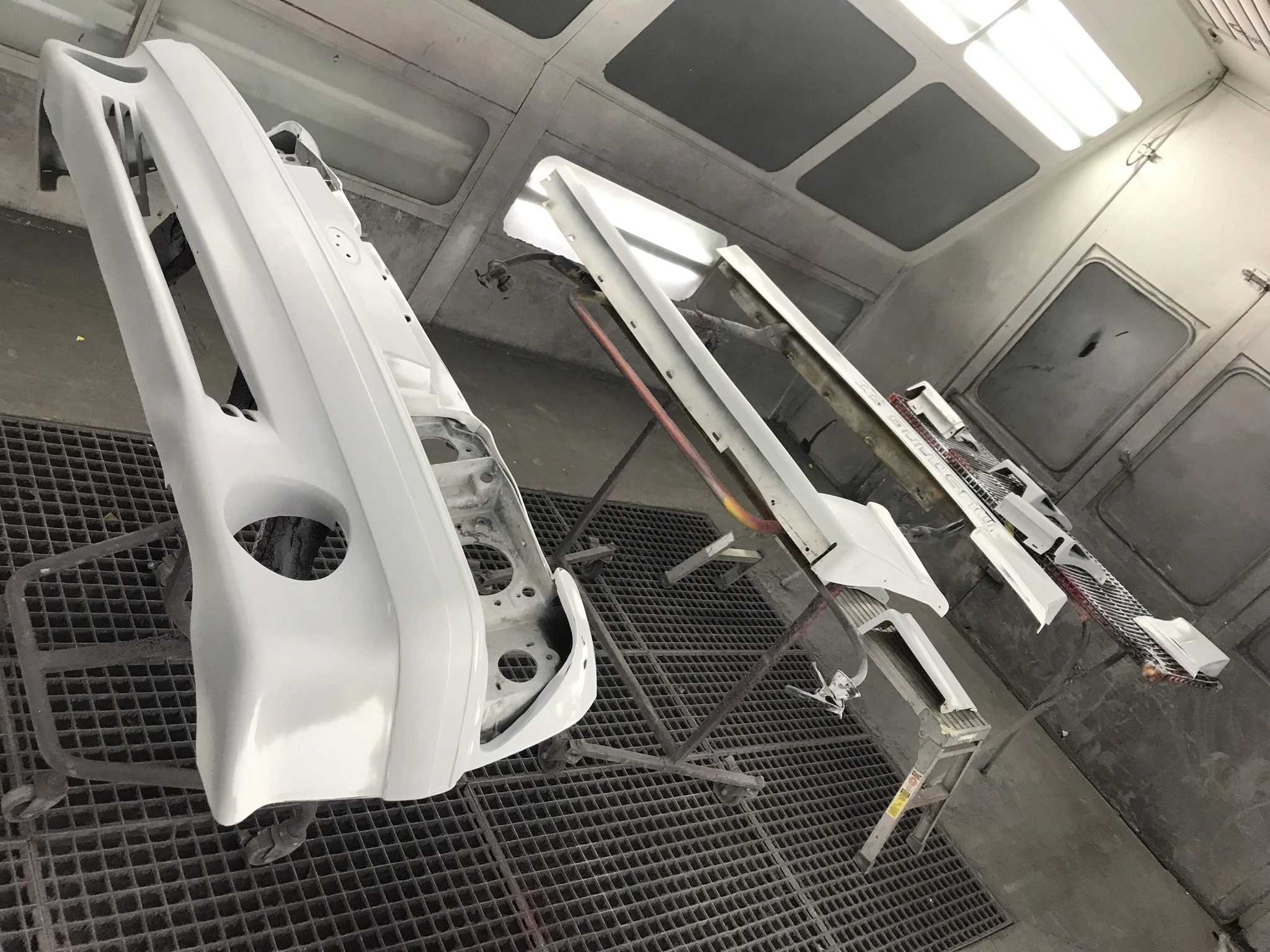

I would request that they remove the front and rear bumper wraps and paint them separately. That would also go for all the ground effects.

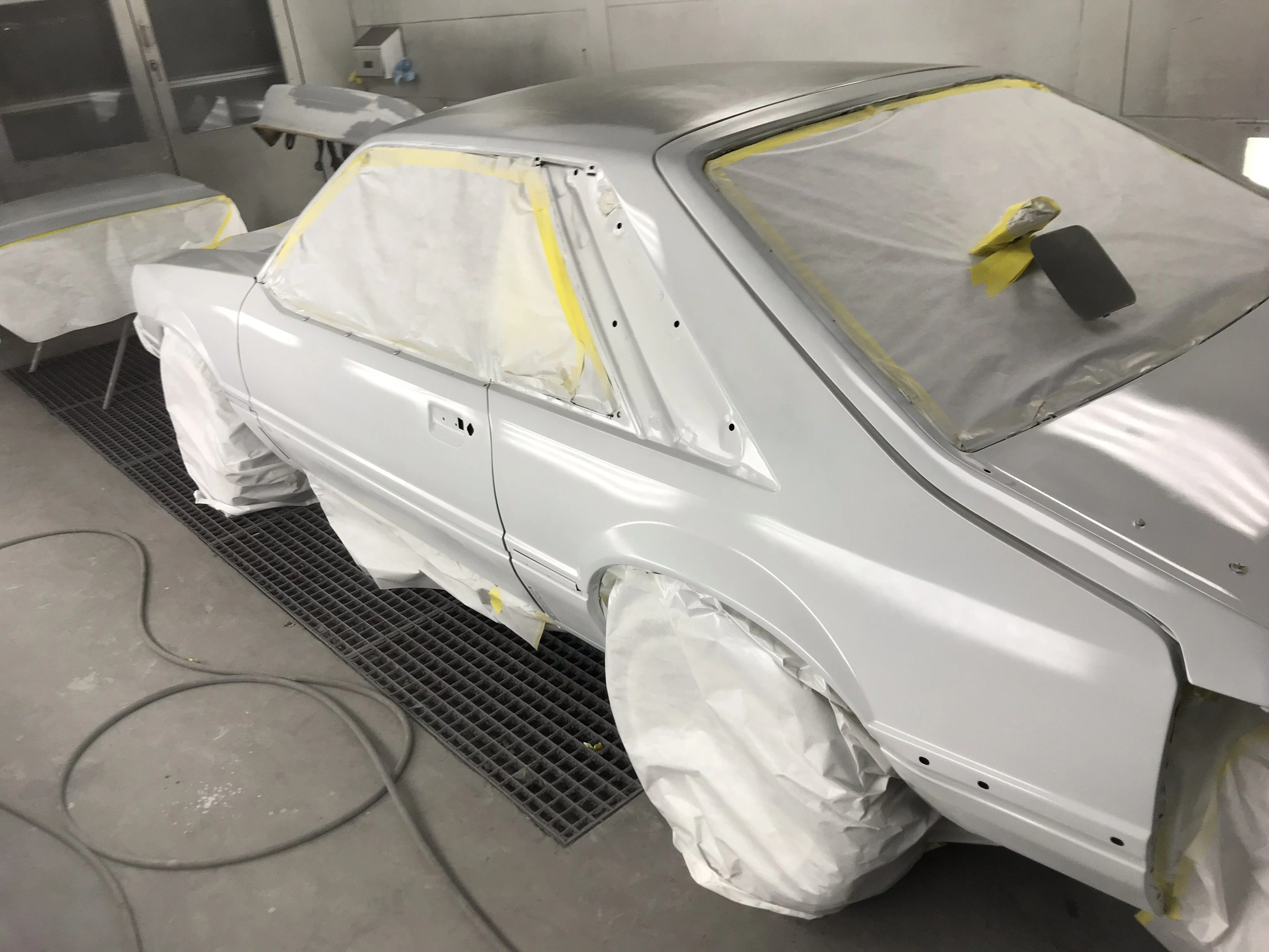

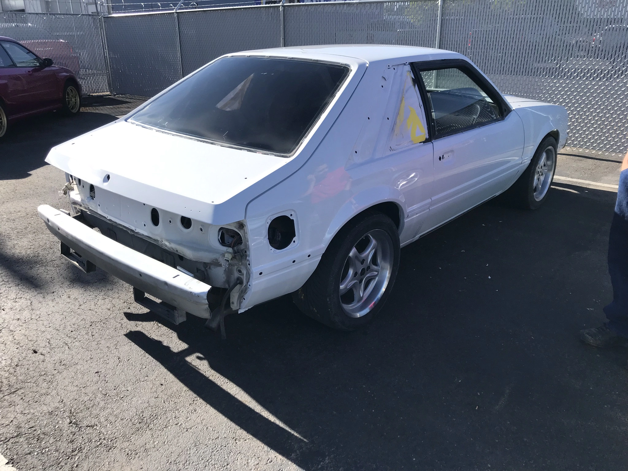

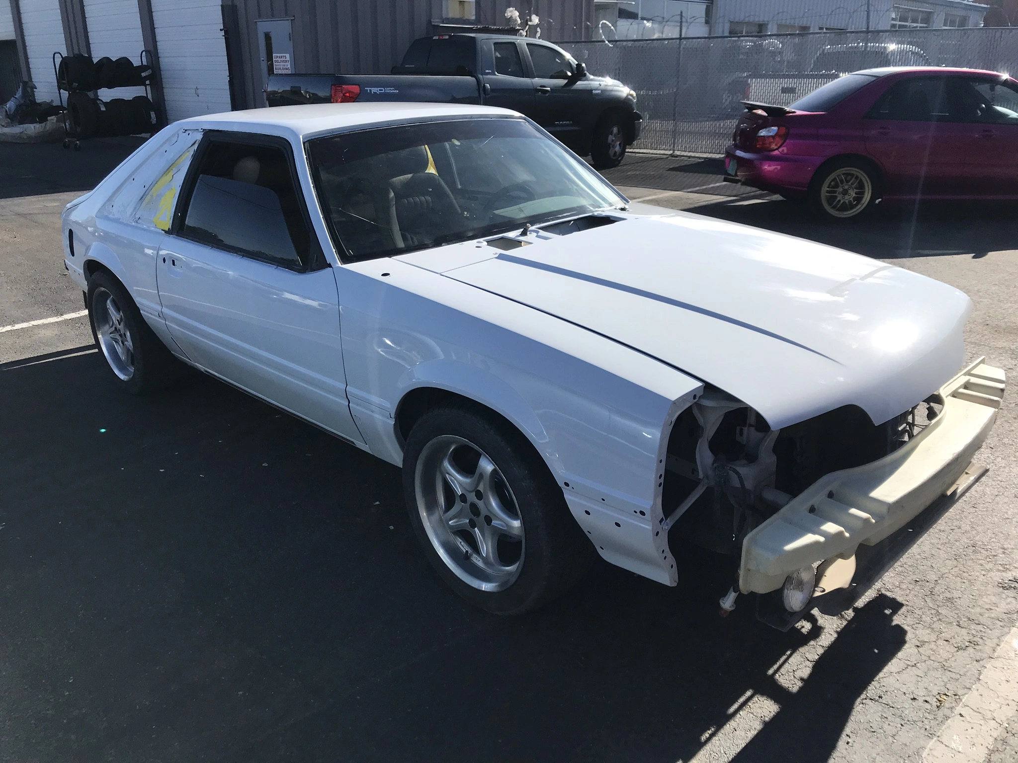

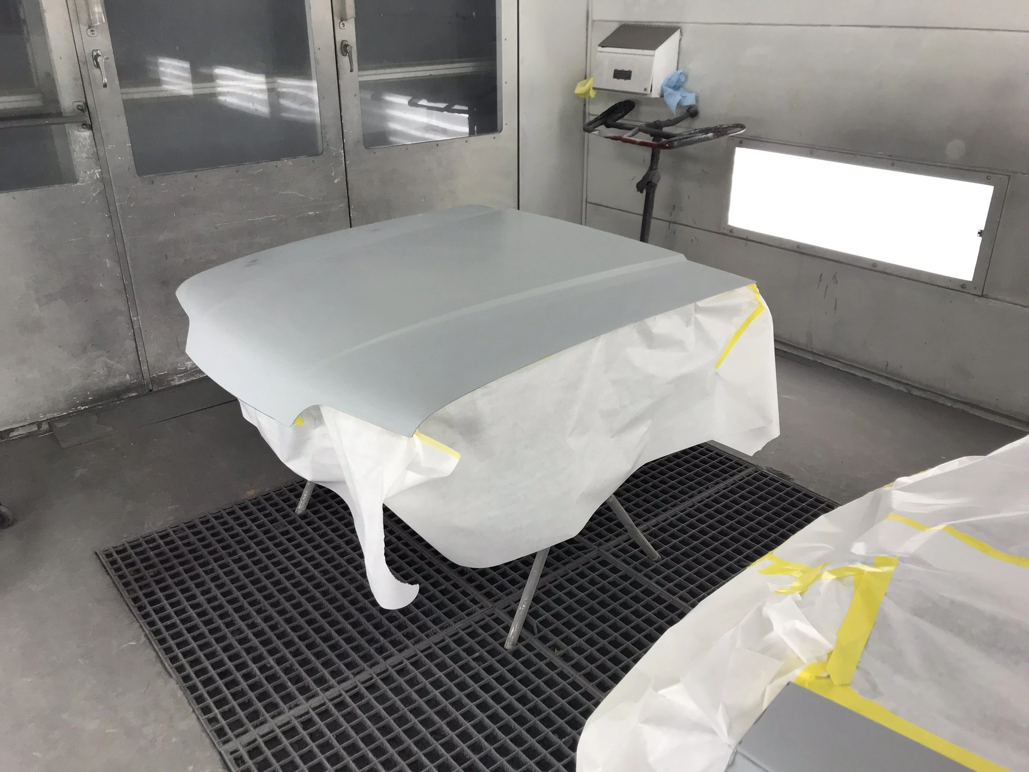

It should be in this state when it goes to the shop .. this was a color change so it came apart further once there(doors, fenders, bumpers, hatch...)

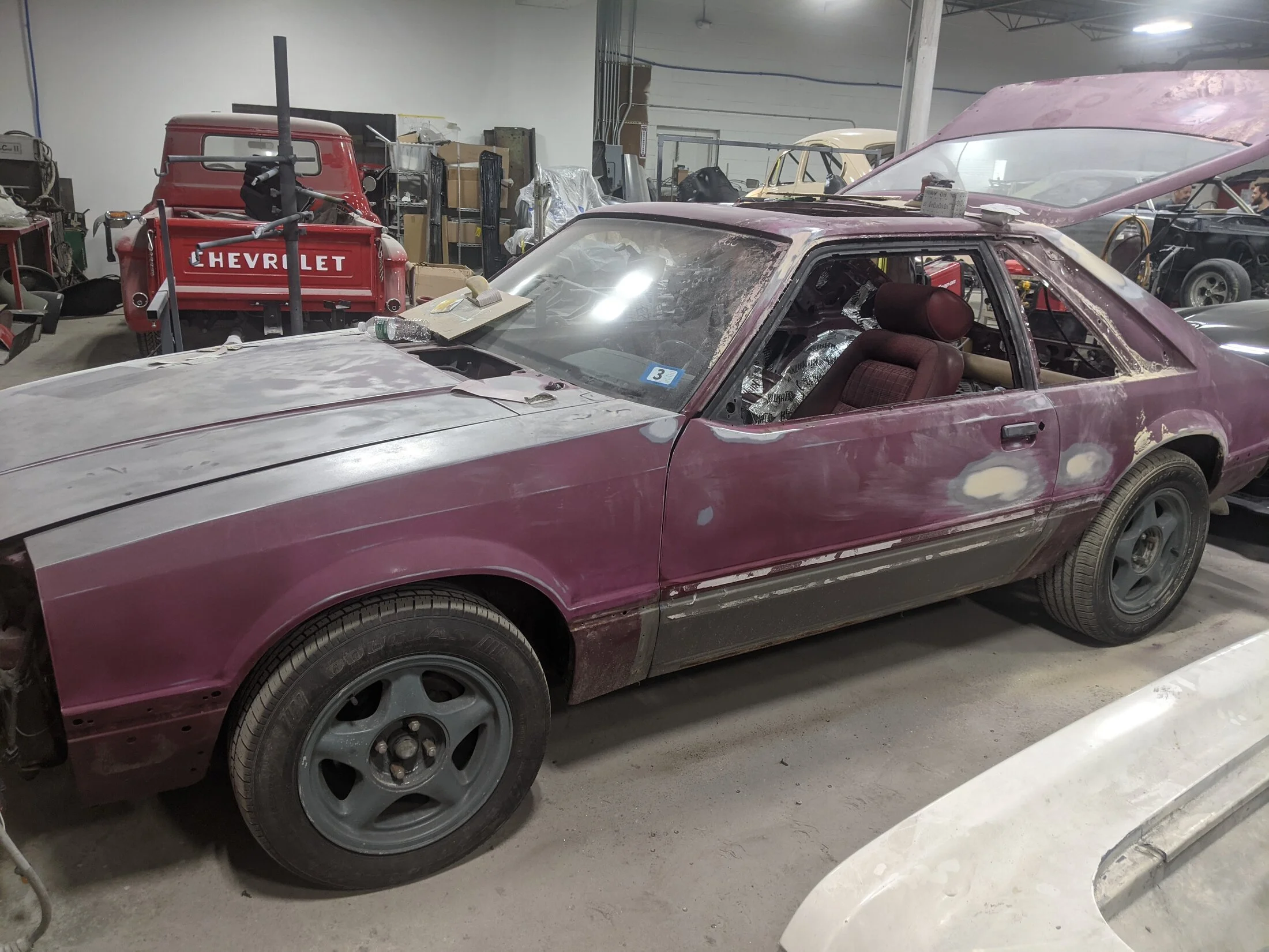

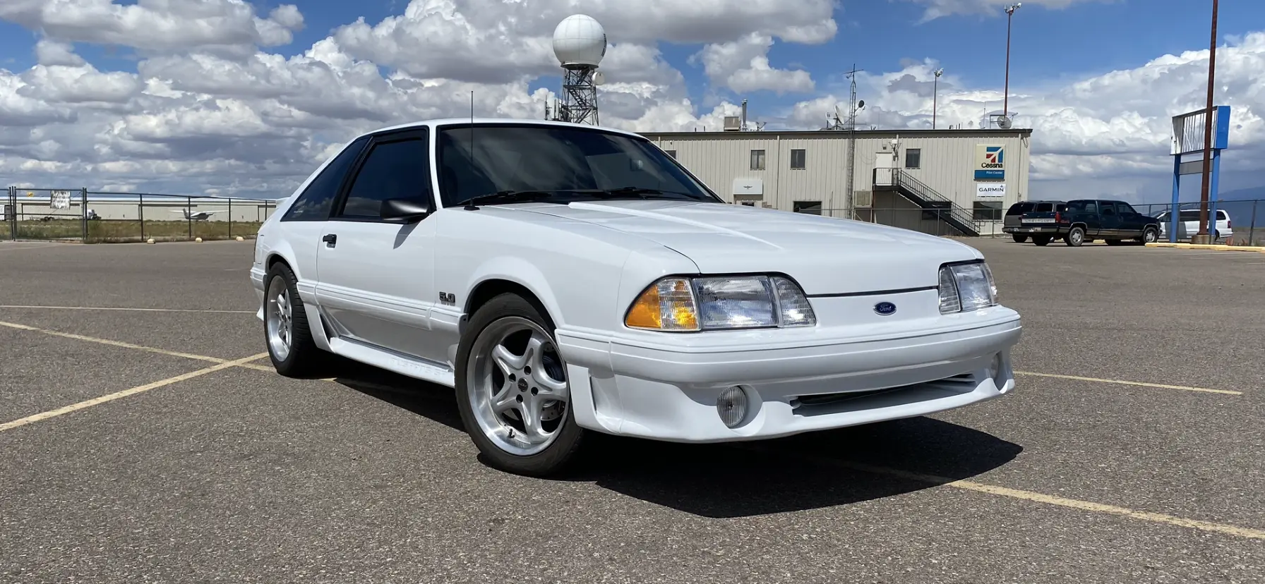

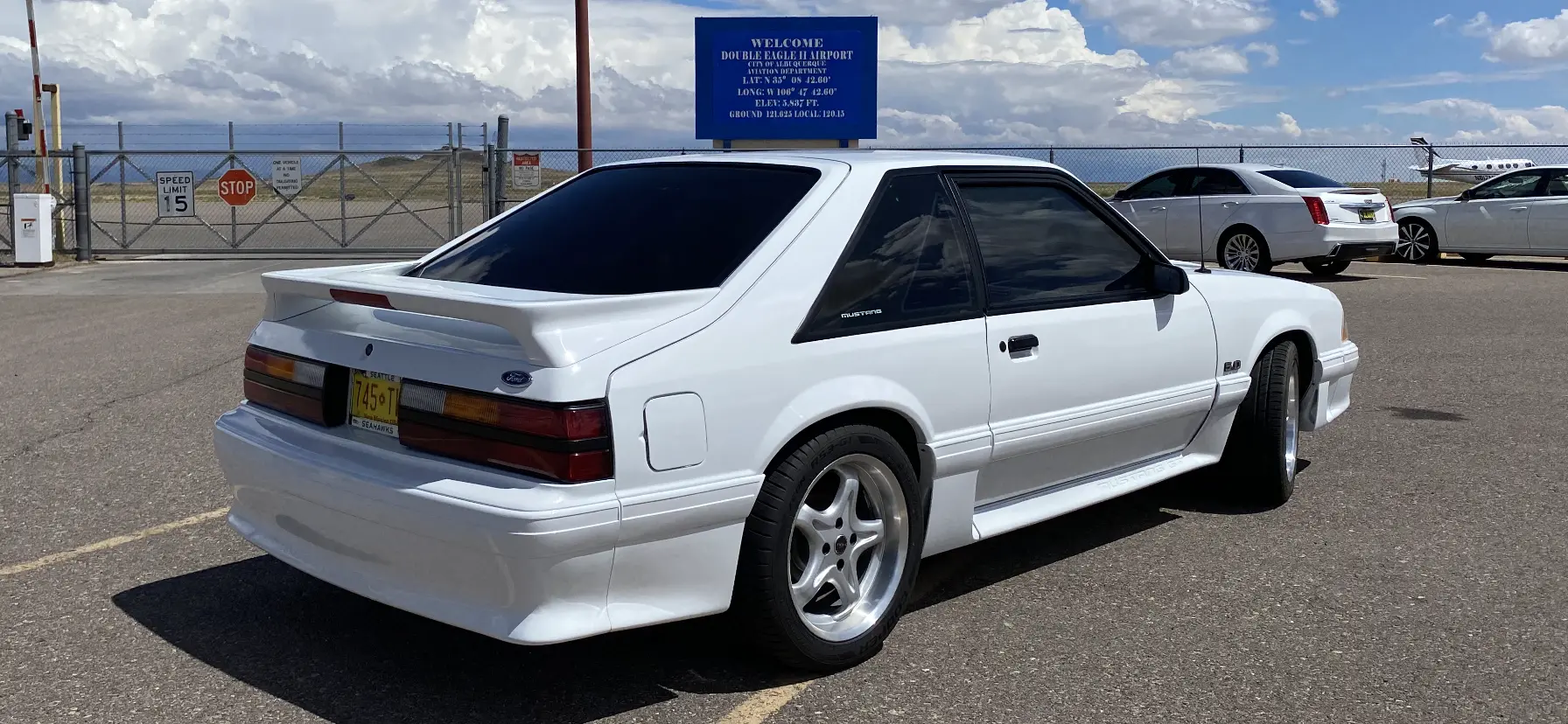

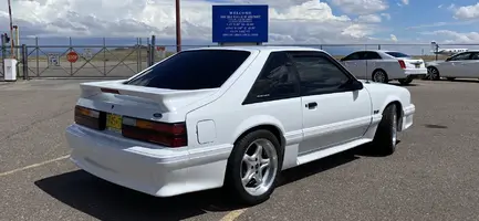

Here’s mine when I painted it. Going on 5 years now. That should give you an idea. Pull the door handles off as well.
You might want to consider your rusted frame rails before you get into something like this.

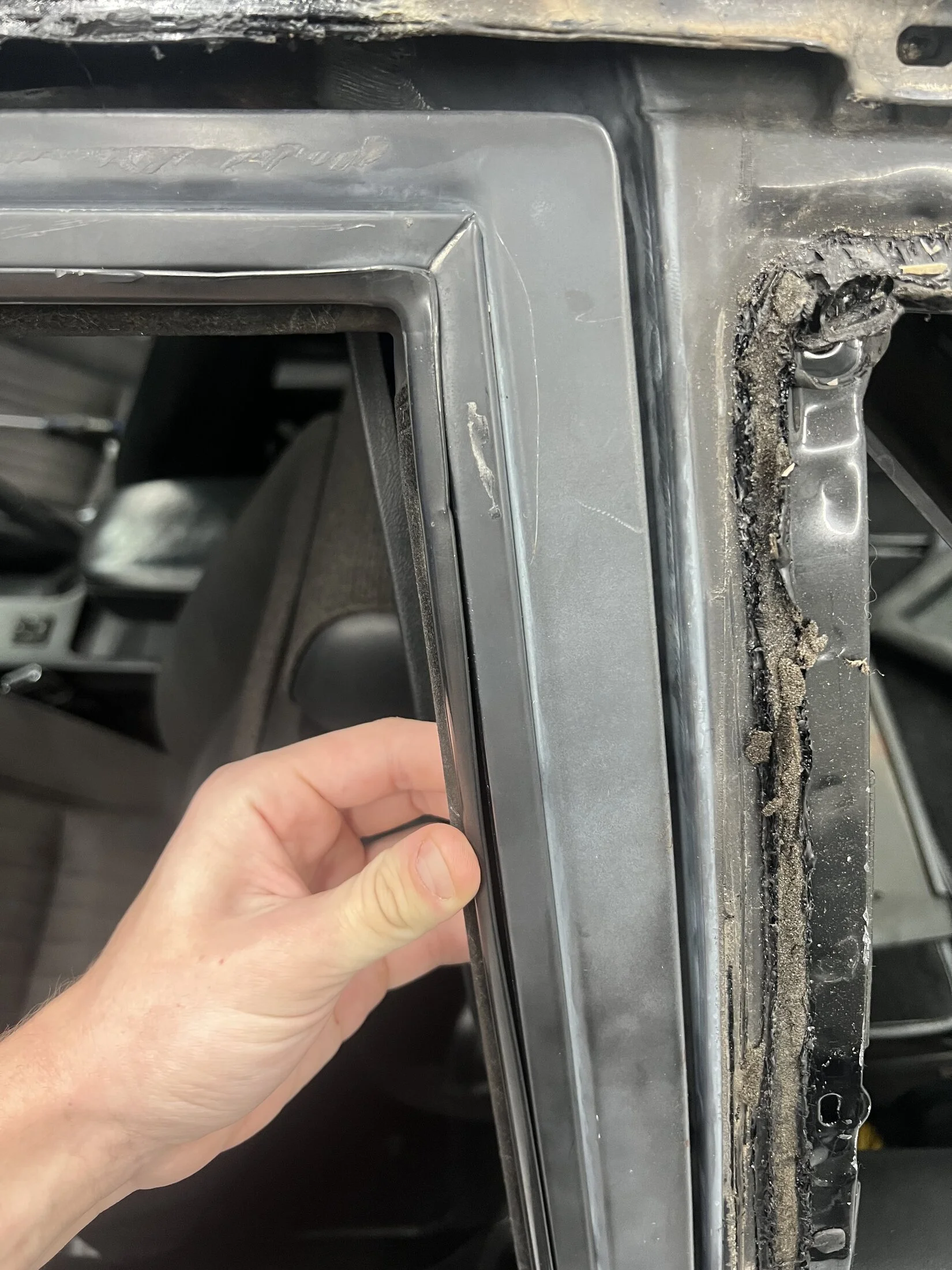

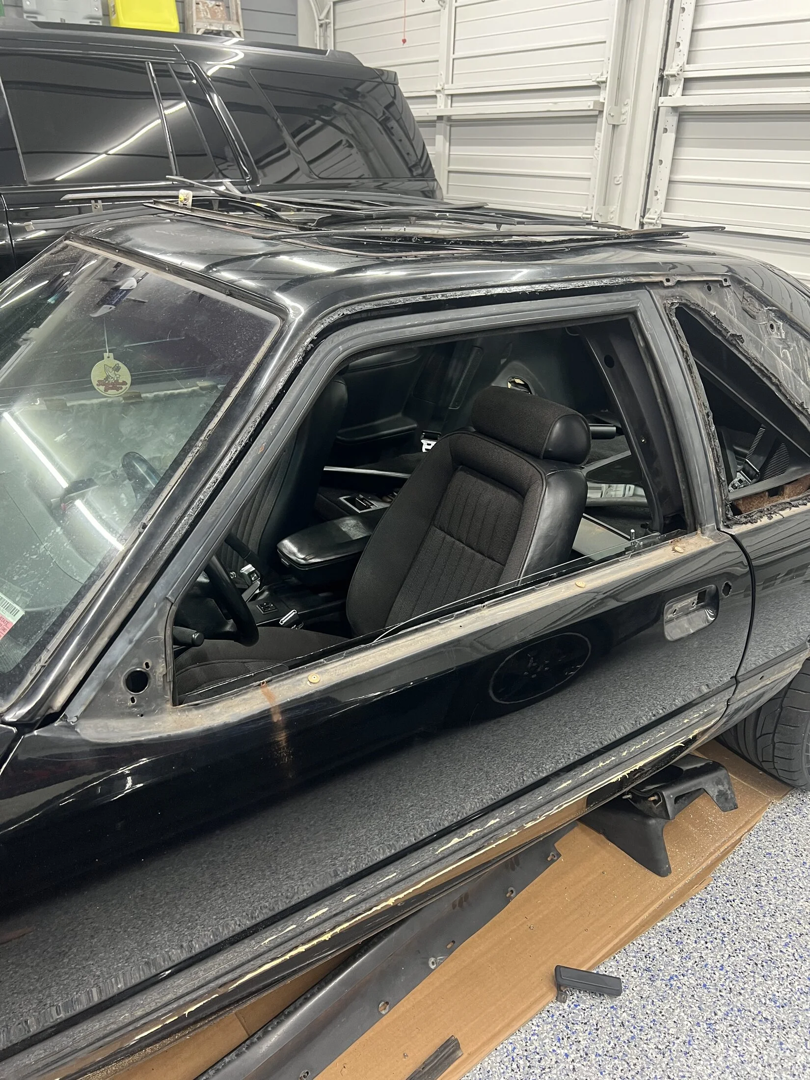

Disassembly has been going good. Pretty much almost done besides the front and rear bumper. I have a few questions regarding the window trim.
First off, is the paint line that my door has on it the correct line where the gloss black should end and the trim black begins?
Another thing, should I take off this rubber on the run channel trim before they paint the trim black over the window trim pieces? Is this easy to remove and reinstall?
Finally, does the trim black need a clear coat? I bought the sem trim black everyone recommends.

Man, I love the way your car came out. Having mine done now and they took it all the way down. I ended up going with Frozen White which comes on the newer Ford GT40 cars.
