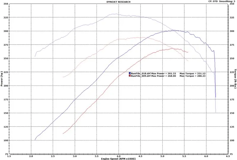

actually no ..only difference in the two dynos was fms caoted shorties w a o/r xpipe(blue)..Vs coated (inside and out) bbk longtubes w o/r hpipe .No change in the tune,hotter the last dyno time,and on the same dyno..
dyno

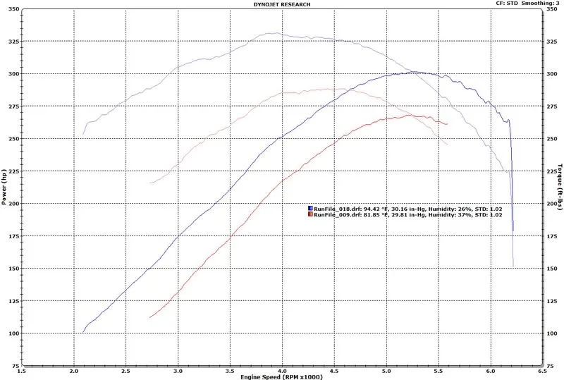

temps:

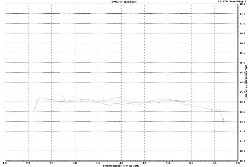

air fuel:
So your telling me that you made 30 more hp and 42 more tq AT THE WHEELS when you switched FROM long tubes and O/R H TO shorties and O/R X!!!! i cant believe that...Sorry
Really dont care what u believe thats the only changes to MY car..Nothing in the tune,no other parts etc.
Been doing this to many years to be worried about being called a bs artiest.
Note it was already a h/c/i car just with shorty exhaust.
Dude I'm confused here...you say the car was already HCI with a shorty exhaust? So are those gains from switching TO longtubes or are they from switching TO Shorties?
I find it hard to believe that everyone in the high performance industry uses long tubes...i wonder why they would do that if the cheaper and easier to instal shorties made more power...substantially more power?:shrug:
