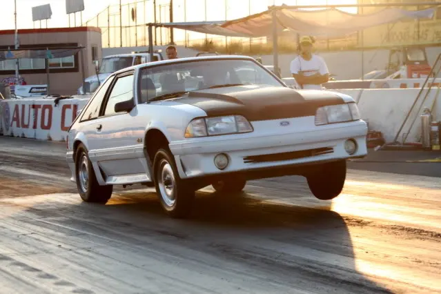

I can tell you that an Explorer motor (heads & intake) with shorty headers, off-road H-pipe, TFS stage 1 cam kit(including spring kit), 24lbs injectors & meter, Prof. Products intake, 65mm T.B., 3.73 rear gear, etcetera dyno's around 250rwhp & 300rwtq on a DynoJet. With slicks & a few suspension parts you can run into the 12's (near sea level) in a full weight '89 GT. The car is very streetable & drives like a stock car. The motor was not rebuilt(roughly 120,000 miles on it before the parts swap). The car I've been describing; my good friend Jammer's car in action....
