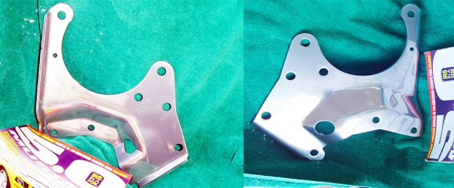

Chrome powdercoat usually sucks. The trick with that is, the piece has to be perfectly flat to begin with otherwise it'll look like a real ****ty job. No offense to anyone who has any of it done, but you just can't compare it to real chrome like they would have you believe. Anyway, I had a bunch of spare AC brackets laying around, so I had them chrome powdercoated so I could sell them and get rid of 'em. And make a few bucks of course :shrug: Here's a pic at how they ended up:
Not bad for coating! Just realize before having anything done that it should be sanded as if you *are* polishing it. Or have the shop do it. Otherwise, like a polish or chrome job, it just won't refract the light right or end up very reflective (possibly miss out on a lot of the shine, too).
