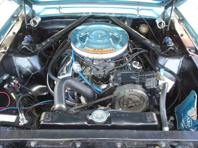

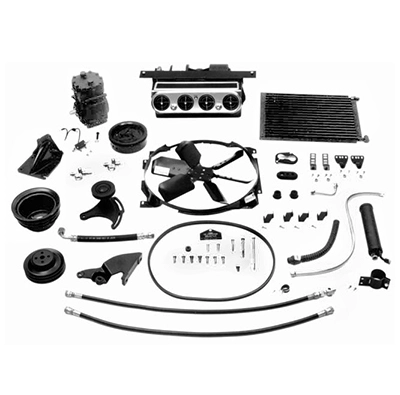

As for the underdash A/C; here's one out of '66 Mustang:
Understand that there are now licensed aftermarket reproductions of this underdash unit from companies like Vintage Air that very faithfully copy the original, right down to the Ford "shield" between the two center registers.

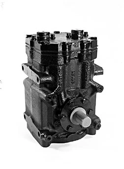

The better clue to originality would be the York/Tecumseh compressor; which looks like a small lawn mower engine:
On cars, the compressor normally is mounted on it's side like this:
Modern repros generally use a Sanden compressor, not the Tecumseh unit.
