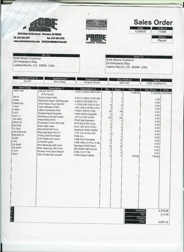

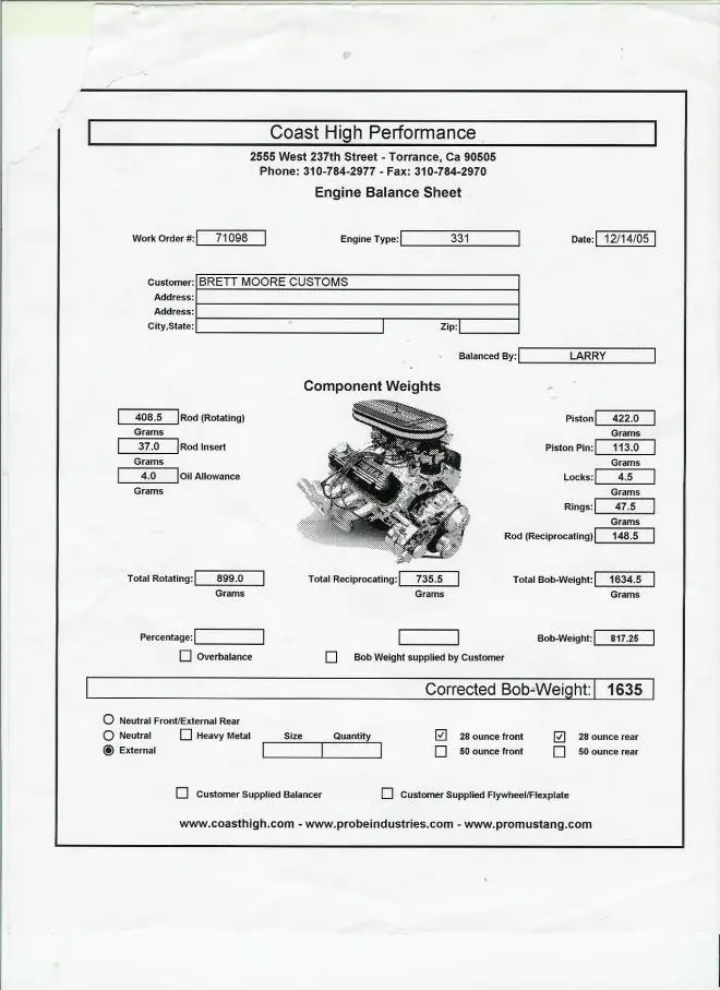

Yes Jay said he 99.9% grinds to the HO firing order unless specified, which I didn't. I did send him the build sheets and the cam tag for him to 'beat.' I attached it here

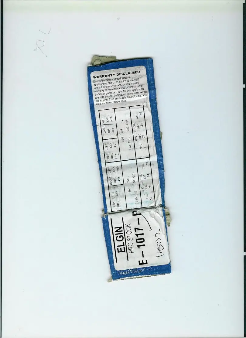

hope it attached. anyway it was an Elgin E1017-P I replaced. (which if anyone wants it, it was installed by coast but removed and never used! make me an offer!)
