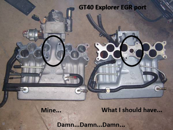

I called a local junk yard they had a '98 explorer that he would sell me the entire intake and heads for 300. In the above it said 94-97 and I searched the other posts and does the '98 have a issue with EGR bolting on? Let me know and I will keep looking or if this is what I should get for a semi budget build. I will have it all ported and polished.

  • May 10, 2011
  • #13
late-97 intake does NOT have EGR.
96 and early 97 do have the EGR.
