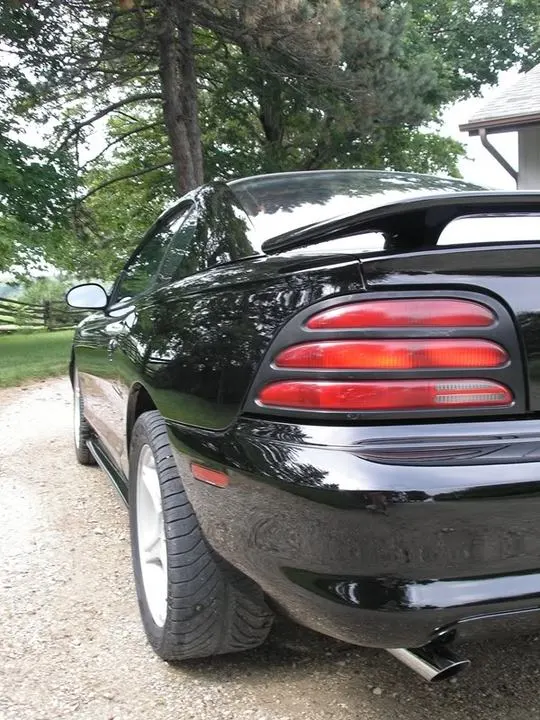

I ran 275/40/17s on both 2000 GT rims and the original tribars. I think the bulge looks sexy though.

I ran 275's on all 4 of my original tribars and it looked good but the handling went down a bit due to the sidewall angle. The installer also had a hard time mounting them. 255's are a much better fit for the stockers.
