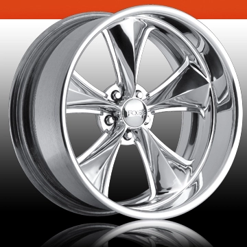

These are a little on the more expensive side: (Foose Nitrous IIs they also come without the rivets)

my dad suggested the same foose rims, im trying to stay away from rims with the fake rivets tho because i have those on my monte and they are a bitch to clean! how do gt40s look on 65's they look perfect on the black fox bodies, off all those i like the chrome bullits the best

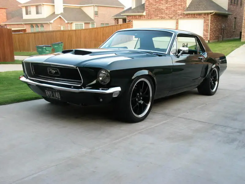

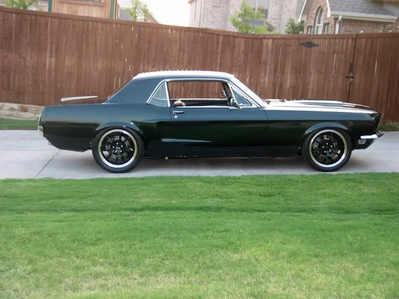

Also...I can't seem to be able to find the thread were the guy with the green mustang (above) posted a bunch of pics. That has to be of the the cleanest 68's ever. I just wanted to see a side shot with those wheels. If I remember right he had to seriously modify the front wheels (cut them and narrow them) to make those GT10's work.

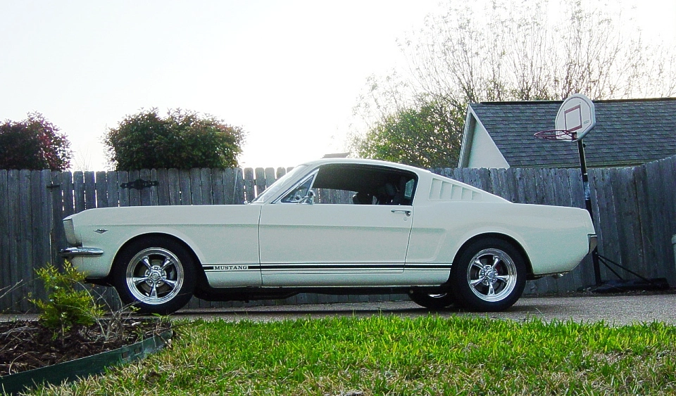

I think those are FR500's on that green car. If not then they're Raceline GT's, like I put on my '65:
Here's another pic: http://www.mustangmods.com/data/9461/ride_height_5305.jpg
These rims 17 x 8, 5.0 BS with 235/45-17 tires. I needed to use a 7/32" spacer on the fronts, to clear the upper ball joint. I'd go with the 5.0" BS, because you can always subtract BS with a spacer; adding BS is just about impossible.
I think 235/45-17 is about as big as you can go up front with a '65-'66. My fender lips are rolled and I had to cut a section out of the pinch weld on the passenger side for clearance.
Are you taking of this guy:
I couldn't find the thread either, but I had those pics here in my laptop.
