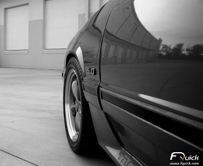

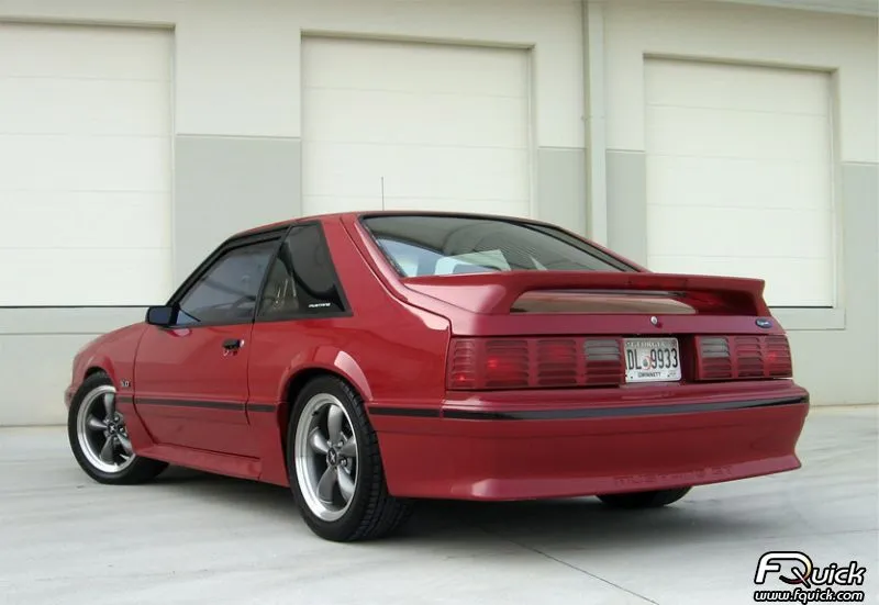

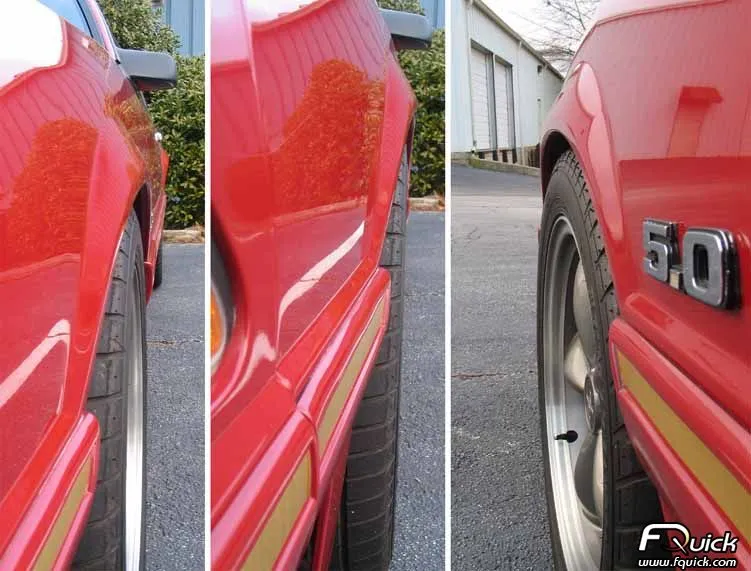

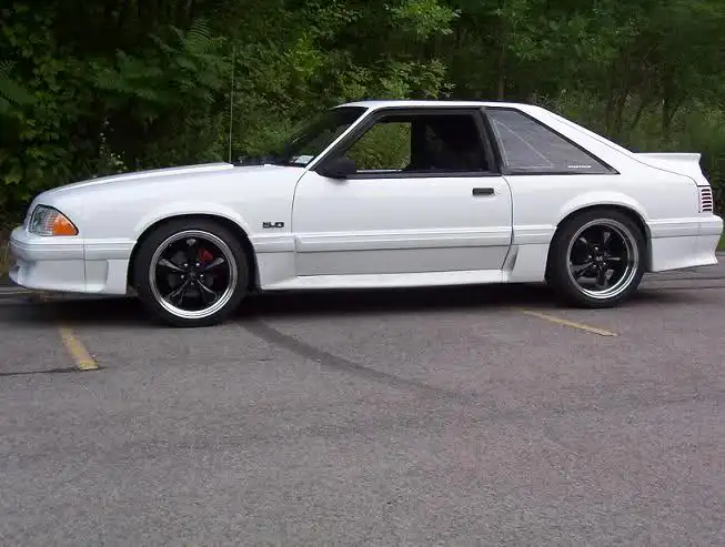

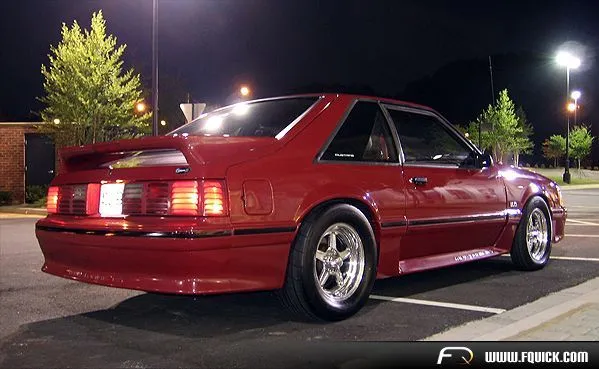

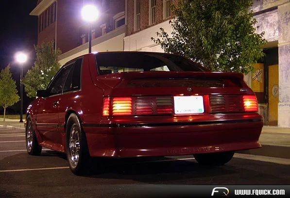

I guess I will start things off,
Black Bullits
18x9's
5.95 backspacing
24MM offset
Falken FK 452 255/35/18 (run narrow)
Falken FK 452 275/35/18
No Fender Lip rolling
No Inner wheel massaging
Removed Quad shocks
Removed Tailpipes
Fox Length 5-lug axles
SN-95 Spindles

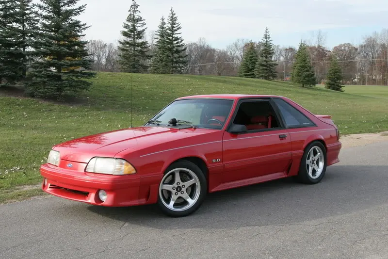

I will get the right pictures soon, but for now this is what others have taken...
Wheel Name: Anthracite Bullitts
Wheel Size: 18x9 / 10
Back Spacing: N/A
Offset: 24mm / 22mm
Spacer Size and brand (if used): None
Tire Brand: Falken FK 452
Tire Size: 255/35/18, 285/35/18
Fender lip rolling (Yes / No): Yes
Inner wheel well massaging (Yes / No): No
NEW PICS!!
Backs
Fronts

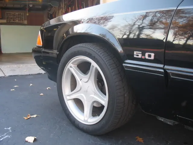

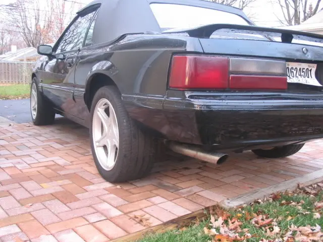

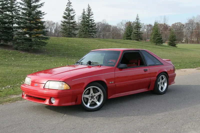

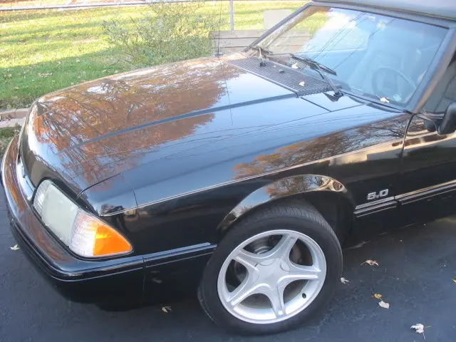

Not as Big But

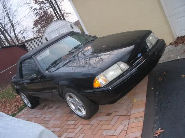

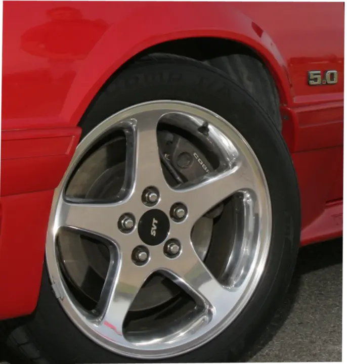

Wheel Name: Kewbra SVT
Wheel Size: 17x8
Back Spacing: N/A
Offset: None
Tire Brand: Kumho ASX
Tire Size: (Rear) 275 40 17" (Front) 235 30 17"
Fender lip rolling: (Yes)
Inner wheel well massaging: (No)
Front Left Wheel (Old Comp T/A Tire)
All i have For Now. i Will Edit this Post And Put in The rest of Required Pics..

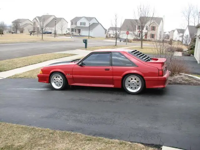

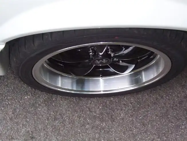

18X8.5 Draglite XP's with 4.5" BS
Capital Negotiator Tires
245/40/18 front
275/35/18 rear
No mesagging at all necessary.
No pics of how the rear wheel sits in the wheel well, but it is in just enough so that the wheel doesn't rub the fender.
Oh and by the way Eibach prokit with ES islolators.

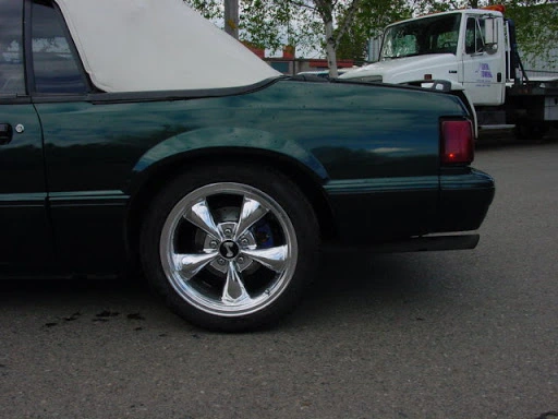

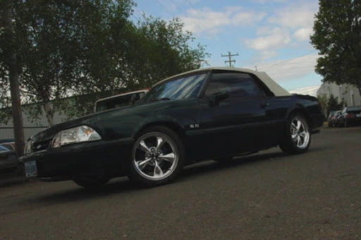

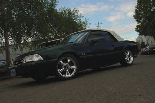

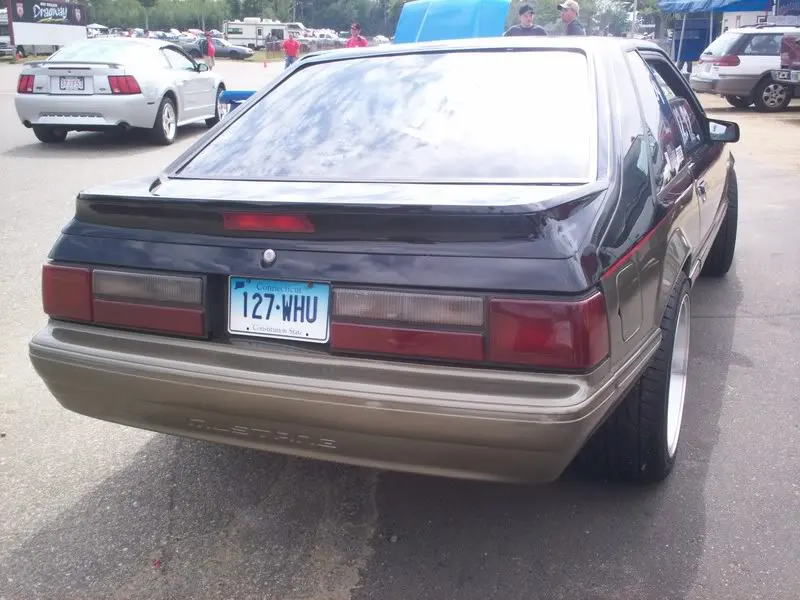

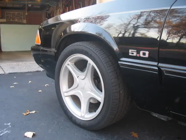

17x8 01 bullit replicas
Can't remember offset but I think it's 29mm
sn95 front spindles / ranger rear axles
Eibach Pro-kit 1.5 lowering springs
Pirelli 235/45/17
No Spacers
No fender mods
No rubbing

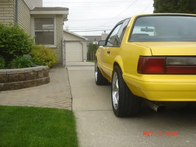

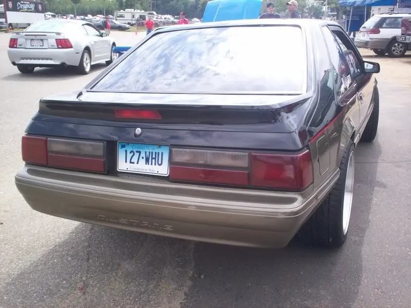

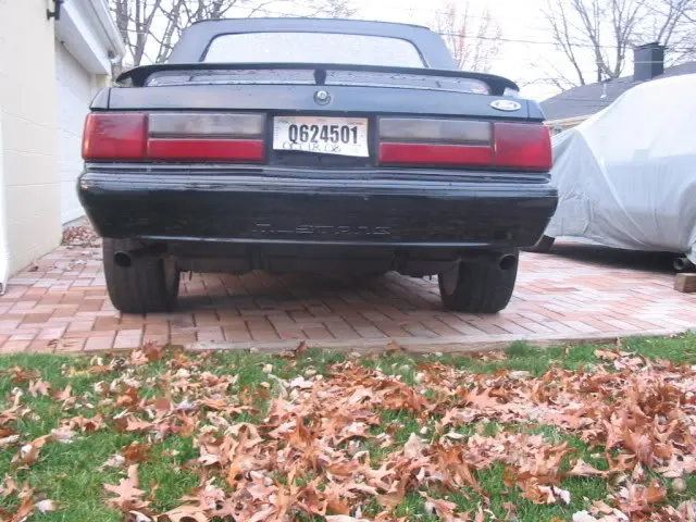

15X8 Rear w/5.5 bs
15X6 Front w/3.5 bs
195-65-15 kumho's up front
235-60-15 cooper's out back
[/IMG]
Will get some better pics from more angles soon.

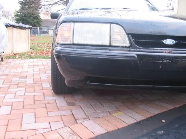

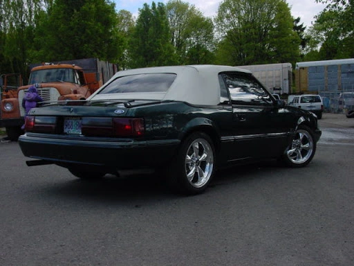

Front: 96-04 spindles. 17X8 Bullit's +30mm offset.
Backspace: 5.72"
Fender lip rolling: NO
79-90 fenders with LX moldings and they do NOT rub.
Tires: 245-45-ZR17
Do they stick out?: NO
Rear: 1999-2004 solid axle. 17X9 Bullits with +45mm offset.
Backspace: 6.8"
Fender lip rolling: YES
Wheel Well massaging: NO
Tires: 285-40-R17 F1's
Do they bottom out?: NO
PICS:
Reactions: 89Daley

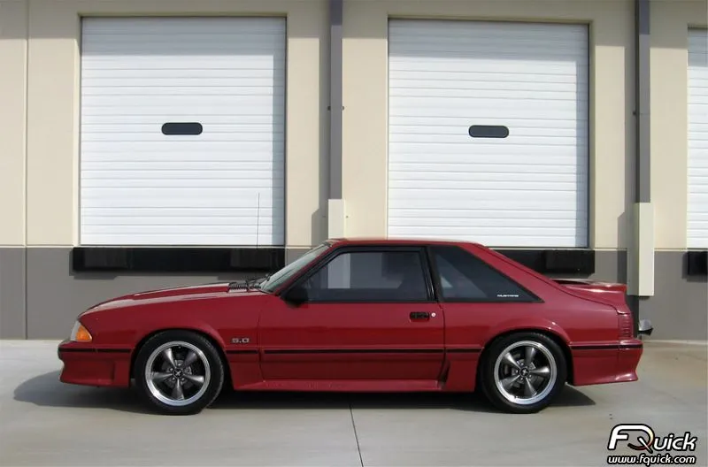

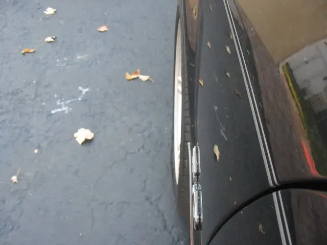

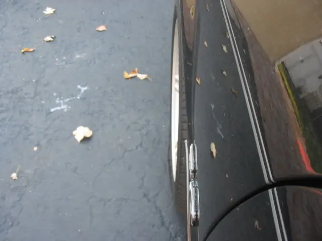

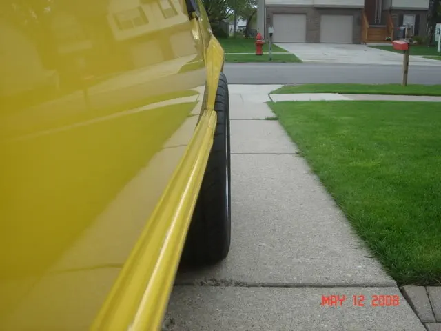

Hi i just bought a new 93' 5.0 GT and i want to do a 17x9 front and 17x10.5 in the rear but i wanna make sure that they are going to work. I am worried about the clearance of the shock that is welded to the axel rubbing. Can someone help me out i am looking at the Cobra "R" deep dish rims. thanks
...I think I'd categorize this as "Sticking Out"??? I have a 1.5 - 1.7" drop on my 88 GT using the Sportline Eibachs and if I had those mounted on the back of my car - the first hard turn I'd take the fender would be laying down on the tire.
I niticed a couple guys mentioning which spindles the are using and that can make a big difference on fitment up front as well as figuring out what offset or B.S. would be needed.
John
1988 Mustang GT 5 Speed
Backspace: 5.72"
Tires: 245-45-ZR17
Rear: New 1986-93 Rear solid axle. 17X8 Bullit's +30mm offset.
North Race Cars Fox-Length Rear Axle Kit
Backspace: 5.72"
Fender lip rolling: Not yet, No
Tires: 245-45-ZR17
Driving Notes: The front tires have just a tiny, and I mean very tiny small scrub under hard corners or a large dip or bump in the road. Again I have my car lowered pretty good but I also have not installed the new adjustable AGX struts and shocks yet - soon though. This will stiffen up the suspension and control the suspension travel to be much tighter which is what i want. This should eliminate the minimal scrub. I'm being very picky here.
I also recommend that if you run a 9" or 10" wide wheel with a 275 width or higher tire out back that you purchase some aftermarket upper and lower control arms to tighten up the rear suspension. Most 5.0s stock control arms are sloppy at best with a 20 year old suspension. This will also allow you to ditch the quads.
I also installed thye Eibach front and rear sway bar kit which is real nice and helped further tune a good handling tight suspension. Just some things to think about.
Another direction that I urge 5.0 guys to take is using the 86-93 8.8 rear (not an SN95) if you want to run wider tires out back. Use the North Race Cars Fox-Length Kit which includes fox-length axles, custom laser cut brackets, and new e-brake cables.

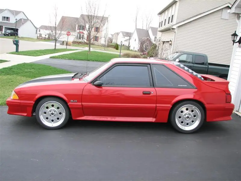

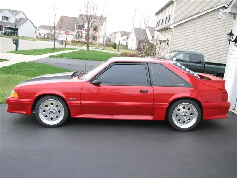

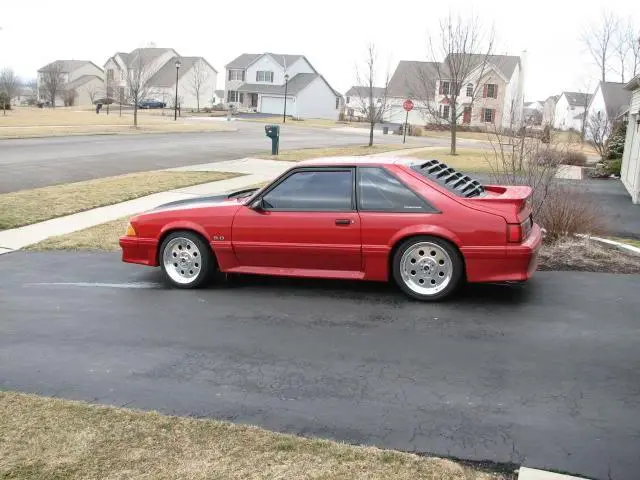

Here's the New Billet Specialties Street Lite Drag Wheels on my 88 GT.
Front: 96-04 spindles. 15x3.5 Billet Specialties Street Lites
Backspace: 1.75 B.S. (with 7/16" spacers in the front only to clear the calipers)
- For a little more clearance inside the wheel well, you could opt for the 94-95 spindles to move the wheels in about 3/8" each side, then go with a 1/2" or 9/16" wheel spacer and have a little more clearance without having to modify the caliper bracket.)
Tires: 165/80-15 Kumho Powerstar 758
Do they stick out?: NO - just tuck inside.
Rear: New 1986-93 Rear solid axle. 15x8 Billet Specialties Street Lites
Backspace: 5.50"
Fender lip rolling: Not yet, I will just to make sure but these don't seem to rub either - surprisingly!
Tires: 275/50-15 Nitto Drag Radials
Do they stick out?: NO - Just tuck inside the lip!
J

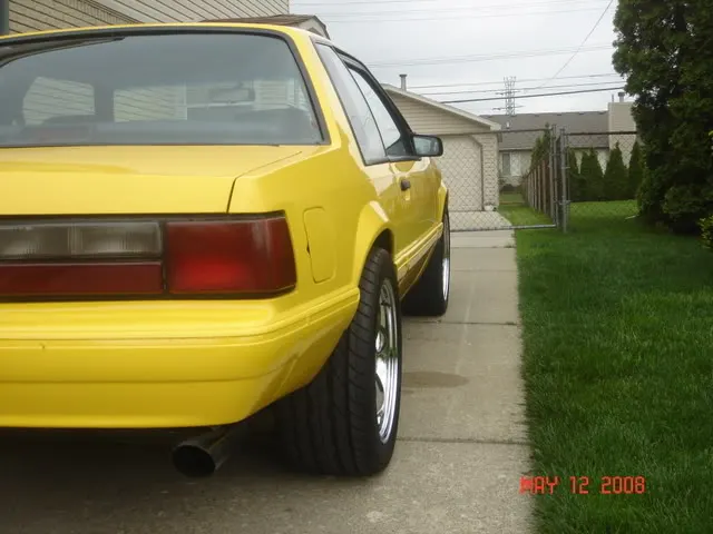

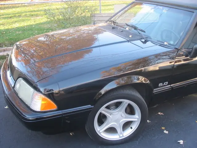

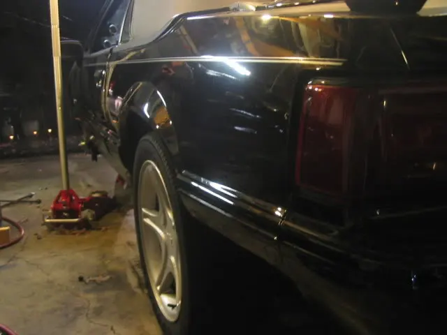

Ranger axles/drums Mark VII Rotors
Wheel Name= 1999 Mustang GT Pony Wheels
Wheel Size= 17"
Back Spacing= stock
Offset= stock
Spacer Size and brand= 1/4 spacers on front. unknow brand
Tire Brand=
Tire Size= Rears. 245/45/17 Fronts 235/45/17
Fender lip rolling= No
Inner wheel well massaging= No
ill get better pics tonight.

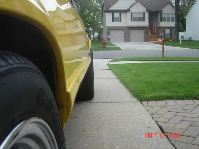

i just picked up 03 cobra calipers and spindles with raybestos 13"rotors i also just bought 03 original cobra wheels .i will be doing a five lug conversion but i am curious any issues that i need to be aware of as far as spindles go are they the same from 94-04?what size tires can i go with that won't require me to roll the lips in the back?

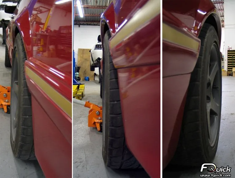

ohn
That's a negative. The pic is decieving. They did not stick out. A straight edge proved it.
