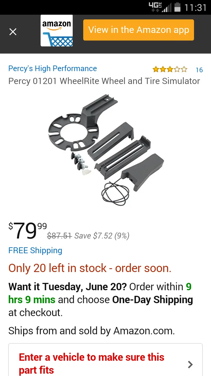

Order a Percy wheelrite and never have to ask again....
I've got one and it really comes in handy. The bendable wire they send to simulate tires is bs. It doesn't actually do tire measurements but it does do bbackspacing, rim size, and offset. Measuring for tires takes a ruler and bending the wire accord ing to actual tire specs.
