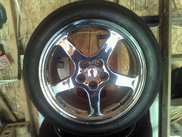

New to the forums so sorry in advance if I commit any offenses. So here's my dilemma. My father-in-law (auto-mechanic with his own shop) knows I've been looking for some new rims and wheels for my 1995 GT. Originally it came with the premium 17x8 double 3 spokes. Well, he found a set of 4 Rousch 18x10's with some decent tires on them for $200 and was so stoked he just picked them up for me on the spot. Trouble is, they came off of a 2006 and on my 1995 they're rubbing on the rear shocks and the front strut tower. And before anybody starts giving helpful hints, we've already flipped the rear quad shocks and tried adding 1/4" of spacers just to see if that would work. With the 1/4 spacer the rear's would work (just barely) but the front still rubs on the strut tower.

18x10's for the front? Too wide brother. Great for the rear though. Not a total loss, sell two of them to help pay for some narrower ones for the front.

Ok, on to the next question. Anybody have any advice on good forums to try and swap 2 of the 18x10's for 2 18x9's of the same style?

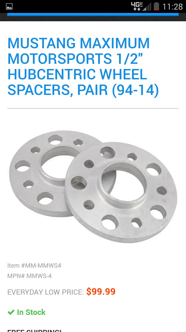

I wouldn't recommend spacers that aren't hub centric...they should have a lip that the rim sits on if they're thicker than 8mm.

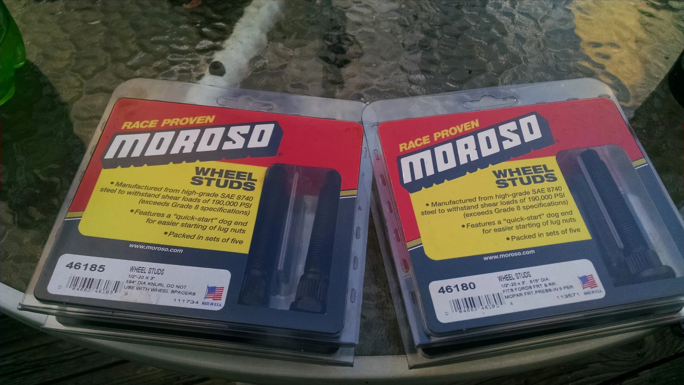

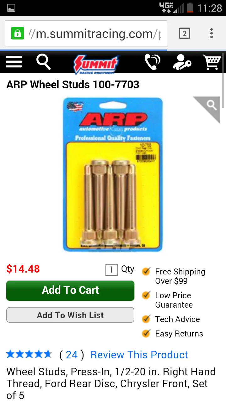

Quick question with those bolt studs, from what I was seeing online, those were for the rear. When I looked for front studs, the ones I was finding were $67 for a single set of 5. Is there a reason the fronts are so much more expensive? Or am I just looking in the wrong place/being duped?
Thanks again!
You're being duped... I can't remember where I bought mine from but they were less than that. There's no real reason for the difference in prices. Get the part numbers and do a google search.
The front studs are designed a little different. The gold zinc ones are more expensive than the oxide black ones. Mine are all black.
These are my part numbers and pics of studs. They should be the exact same that you need for your car.

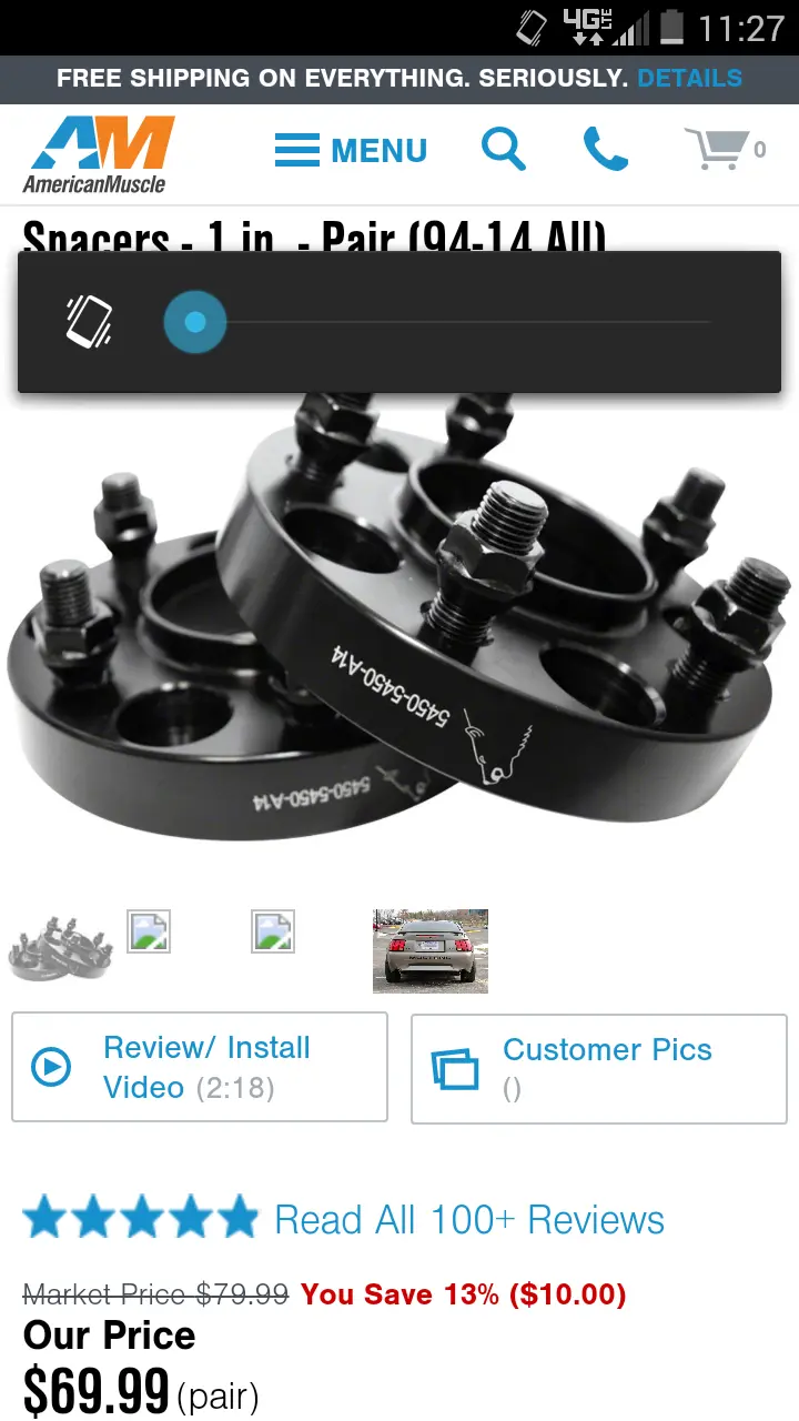

There's a notice that says " do not use with wheel spacers " one set of studs. I did some research on the interwebs and chose to ignore this. The other studs don't have the warning. If you're going to go bigger than 1/2 inch I'd recommend getting the spacer adapters that have their own studs.
